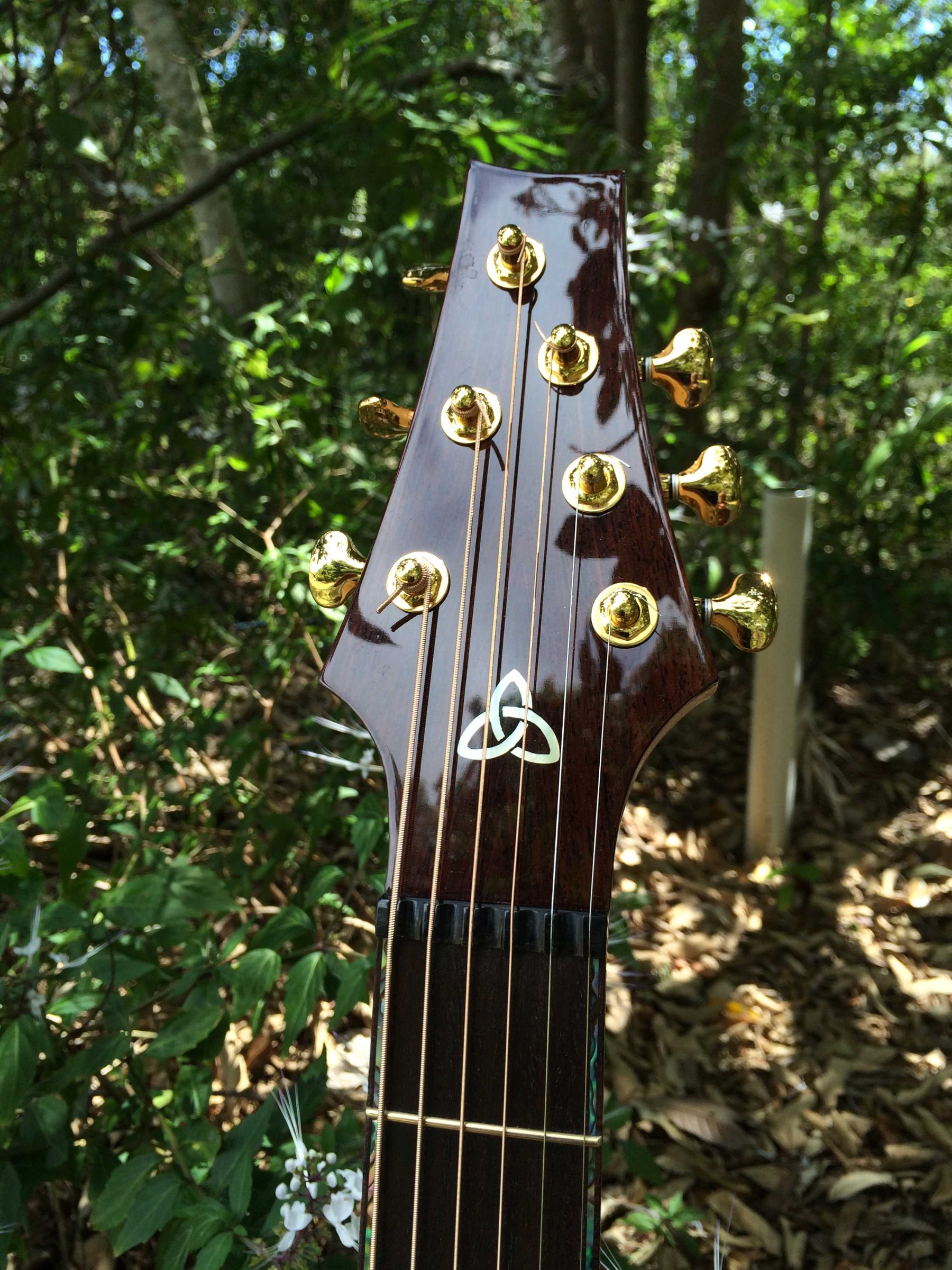

Headstock overlay, Bindings, Fretboard and Bridge - Central Queensland Purple Bauhina

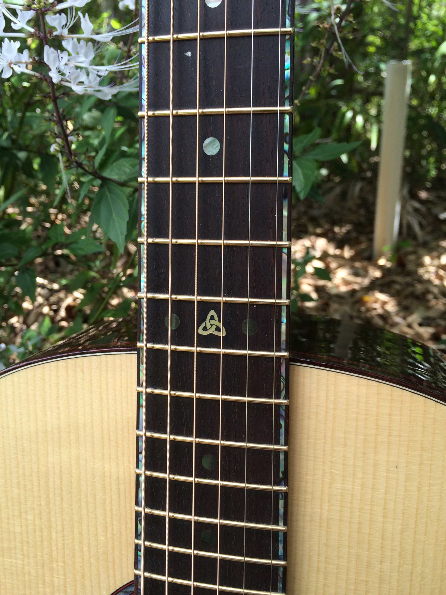

Gold Mother of Pearl Triquetra inlays on Fretboard and Headstock

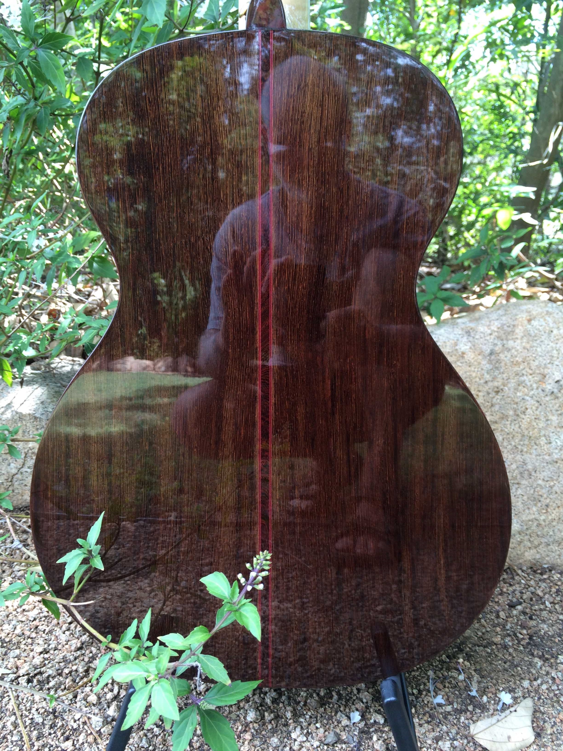

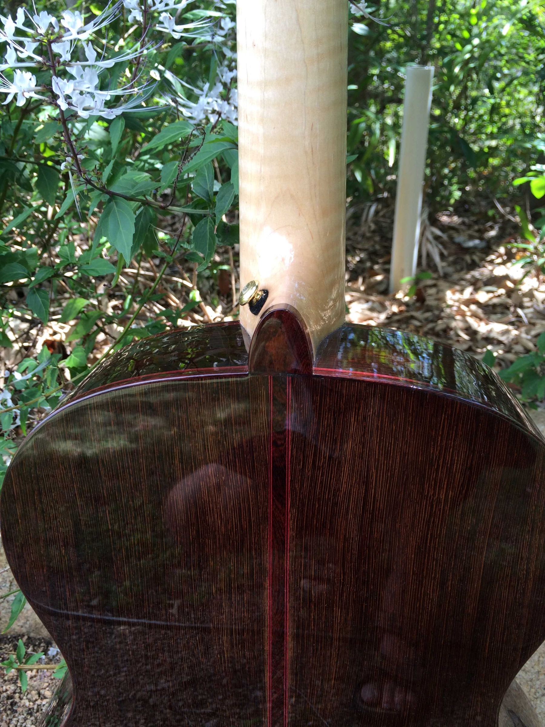

Wenge Back & Sides, mirror Nitro Cellulous finish

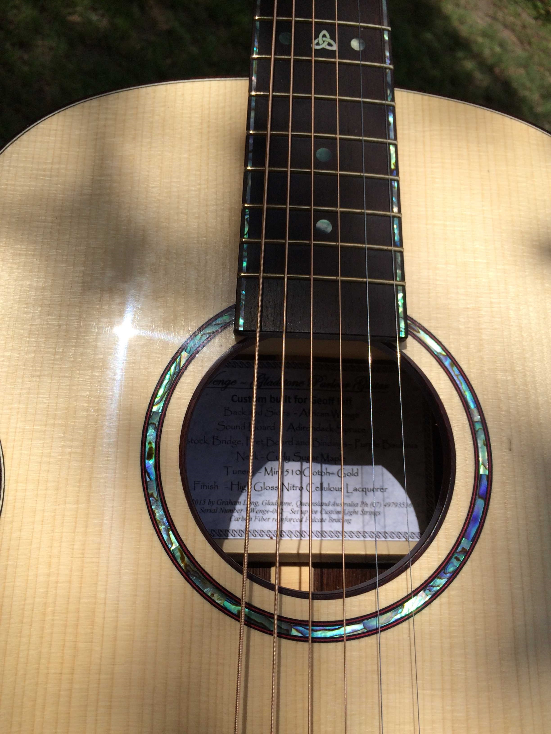

Paua Rosette with Black/red/black purfling
Purple Bauhinia Fretboard, Evo Gold Fretwire
Curly Maple Neck, Purple Bauhinia Bindings, Backstrip & Heel Cap
Gotoh Mini 510 Tuners
Adirondack Soundboard, Paua Rosette and Fretboard purfling
