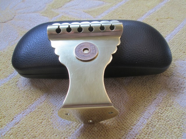

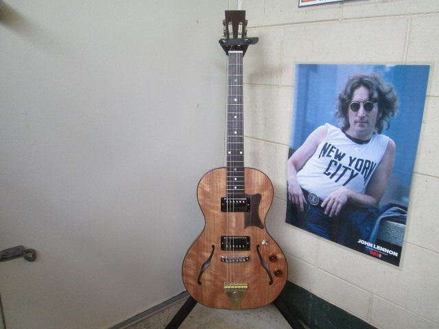

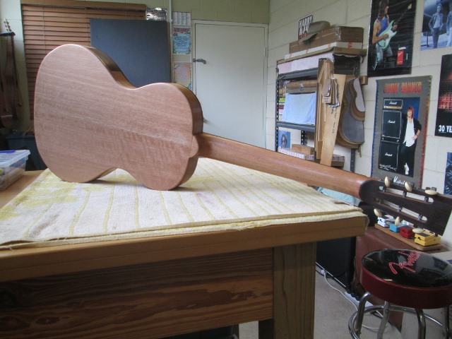

This guitar is a Les Paul style electric, f holes and chambered body with a tunomatic bridge, Indian Rosewood appointments and a home made brass tailpiece. The headstock is slotted and the guitar is nice and light in weight. This one is my second attempt as the first was a proto type and there where a few mistakes. The main issue was the neck set was wrong. So I cut the neck out of number one as the neck was good and made another body. Second time it has turned out ok and after a lot of tweaking it is a good sounding guitar. Pickups are Stew Mac Parsons Street humbuckers and the tailpiece is made from some 2 mm thick brass. The coin glued on the tailpiece is something that was given to me by an exchange student from Japan who studied her final high school year 12 at Ballarat College 1980s. While studying in Ballarat she wanted to learn guitar and her English was limited so I took on the job and found she was a joy to teach although we had to use many hand signals. Sumi gave me the Japanese coin with a hole in it which is a Japanese custom as a mark of respect. I really like this new guitar so the coin has pride of place on the tailpiece. Thanks for looking. Cheers

Very nice Alan, the tail piece looks great, a bit of work in that I'm guessing.

Thanks Wayne. The tailpiece was tricky however more time consuming than anything else.
A mould was made for the radius so that part is easy now.
The guitar was built from the LesPaul single cutaway plan with chambered body, f holes and the brass tailpiece. Many of the 1950s Les Pauls had a brass Trapeze tailpiece.

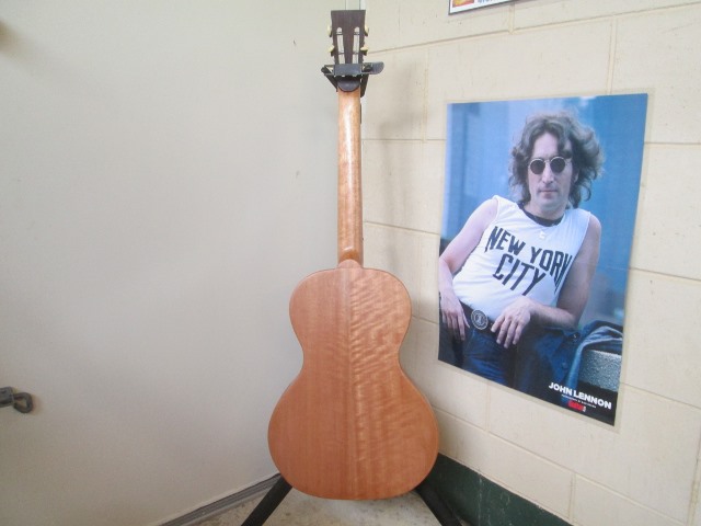

Very classy Allan, a nice piece of work. What timber did you use for the back and sides?

G'day Bruce,
Thanks for your comments mate. The back neck an sides are all Queensland Maple.
The top was a 5 mm figured Queensland Maple set from Malaney, Qld.

Very nice Alan, and great work on the tail piece.

Hello Mark,
Thanks for the comments.
As I expected it adds it's own flavour to the tone of the guitar.

Lovely looking guitar, Alan, very classy.

Also Alan, what is the finish on this instrument?

Thanks for your comments Peter.
I will send the email off again to you.
The finish is hand rubbed shellac. I have a method I have ben improving over the years it is not a full shinny finish more satin.

Interesting timber look with individual styling. You must have taken lots of care to achieve this result.

Thanks for your comments Wayne.
My first effort was a disaster as I got the neck set all wrong and a few other issues.
So I cut the neck out of the first body and tried again.
Learnt lots from the first build and went to School on my mistakes while building the second body.

Nice Alan, adding a bit of metal work makes a nice change from woodwork.
