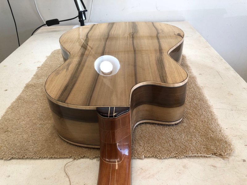

I have finally finished No.4.

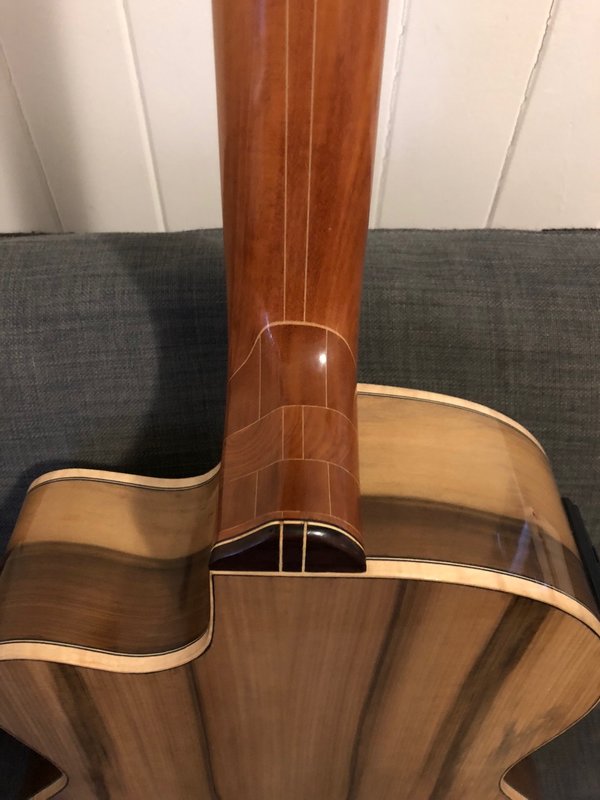

Lutz spruce (thanks Martin Kiwigeo), blackheart sassafras (thanks Bobthebuilder), mahogany neck, IRW fretboard, wenge bridge, flamed maple binding and arm bevel. It is full BOBO neck (using Strato's bolt-on Spanish heel), compound radius fretboard with EVO frets, MOP 12 fret inlay, compensated nut and a hard shellac French polish.

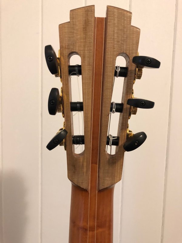

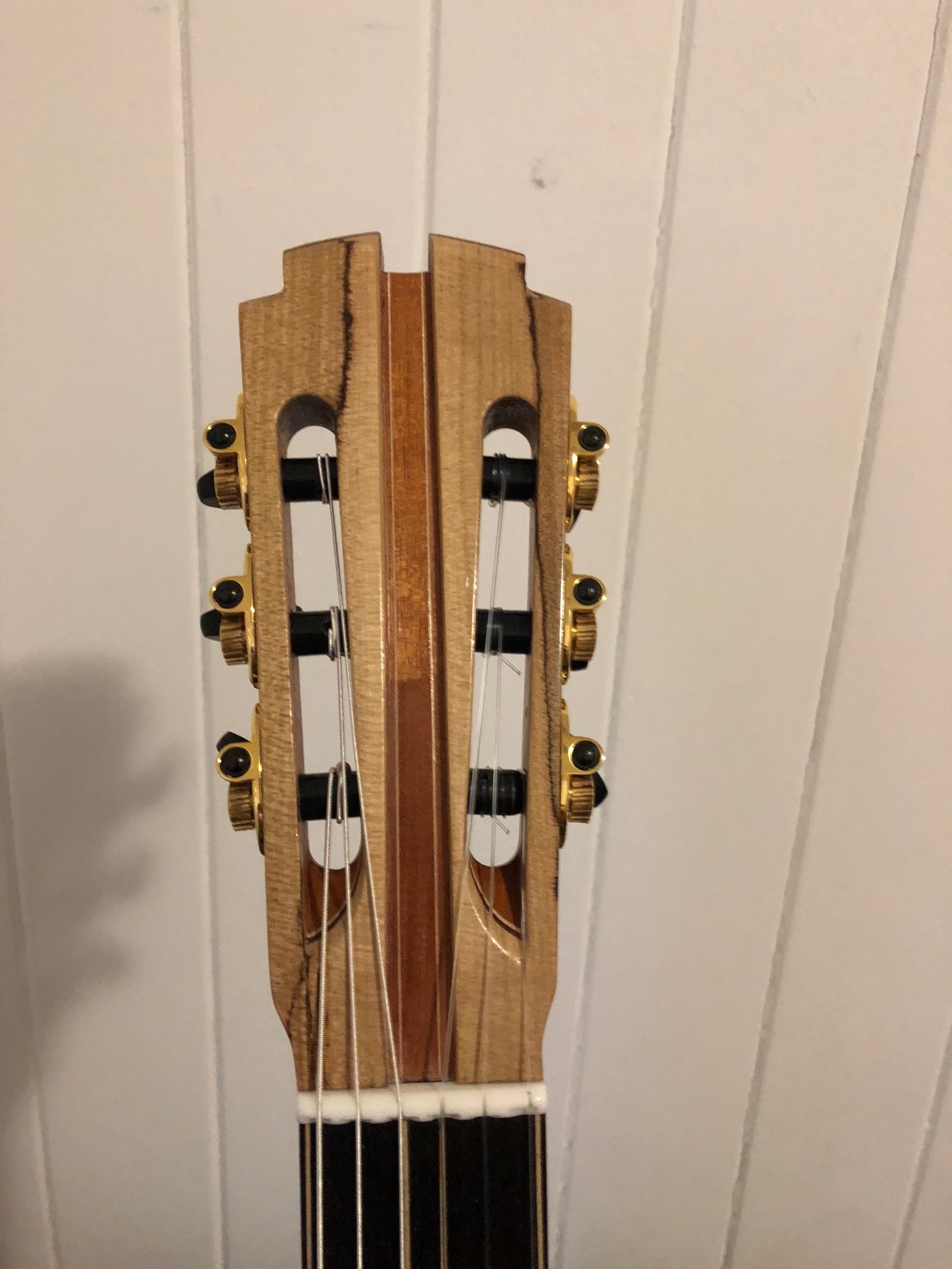

AWESOME! The French polish looks as deep as the Pacific ocean, love the segmented heel & deco slotted head!!

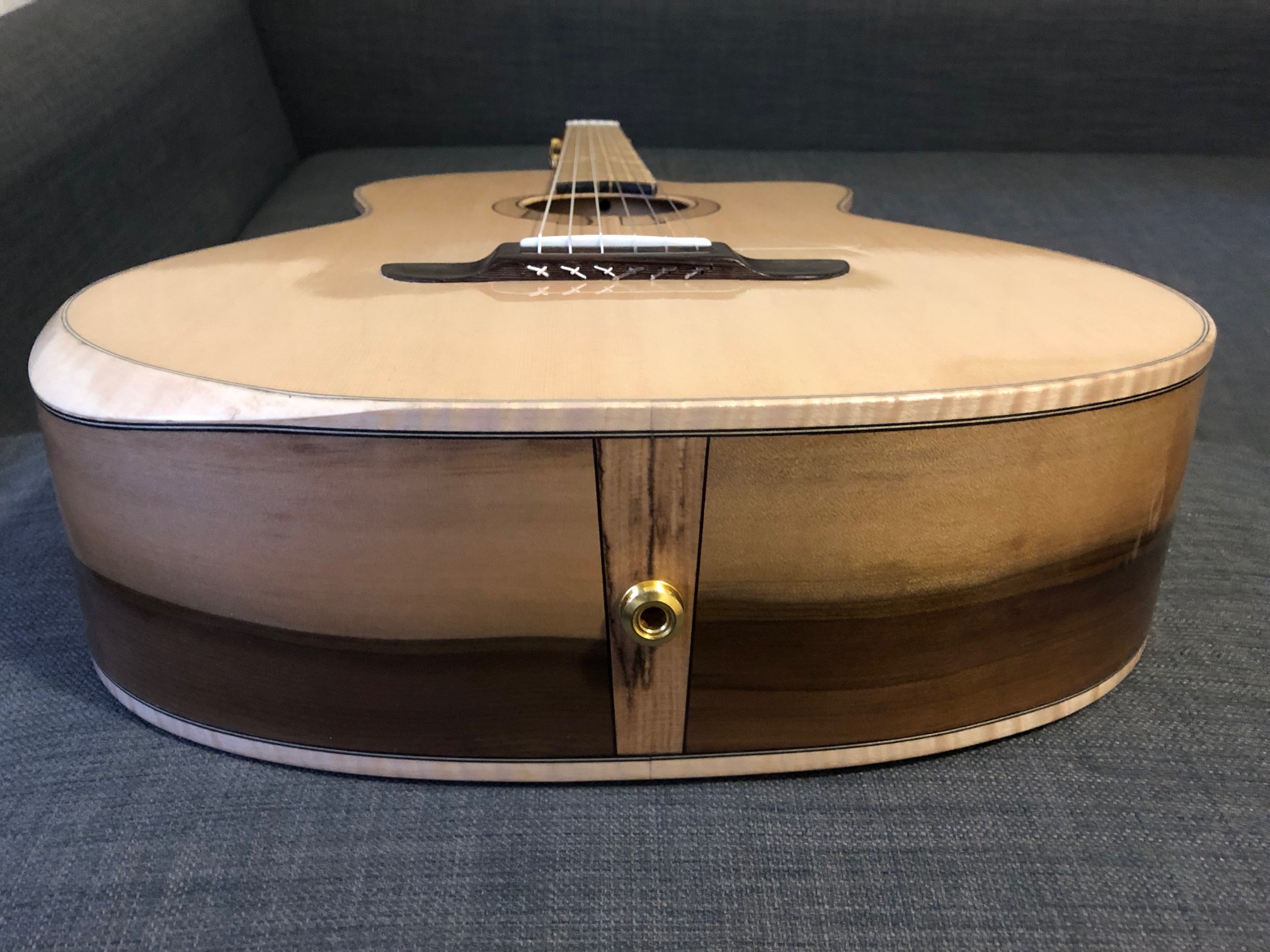

Trent, I like the design and shape of the neck. The purfling lines add a nice class to the guitar and the flamed maple bindings and arm bevel looks elegant.

Wow.....that's a magnificent guitar Trent, absolutely stunning.

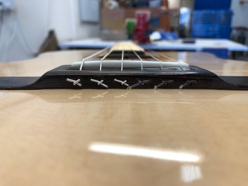

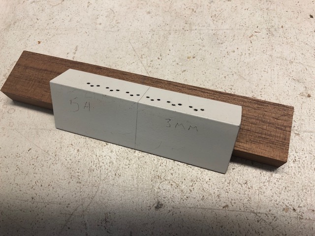

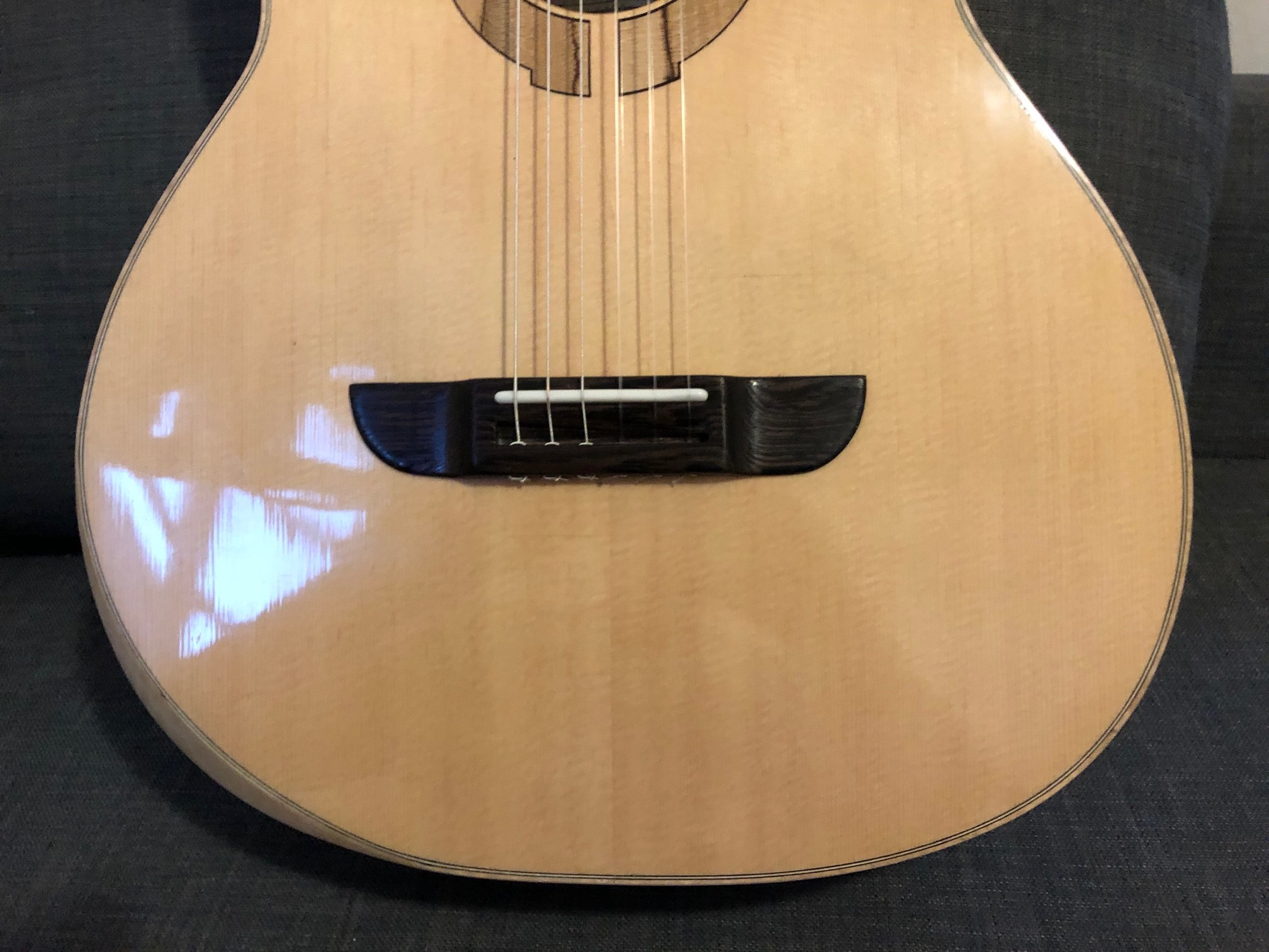

Well done with the 18 hole bridge. It creates such a clean look and good function. When I tried it once I got a good functional outcome, but mine doesn't bear close inspection of the regularity of the hole placement. Did you develop any good tricks or jigs for this?
And how about the arm bevel method? I am gearing up to attempt my first soon, and have the Kent Everett DVD as a guide. Is yours a veneer surface, or a solid piece of maple? Any tips?

Trent great detailing. I imagine that scooping of the heel is to further improve access to the upper frets...?
I pretty much made an aluminium template as per Trevor method in his book. I'll take a pic and post it when I am back in the workshop. As for the arm bevel, I pretty much followed Kent's DVD with veneer over a substrate. The additional things I would recommend is instead of an additional black veneer he suggests, I recommend using a couple of strips the same veneer you are intending to use over top of it. Also, I don't think Ken mentions grain orientation of his substrate, but on the Paulownia I used the end grain wasn't the best surface to work with, crumbling under a rasp etc. Oh, ironing the veneer on work so well, you can hardly believe it.
I think the improvement is probably only psychological, but I really enjoyed carving it and will probably do it again with some more and crisper curves.

Post by lamanoditrento » Fri Sep 07, 2018 11:03 am
18 hole bridge drilling jig

OK, that looks straight forward enough. Do you drill into a solid blank and then route out the middle, or route before you drill?
Re: Lutz/Blackheart Sass Hybrid Nylon, venetian cutawy & arm bevel
Post by lamanoditrento » Mon Sep 10, 2018 1:00 pm
Drill using a depth stop, then rout the channel to expose the holes. That way you avoid any breakout from drilling the holes

Trent did you make any modifications to the bridge design after you failures? I notice the "valley" between the tie block and the saddle ramp doesn't extend all the way across the bridge top.
Yes the 2nd bridge really threw me and had me thinking hard about making sure the 3rd one stuck. The 1st one failed along the lamination between the IRW and the CF along the epoxy join. The second one the HHG didn't stick to the IRW (despite careful acetone cleaning to remove oil) and cracked along the string ramp slot. So I became a little conservative and made both the saddle slot and string ramp slot blind and glued with titebond. I also inlayed a new piece of spruce so the 3rd bridge had a pristine surface to glue to. 2 bridge removals being a bridge too far for the poor spruce underneath.
