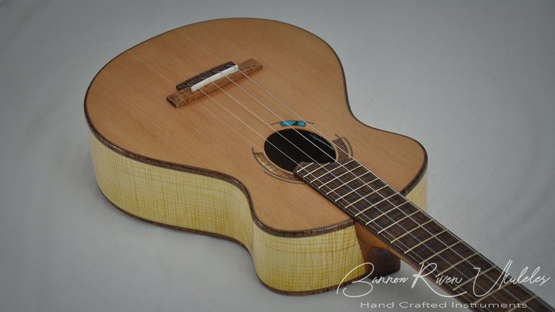

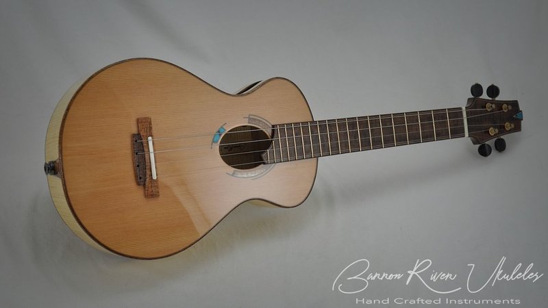

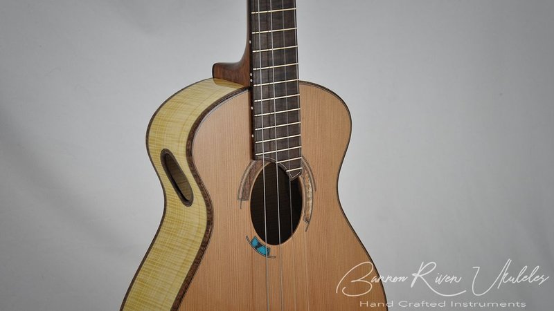

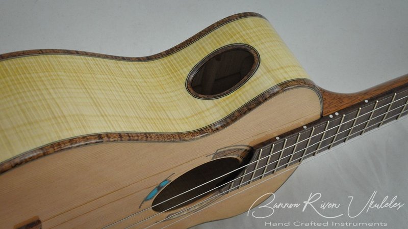

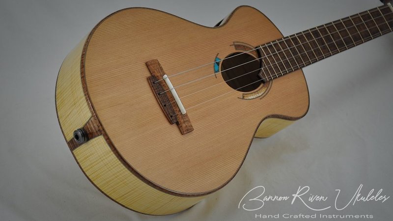

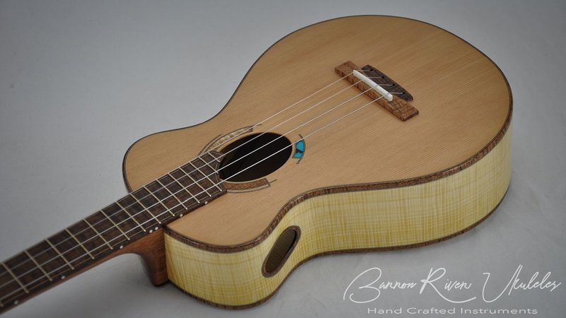

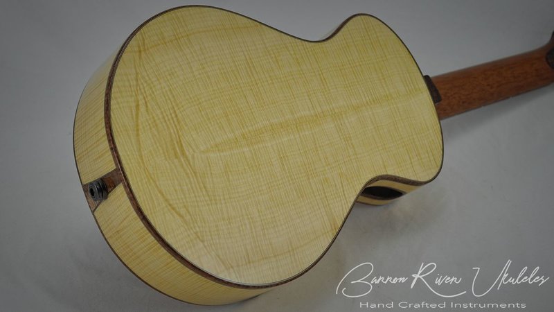

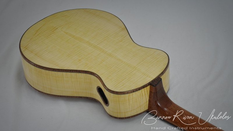

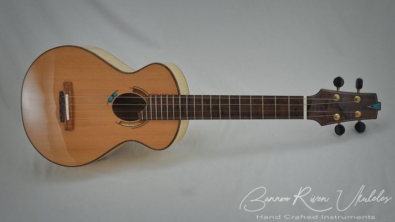

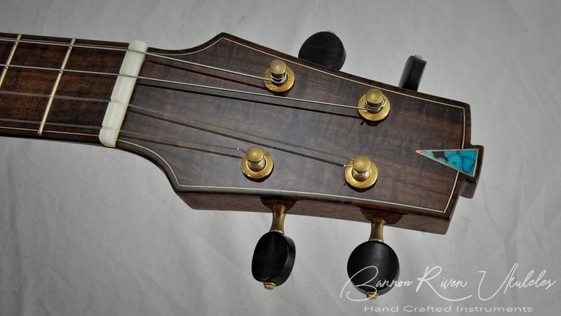

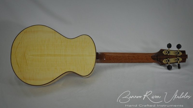

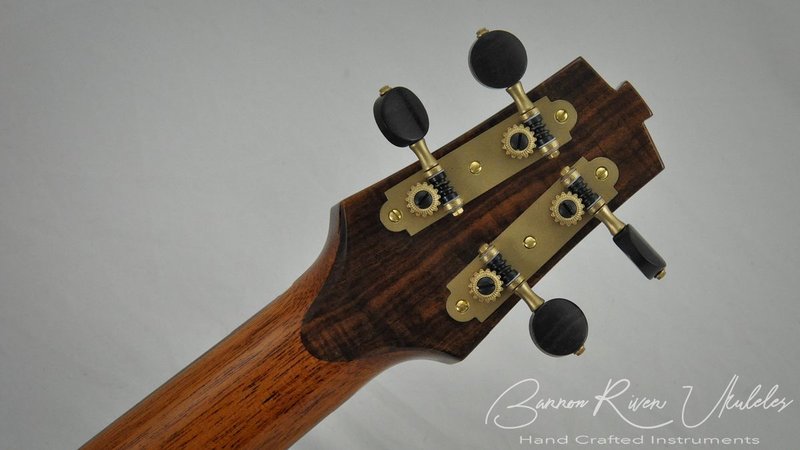

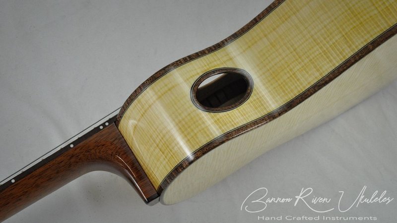

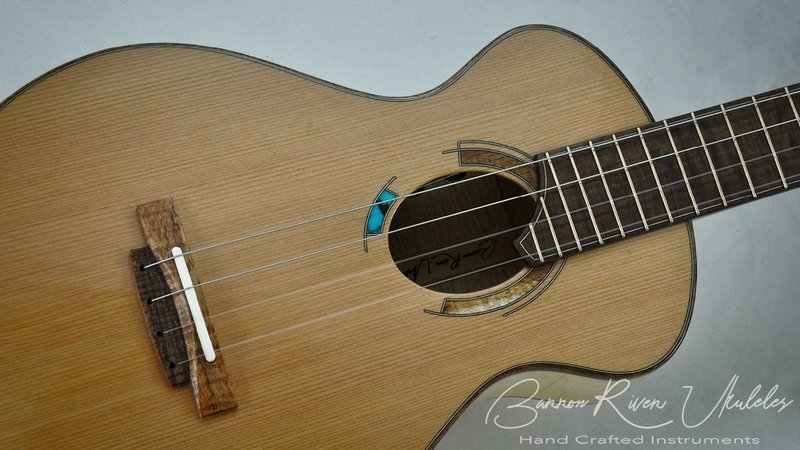

First time I've worked with Satin Box, and was pleasantly surprised on how it works. Even with this amount of curly figure I managed to bend the sides without any trouble.....though my bum was puckered up to start with.
The bindings are curly Blackwood and Ringed Gidgee for fret boards and head plates. Saverex and Thomastilk-Infeld flat wound stings.. MISI Air pickup system and finished in high gloss polyurehtane.

Hi Allen,
Another beauty!
What is the top wood?
I have some high curl Satin Box (did you get yours from curly?), and you say it worked well? How do you bend it?
Thanks,
GregL.
Posts: 5257
Re: Extreme Curl Satin Box Tenor Uke
Post by Allen » Thu Oct 11, 2018 5:26 pm
Cedar soundboard.
I hand bend everything no matter what timber, and then set the shape with blanket and solid form. It was pretty easy.

Hi Allen,
I had the pleasure of playing this instrument yesterday. Beautiful and brilliant. Sounded great and the little touch of blue from the turquoise is a nice touch.
You also take excellent photographs. I was hoping you could share a bit of information about how you get such good pictures - lighting , camera , lenses? The actual uke has an exceptional finish that is very shiny but you don't get any reflection in your pictures. Neat trick.

Post by colburge » Tue Oct 23, 2018 7:35 am
Top notch as usual! Are you moving away from your old head stock design? I have to say I liked the previous one a little bit more. I do like the heal and cap design that you have recently changed too, even though the way you used to continue the heel cap into the back was awesome.

Post by Allen » Tue Oct 23, 2018 7:45 am
I did this headstock on a couple of 5 string ones to make a better string path, and now am getting client requests for it. The heel cap change is because Im using a bolt on neck now instead of the Spanish Heel. Makes it impossible to do the old style.
