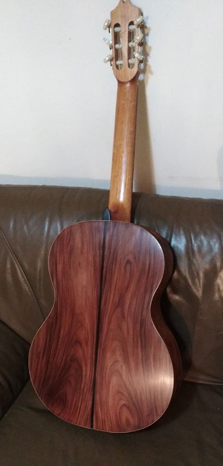

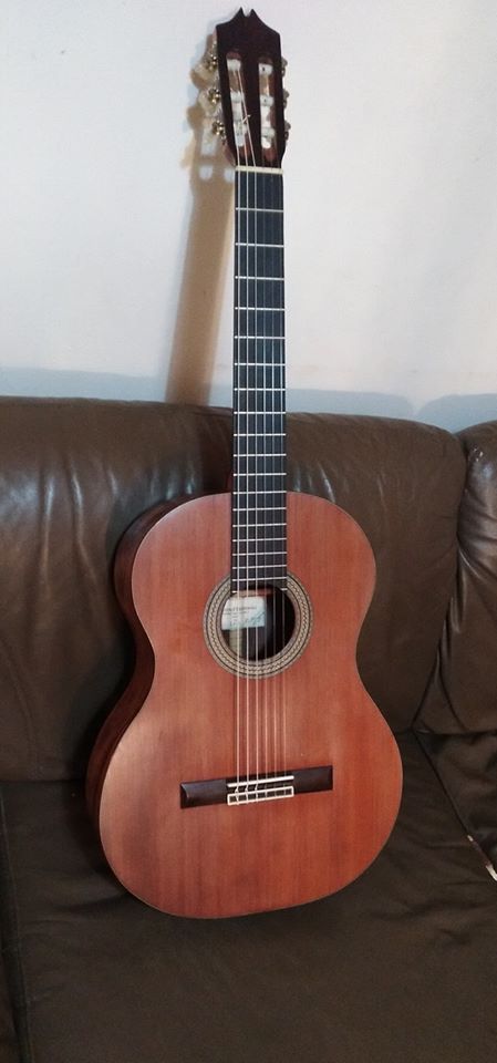

Post by kpcart » Sat Feb 09, 2019 5:41 pm
recycled Californian Redwood soundboard
Pau Ferro back and sides
Spanish cedar neck
7 fan bracing, no bridge plate, 3 brace back

Post by lamanoditrento » Mon Feb 11, 2019 8:35 am
Very nice :cl
Posts: 1165
Re: Redwood / Pau Ferro classical
Post by Mark McLean » Wed Feb 13, 2019 6:34 am
The colours are beautiful, and the styling very classical. Nice job!

:cl Great looking guitar. Out of interest what is the scale length, Neck joint? Im building at the moment and always nice to know what the detail is.
Thanks
Andrew
kpcart
Posts: 96
Post by kpcart » Thu Feb 14, 2019 7:54 pm
650 scale, 50mm nut. Spanish heel neck joint. 7 fan braces, no bridge plate. 3 braces back. Rosewood bridge ~19 or 20 grams. Saddle height 10mm above soundboard. Body resonance G (i prefer f# but its hard to predict).
