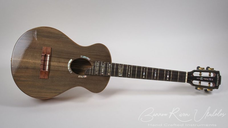

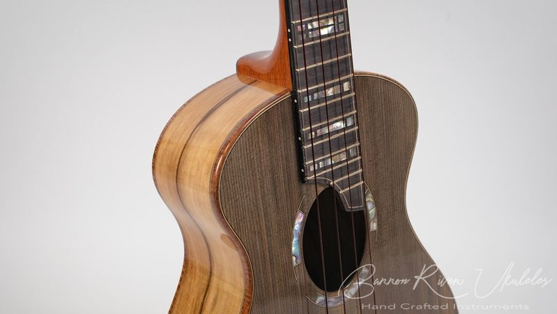

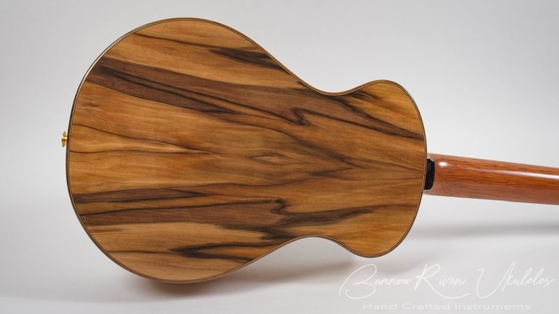

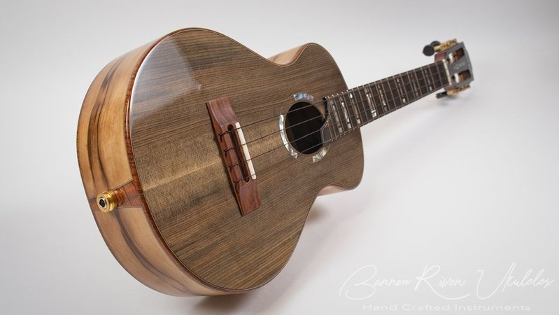

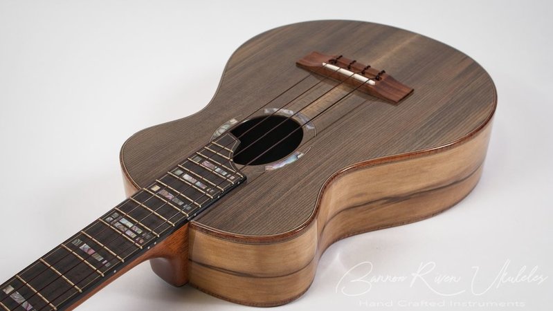

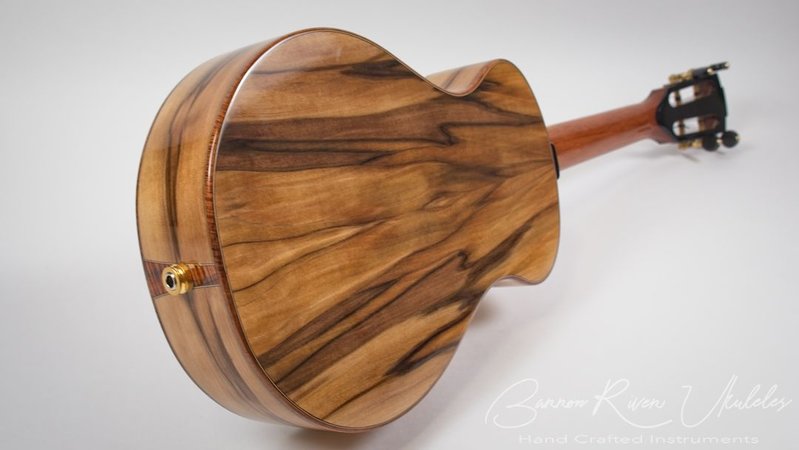

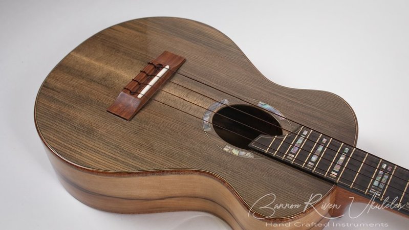

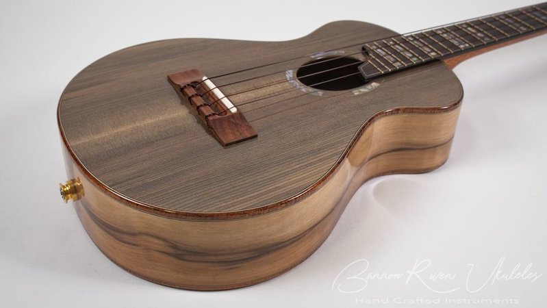

This one has been in the works for a long time. Had to scrap 2 complete necks with all the inlay already done because of flaws showing up after carving. Enough to drive you mad wondering how borers can get into into a piece of mahogany with no sign of entry.
So it's Tassy Blackheart Sassafras, Ancinet Sitka Spruce with Blackwood bindings. Pink Abalone inlay in Ebony with Rubner machine heads and a K&K Aloha twin pickup.
