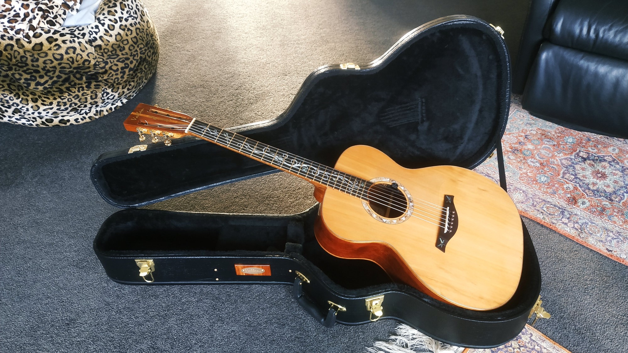

This an OM style just completed:
Type : OM like shape
Top : King Billy Pine (double thanks Pete)
Back & Sides : Jarrah (thanks Pete)

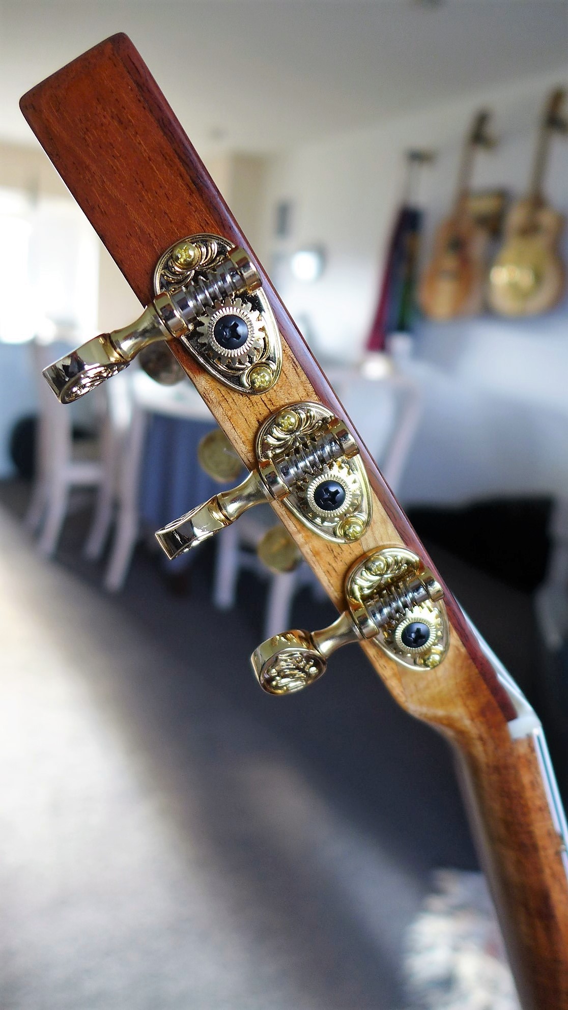

Neck : 3 pieces laminated Blackwood with Jatoba core.

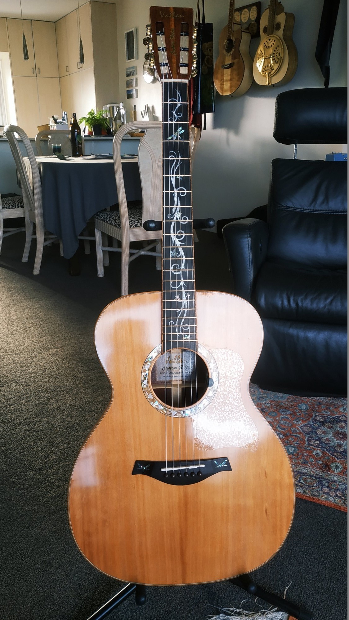

Fretboard & Bridge : Ebony with dragonfly theme inlays (bit of a team work here), width at nut 45mm with zero fret and 56mm e to E at the bridge.

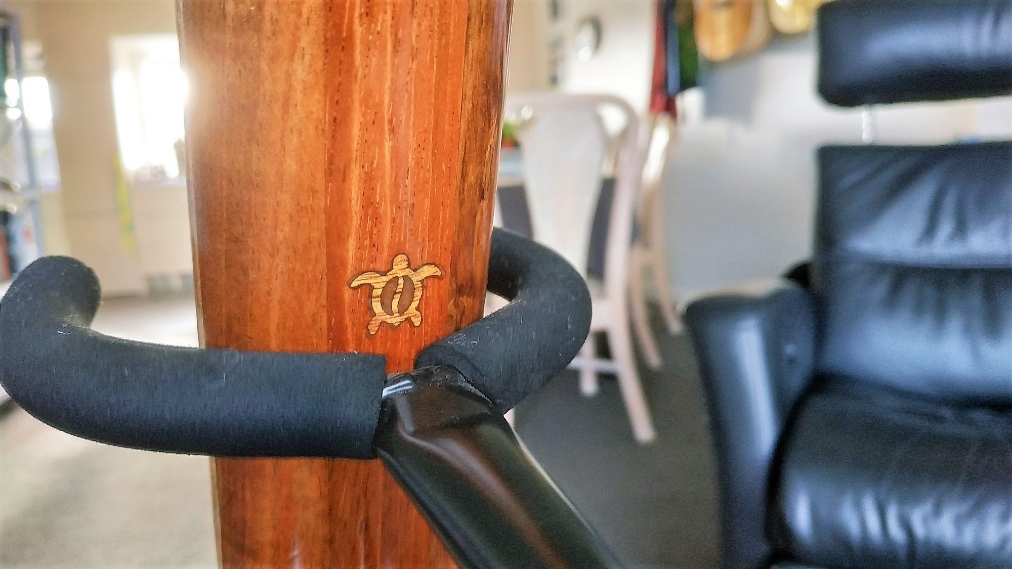

Koa turtle (present from Hawaii) inlaid on the back of the neck.
Strings: Martin silk & steel
Finishing: Platina shellac.
Very balanced sound with an incredible sustain, definitely another fingerstyle instrument.
