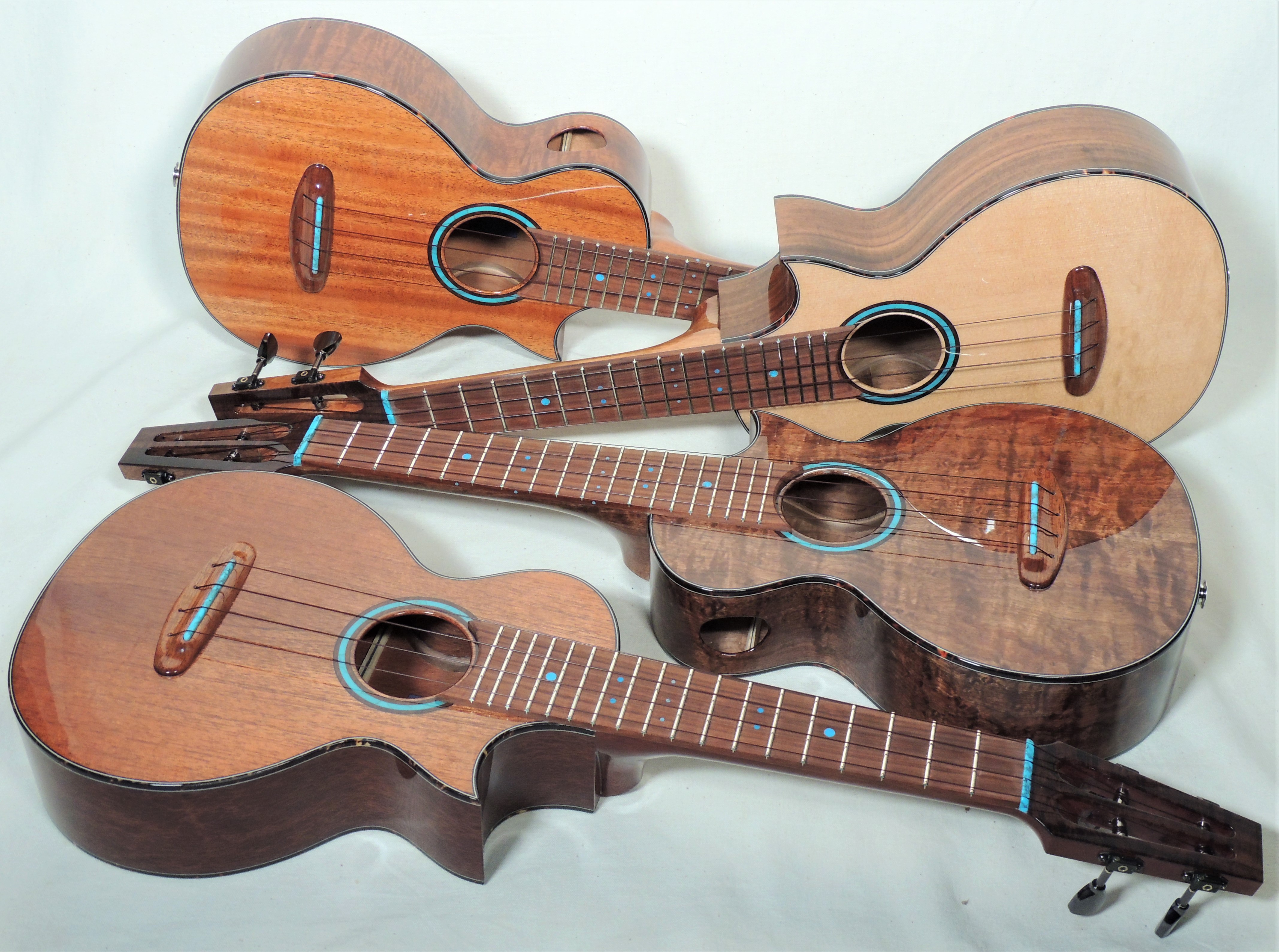

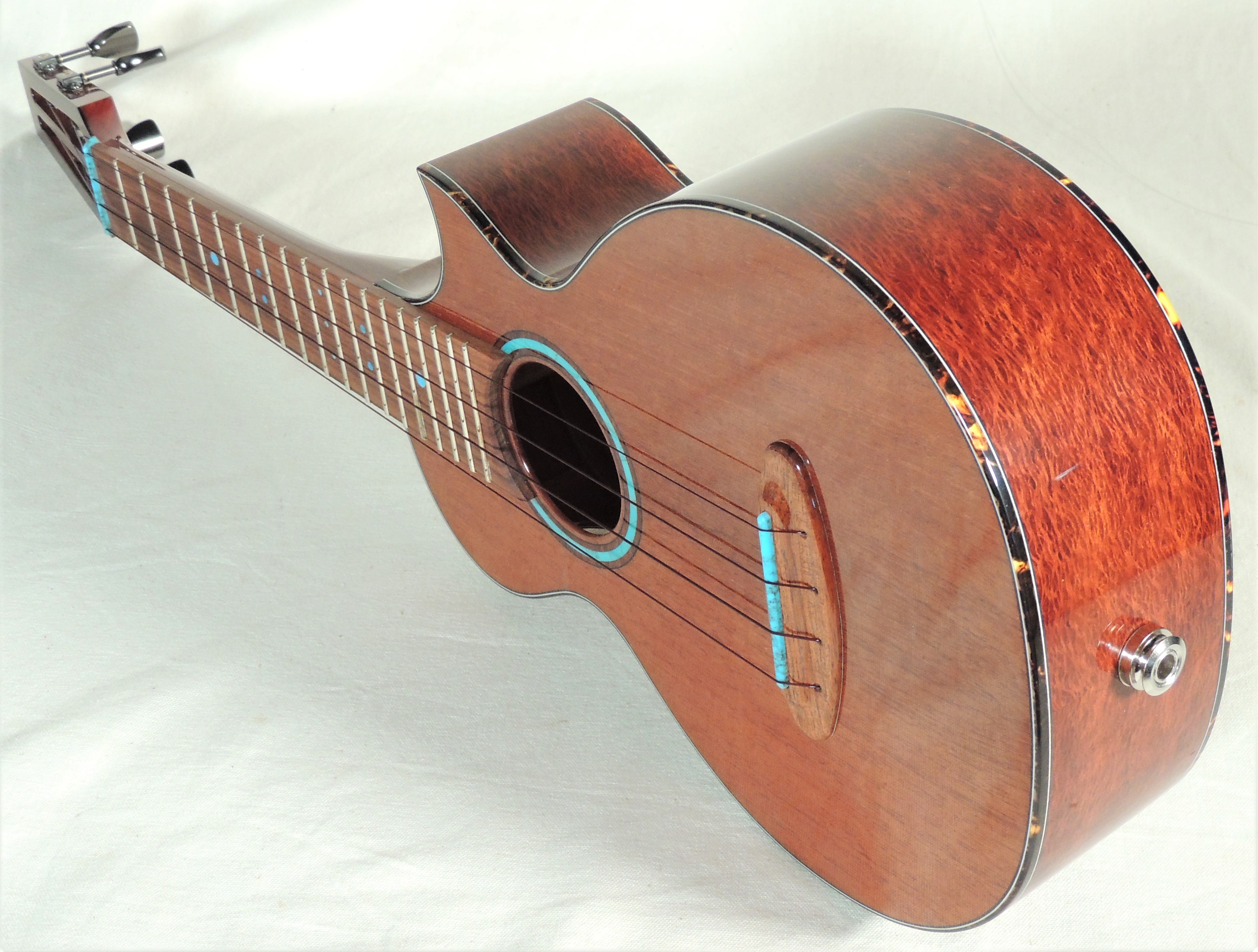

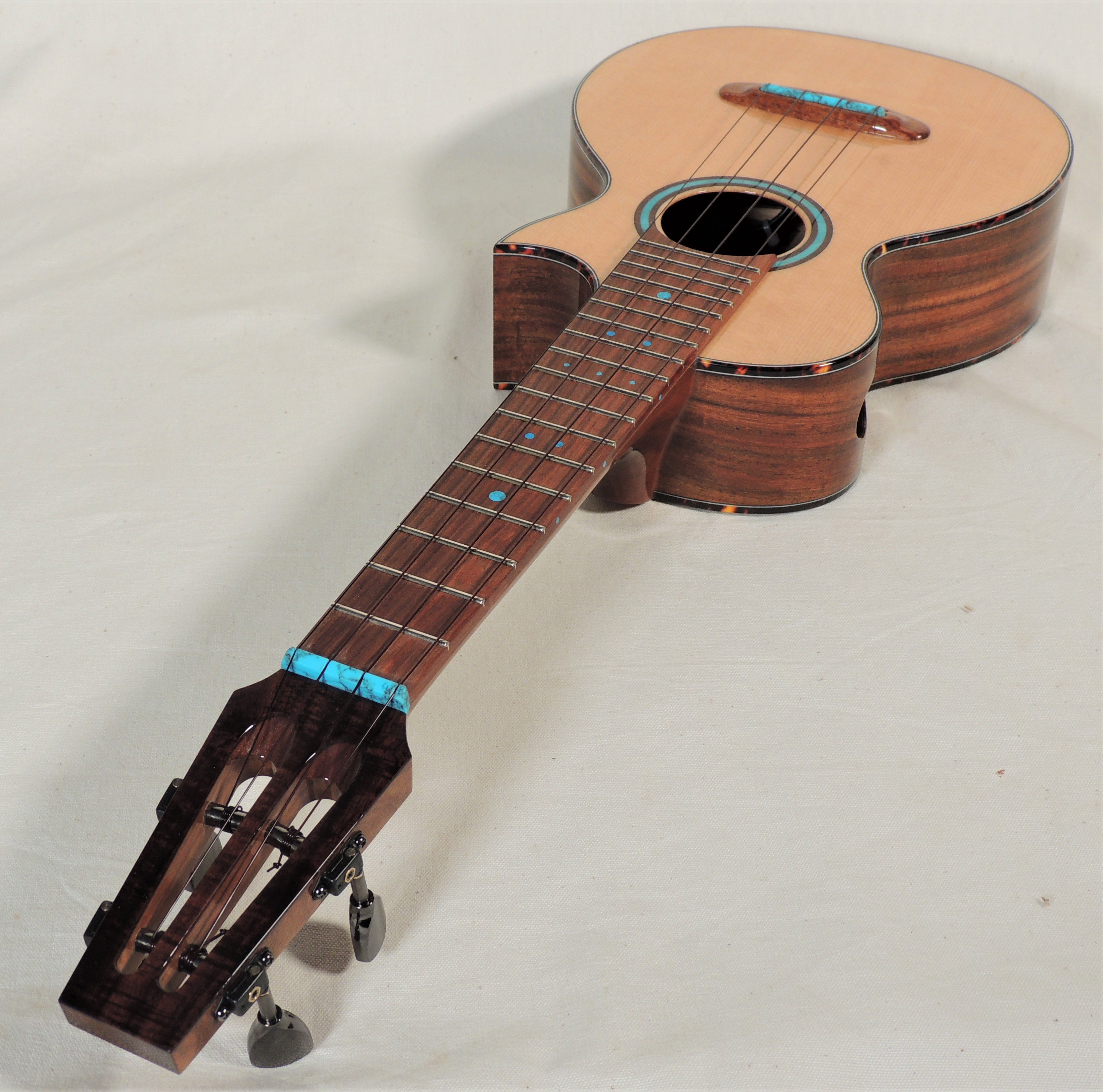

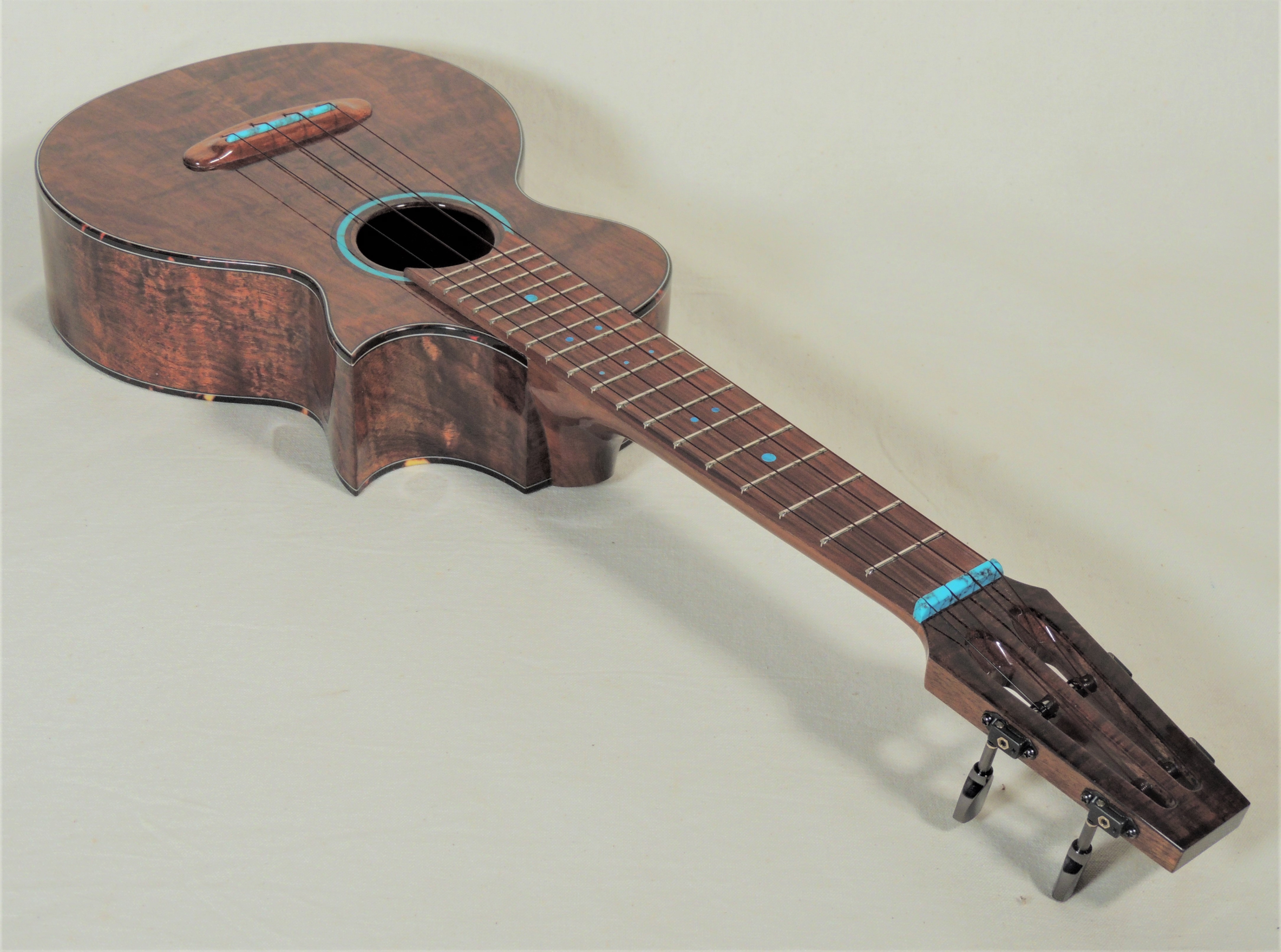

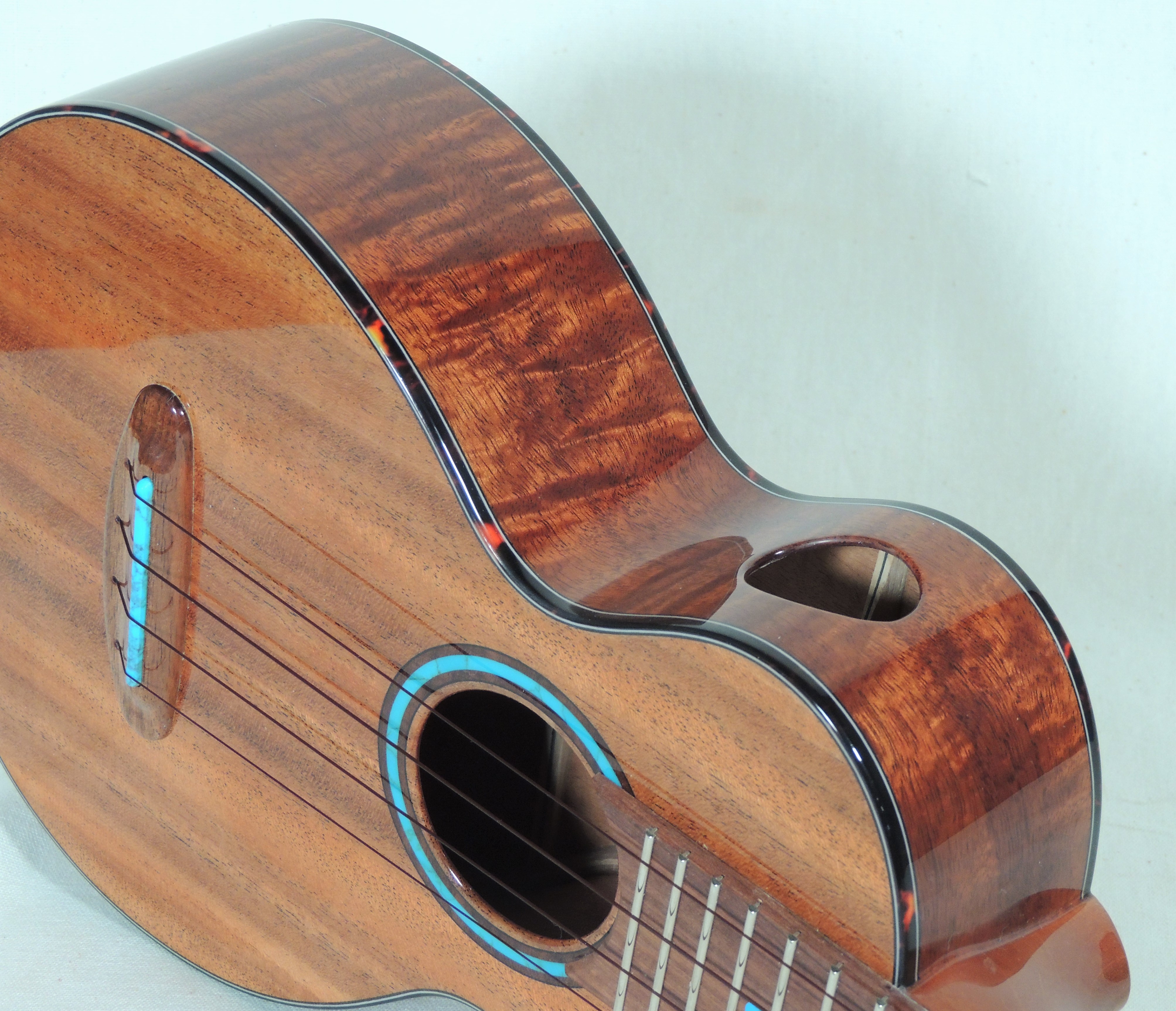

Howdee,
Its been a bit quiet around here lately so I thought I’d post some pics of the batch of concert ukes I just finished. There is one made from dark figured Australian Blackwood, another from Mahogany, another from Cooba and Spruce and another from Lace Sheoak and Aust Cedar. The common specs are as follows:
• Fretboard Material: Mulga
• Scale Length: 15”
• Tuners: Gotoh stealth
• Strings: Worth Browns
• Bracing: Double X
• Pick Up: JJB prestige-220
• Finish: Mirothane 5555
• Rosette, nut , saddle and fret markers: recon turquoise
cheers Paul

Beautiful! Love the turquoise. Thats a bit different.

They are beautiful Paul, well done.

Very nice Paul. Love the waterfall florentine :cl

Just brilliant can not stop looking at them :cl :cl :cl

Hi OutbackJack,
Thanks for the kind words. They are pretty cute and having made big ukes and little ukes I recon the 15" scale is the perfect uke scale.
I have just started collecting materials for another batch and was disappointed to discover that Gotoh have discontinued the stealth tuner. I'm going to have to design a different headstock as I don't think there is anything else out there to match how thin they are. Oh well, these things..............
