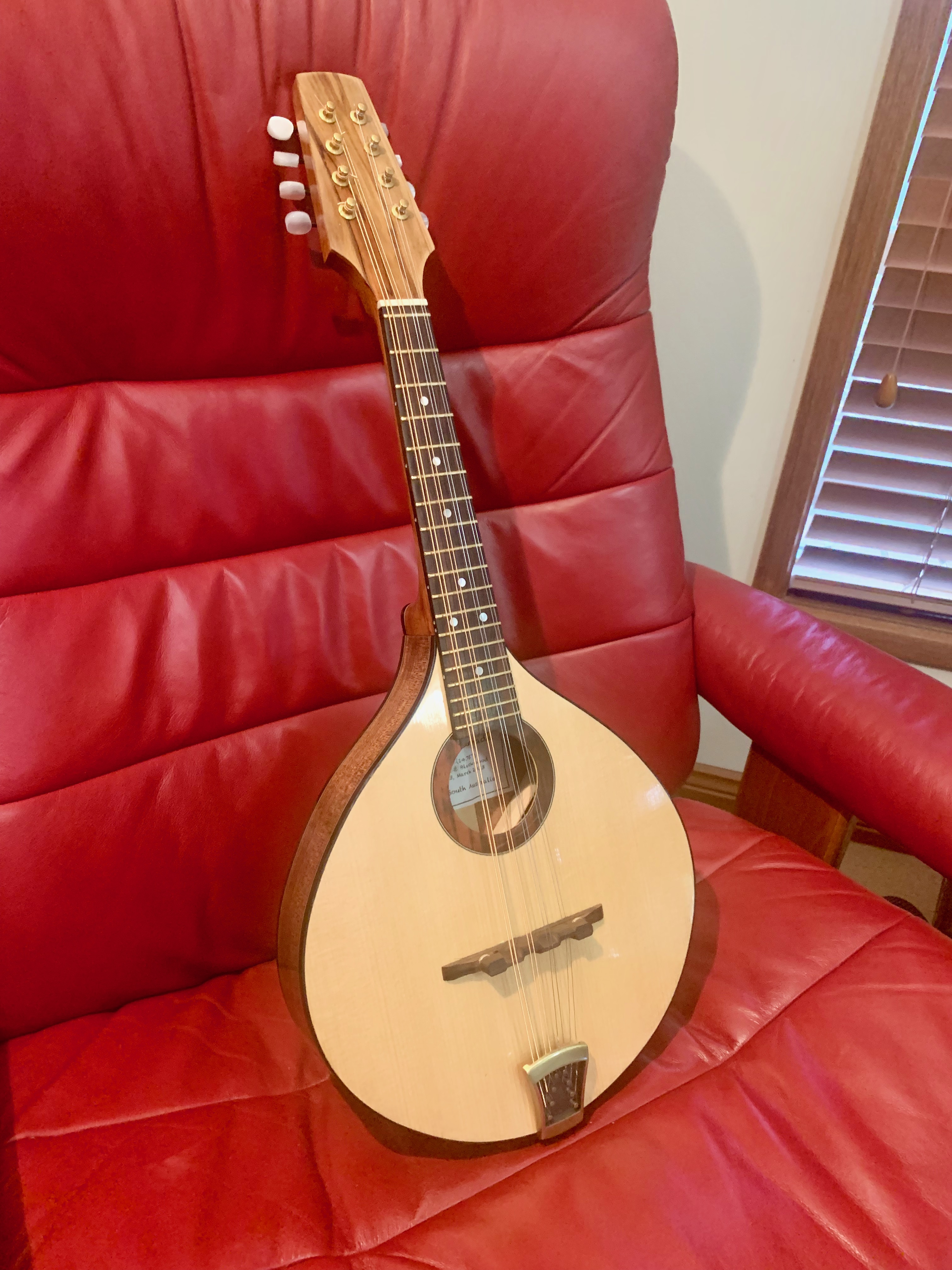

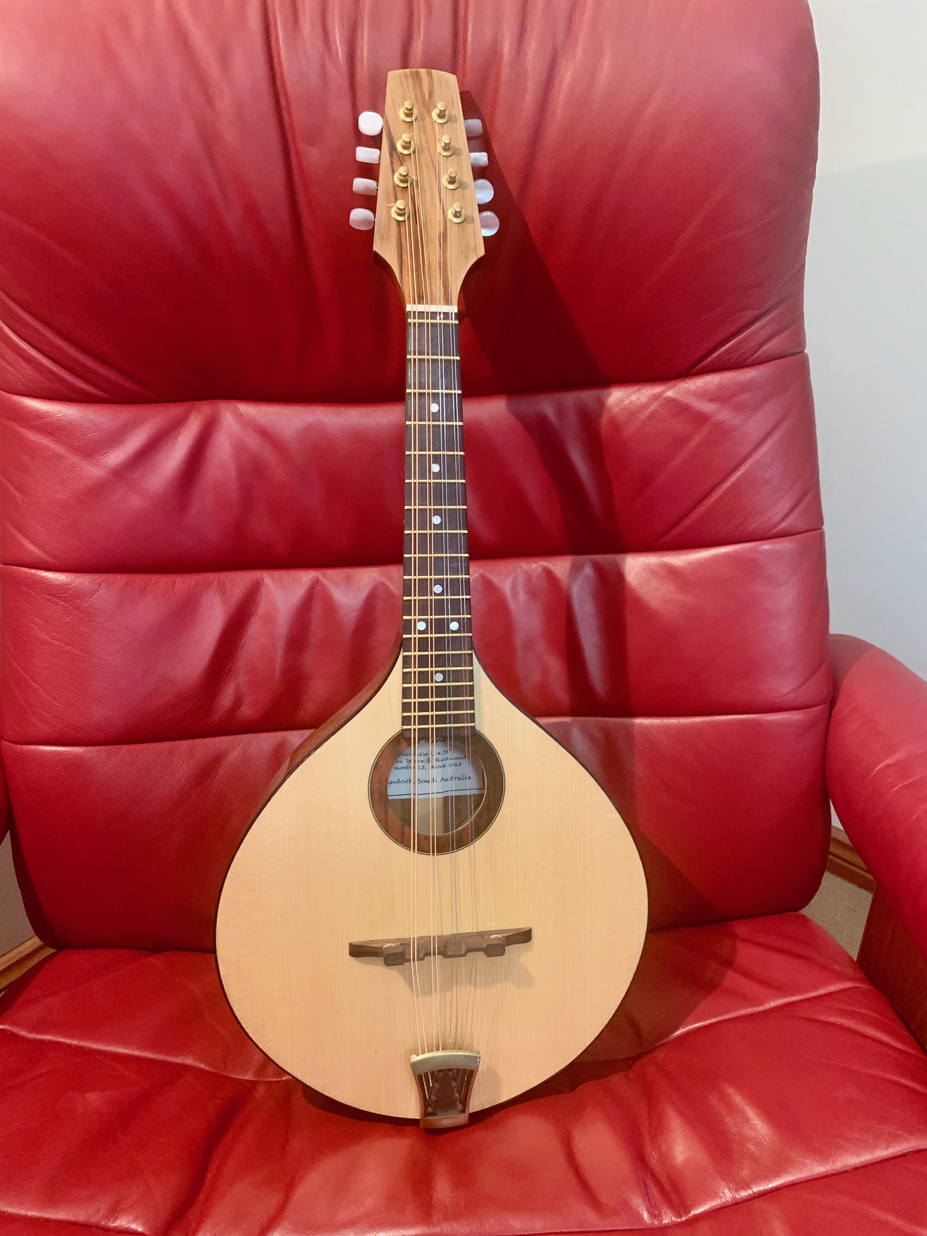

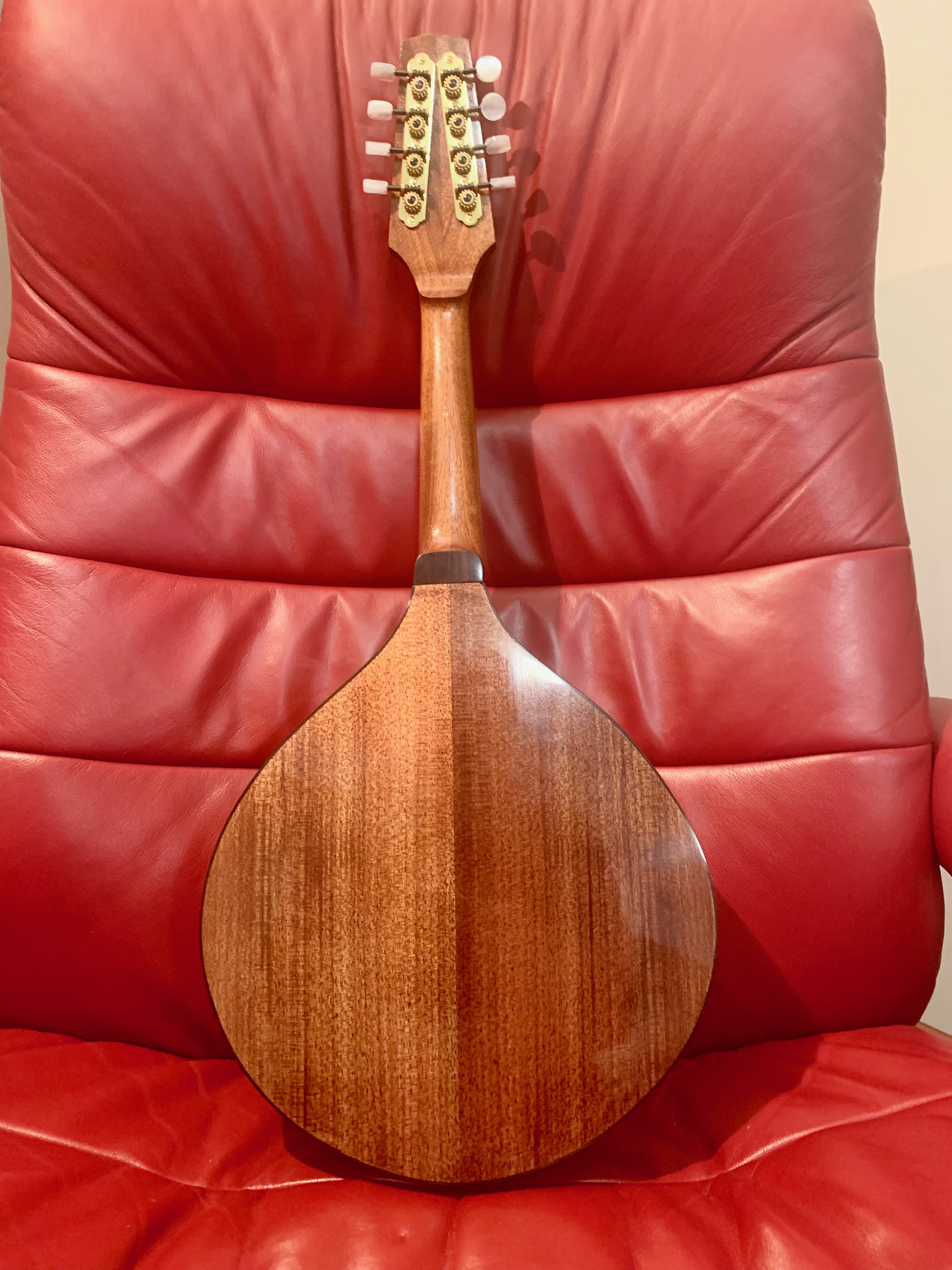

Another flat top mandolin, based on Graham McDonald's book but with a 14.75 inch scale length.
Blackwood and spruce, with ebony binding, a tiger myrtle rosette and a bound ebony fingerboard. African mahogany neck with carbon fibre reinforcement, black heart sugar maple headstock and Rubner tuners. Hardened shellac finish.
