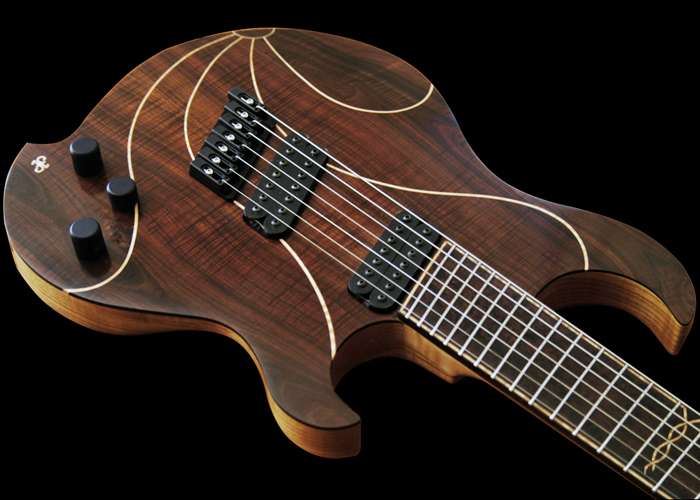

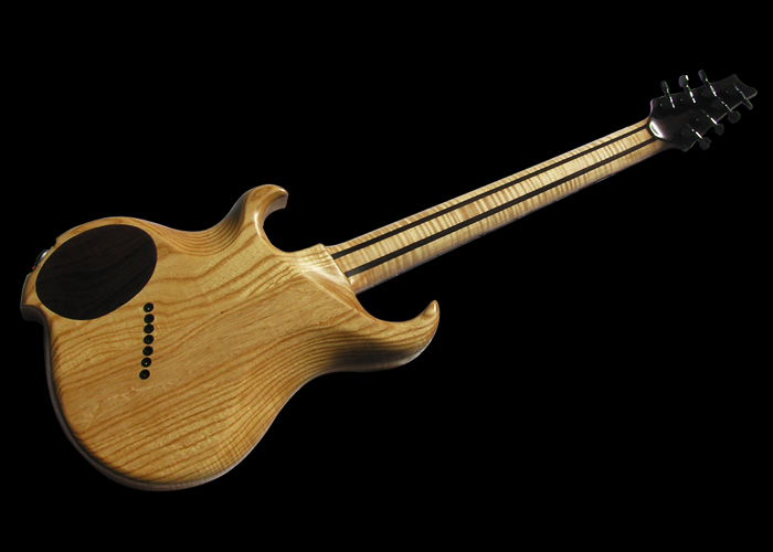

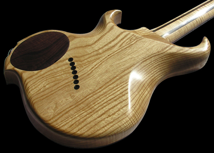

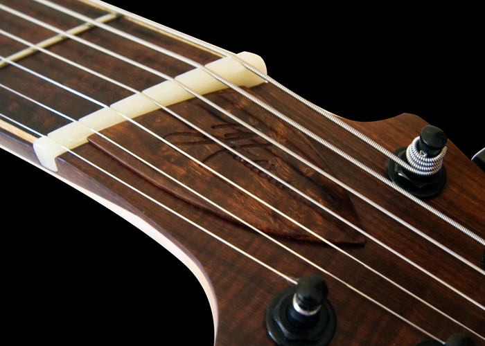

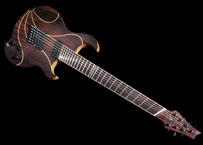

My seven string multi-scale electric. Body of American Ash with highly figured 5 piece steam bent ring gidgee cap. What a mouthful! Flamed rock maple veining between cap pieces. Rock maple and Qld Walnut tapered laminated neck. Ring gidgee headstock caps and control cavity cover. Raindrop gidgee fretboard and truss cover. Stainless steel fretwire, Gotoh machine heads and custom hand made humbuckers matching the offset scale lengths. Also a custom handmade bridge with Graph Tech String saver saddles. Truss cover and control cover are magnetic - hence the lack of screws. 635mm - 685mm scale lengths on this one.
Sorry about the plethora of poor photos - I just can't seem to get the settings right on this camera. It's always too bright, too dark, too washed, too colourful... Damn thing... These will have to do until I can do a better job.

Very outstanding effort Jeremy, she is beautiful and holds much innovation and craftsmanship. Really, what a freak'in cracker, the look, the fan frets, the style, the whole bloody package is just beautiful and what a fabulous way to overcome the limited supply of such beautifully figured wood.
Well done mate, did i mention clever, clever, clever. 8)

Wow....just stunning work there Jeremy. Can you tell us about the tuning on the 7 strings and the scale lengths, or does that have to wait as well?

Simply sensational Jeremy. The artistry in the top is inspiring. I want to hear all about it, especially the droptop, when you are allowed to. Nothing wrong with the photos either.

Allen, no issue with that. It's 635mm scale or ~25" treble to 685mm or ~27" extended bass scale. I just felt the extended range of the 7th bass string dictated the scale increase there to really give it some genuine bass boost and warmth. It really is a very full sounding guitar with richer, deeper basses than usual. I have tuned it in the basic seven string style of low B, E, A, D, G, B, E.
Mark, thanks mate. The top probably fought the hardest of all - partially my own fault too though. I could have done this purely by inlay but decided I wanted the pieces to be built up separately first creating a whole plate. The maple veining is tapered from about 1mm to 2.5mm one end to the other and steam bent to fit between each piece. I'll give more details when possible and on that note, I guess I should check what is and isn't ok... :roll: I hate secrecy. Oh, and thanks but the photos could be a lot better IMO :?

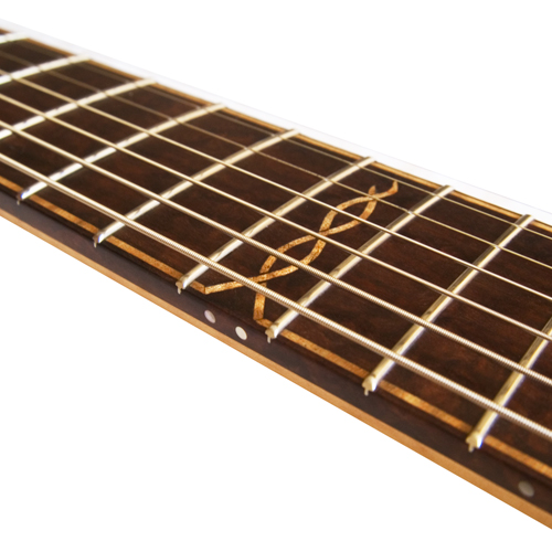

The more I look, the more I see! Just noticed that beautiful binding transition at the twelth fret :cl :cl :cl Take a bow you talented bastard! :wink:

Really like the look. That gidgee sure looks nice, any other pics of the FB?

Sorry, I can't help myself... nice ash. :P

espc the flamey gidgee and the way you pieced the top together....much artistry there

Nick - Yes mate. Graph Tech Wilkinson String Savers mounted to a custom designed (for this guitar) solid brass base that was black chrome plated. The pickups were cnc'd out and wound by a friend of mine, also a fellow luthier. Unfortunately, he doesn't do it as a business yet - just his own stuff and obviously we have our arrangements... :wink: Glad you noticed and liked the 12th fret inlay - I'm happy with that. The design flowed with the rest.
John - Yeah thanks a... hang on a minute... oh the timber! Right yeah that's not bad either. Very Happy I've added a couple more photos - one (still in sun) with some more detail of the fingerboard but I'm not sure if you meant the inlay or the timber itself or what?

Yup, pretty damn spectacular. Didn't catch the binding and knot on the FB first time around. 5 piece top? How's that?

Ah yes John, five piece top indeed and I think I outsmarted myself here.
This was part of my initial inspiration and design vision, something different to the more common bookmatch - so I jumped on the computer and drew it up until I was happy with it. Then I thought I'd be "clever" and get the five pieces laser cut in acrylic so I'd only have to follow the pattern. This is where the problems first started. Upon having the pieces laser cut, I returned home with them only to find they were not the shapes I had drawn. Upon investigation, apparently the firm had converted my files supplied to that of their machine and in so doing, the curves had all changed. :evil: Thus meaning, they no longer fit together.
I toyed with the idea of piecing two different contrasting timbers together for the top such as the gidgee and some nice flame maple but decided this would be too over the top visually. So I settled on the more subtle use of the same species with separating veins. Of course, I then decided simple veneer would not do for veining and that each piece should "grow" from it's point of origin in thickness. Hence I cut each strip and sanded them on an adjustable sled until they started at about 1mm and grew to about 2.5-3mm. These were too thick to bend to all the contours by force and so I steam bent each one on the hot pipe to match the five shapes.
All this put together meant that the original templates were well out and as such, it would have been just as easy to draw the shapes on the timber and rough cut them out. An expensive lesson I can tell you... Each piece needed to be hand fit and finished by the way of a spindle sander. Then I glued them together one at a time using cork backing and push pins until I had the whole top complete as one cap.
I hope that clarifies it and will put some pics up when I can.
