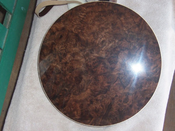

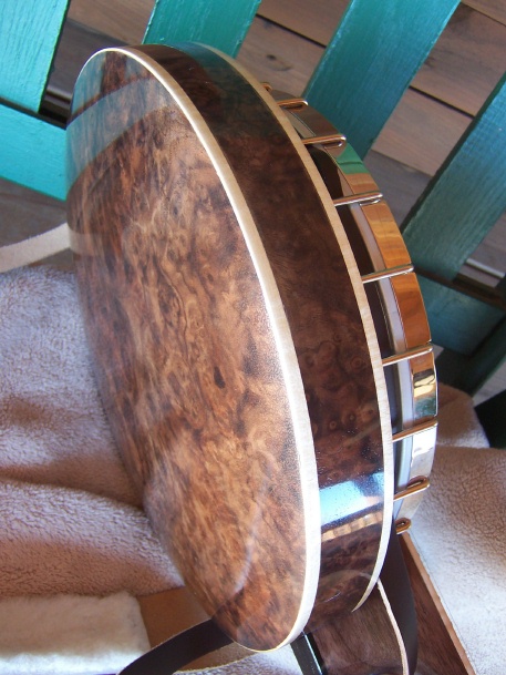

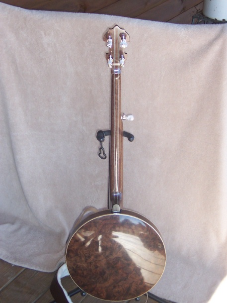

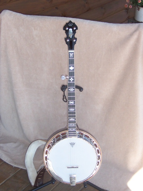

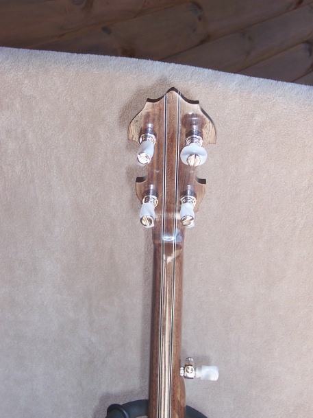

Well, for the past 4 months or so I've been secretly building this banjo. It is for me and I have no plans to build another as I already own a great Gibson Mastertone. If this one continues to improve in sound quality, I might just sell the Mastertone.
Much more difficult than folks might think. I made all wood parts from scratch. The rim (the body of the banjo that all the metal parts are connected to) is made from bubinga but cannot be seen without taking the back (resonator) off.
The resonator is mahogany, covered with walnut burl.

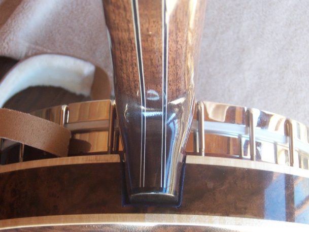

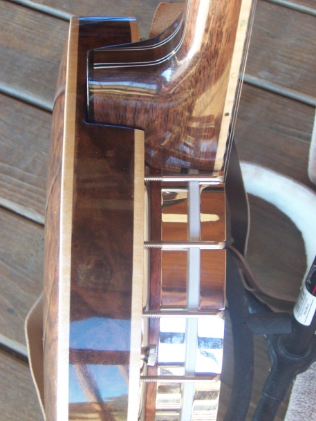

The neck is walnut. A banjo neck is not hard to make but it is more difficult to fit it to the body of a resonator banjo than fitting a guitar neck. It has to be cut out to fit over the metal flange and again to fit against the tone ring. In essence, it touches the body in three different places and they are all a different distance from the center of the rim. One must also put in the 2 1/2 degree neck angle (like on a guitar). Then, since it fits against a round body, the whole end of the heel must be curved to fit and all three points of contact require a different radius. Pictures would be helpful. Of course, the peg head is more intricate than most guitars, but it is more difficult to actuall cut because traditionally it is cut out perpendicular to the fretboard rather than perpendicular to the peghead itself.
Also, this is my first bound fretboard and no zero fret on a banjo.
Ron
Ron
