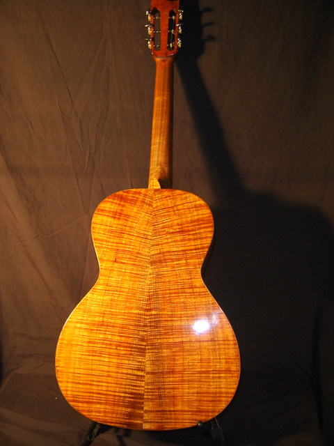

Anyway, this is my 4th build commenced in April and passed on to it's new owners last Friday night. I was fortunate enough that good friends and guitar lovers financed this build and it is in the hands of people who appreciate it warts and all.
The guitar is another LOO with adaptions and changes. It is 25" scale 13 frets to body and is a bit deeper at heel and tail. The bracing is x braces on the back and with an x brace to the lower bout of the top. I have a "spainish" style neck block and a sound port to the upper bass side bout. This was also my first attempt at a slotted headstock which really taxed the grey matter but turned out pretty good.
I was once again working with some lovely wood from Tim Spittle which drives you to do your best to give it justice. I shall post a link as soon as the new owner does some recording, it sounded so good it was hard to give away.
Thanks to Bob and all for the forum and the inspiration it supplies.
These are the specs plus a few pictures.
Thanks for looking,
Archie.
LOO shape, 635mm scale 13 frets to body
Depth at heel 95mm and tail 115mm
Bone nut 44mm - bone saddle string spacing 60mm
Lutz spruce sound board
Tasmanian Blackwood B&S, neck and bindings
Jarrah head plates, fret board, bridge and rosette ring
blue green and black dyed veneer purflings and head plate veneer
Red spruce top bracing, Bunya pine back bracing
16" radius fret board, 28' top and 15' back radius
Grover Statite tuners
K&K Pure Western Mini pick up fitted

Lovely work Archie. it has a very classy, understated look about it.
I like it a lot.

That looks like a stunner Archie. Can't see those warts! I love the look of the blackwood neck - amazing strata-look in the heel. I made a 13-fret L00 last year and I really love it. I will make another one soon and if it has fewer mistakes than the last it will be close to my ideal guitar. You really got it right with that one. How does it sound?

Thanks for all your kind comments. This guitar was a further stretch in the evolution of guitar building for me and I am very happy with the results sound wise. It has volume and clarity with the plectrum but is sweet and clear when softly finger picked and I am looking forward to hearing it again in a couple of weeks time. My wife keeps reminding me that no one else (other than another guitar maker) will ever notice the small details that seem to become so glaringly obvious to me when I am poring over it with magnified glasses for so long.

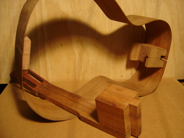

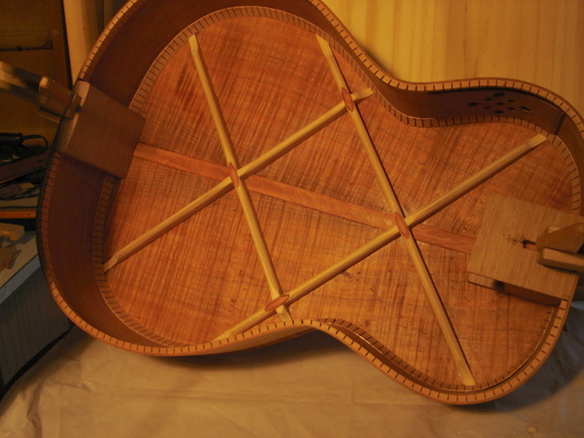

Just got in from the day job and see all these comments. Thank you all very much. Yes Liam I can honestly say that both the service and the product I have received from Tim has been superlative every time which is great as it keeps viewers oogling the wood and they don't notice the little filled gaps etc LOL. I have made 3 13 fret OO models now. The first was standard bracing and body depth with 25.4 scale. The second x braced, deeper body and 25.4 scale and then this one which is the same as 2 but with 25" scale and is getting closer to a sound I have in mind. I have posted some pics of the bracing and the neck block that I made up, all my take on various things I have seen on this and other forums that seemed to make a lot of sense.
Again, thanks for the kind words and for looking.
Archie.
