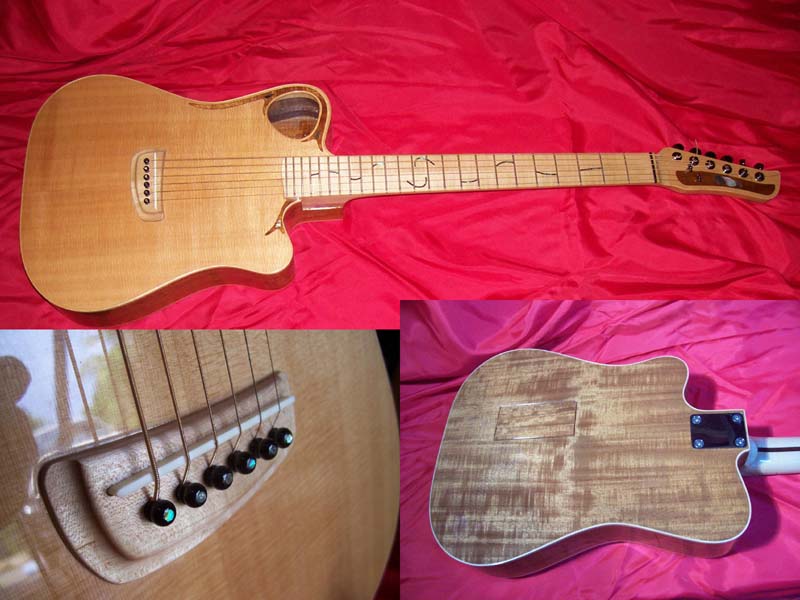

This is the CF and balsa lattice braced job almost finished except for final set up and adding the pickup.
Specs
Sitka spruce top
Black wattle (A. auriculiformis) nice bit of figure for the local suburban weed, they sprout up everywhere and grow fast as.
Rock maple neck and bridge
Paua inlay
Buffalo horn bridge pins
18 fret to body 24 fret total

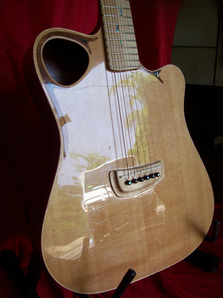

You can see that because I glued the bridge before finishing you get a ring in the finish around the bridge,the saddle will be dyed black on final set up. A shot of the figure in the wattle.
You can see from the roof line of the van reflection that the soundboard is lightly carved, not flat.

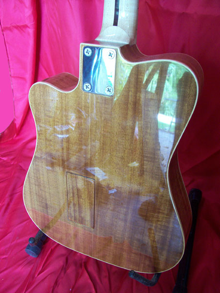

Remind me never to make a acoustic with a hatch in the back again please

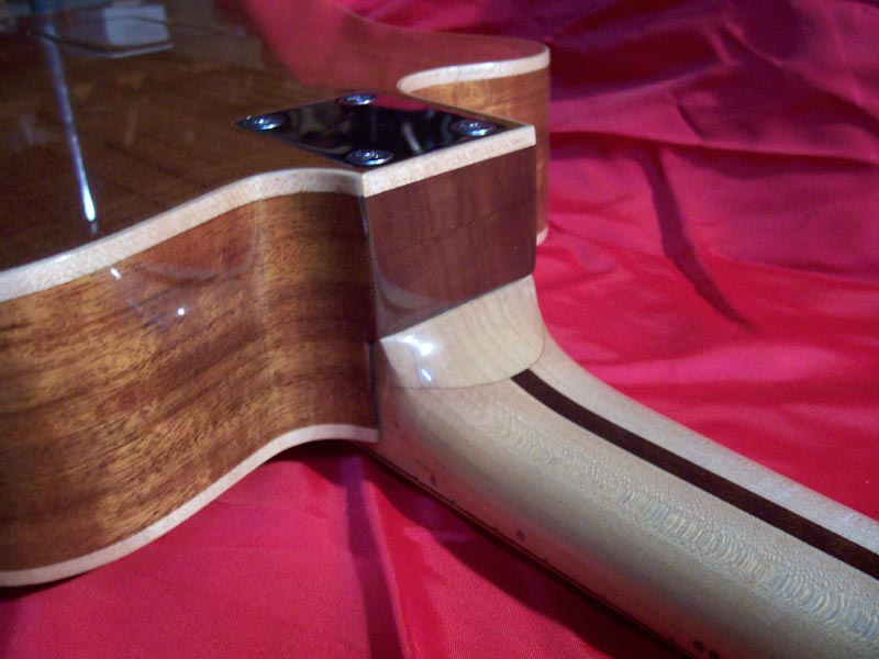

Fender style bolt on with small heel extension

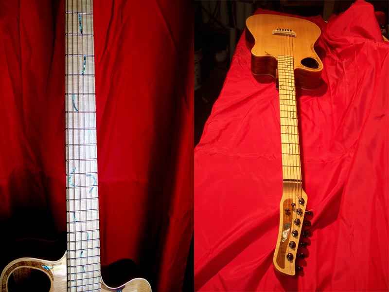

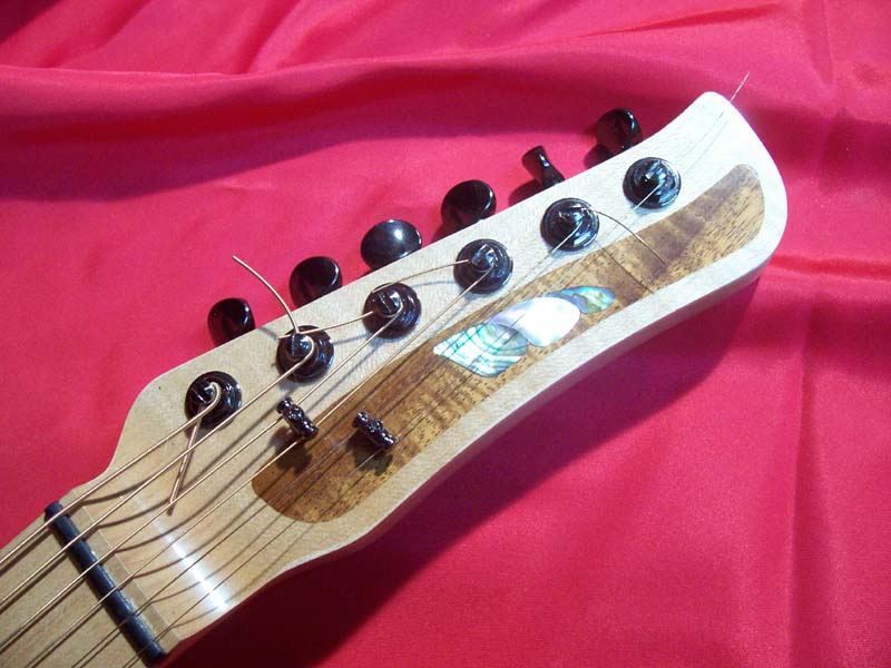

Headstock with surf theme
Paua fret markers

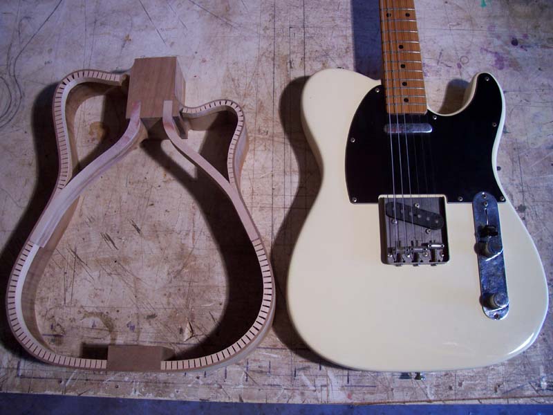

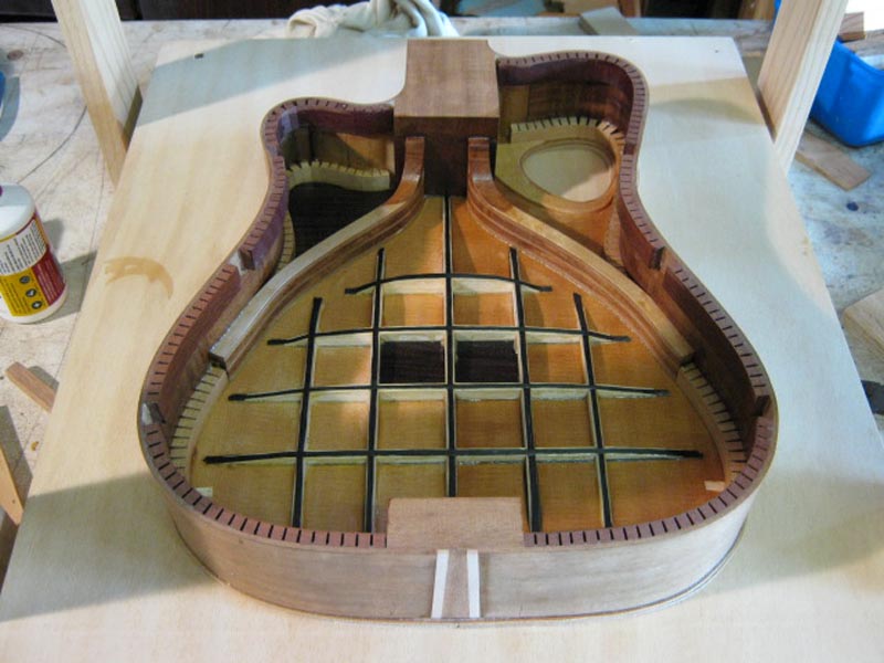

Was this the one that had the laminated & curved 'flying braces'?

Thanks all. The volume is very good Taffy so far. I will get a sound clip once I do a final set up. At the moment I have it set with a very high action to really pull some tension on it all as I run it in so it is a bit uncomfy to play. Yep Craig the same one, here is a reminder pic.

Any chance you have a shot of the bracing you used on the top to add to the gallery shots?
Re: Tele sized acoustic
Post by DarwinStrings » Mon Nov 22, 2010 2:58 pm
No worries Allen. Just a quick note though, I would not brace quite like this again as I have completely re-though how I will do it in the future. This was a first for me and am happy with it as such, but believe I can improve on it. With the lack of information on this type of bracing for steel strings (I went with a set of .012's on this) I have over built it.
Post by Allen » Mon Nov 22, 2010 8:06 pm
A photo is worth a thousand words Jim. As you said, very little is documented about using lattice bracing, and any info about it is going to help others. Even if you wouldn't do it this way again, others will be able to see what they may want to stay clear of.
It's just so easy to over build them with the lattice. I'm still amazed at how stiff they become once you have them all laminated up.

Wow. Awesome looking guitar mate. With the exception of the excess string hanging off the tuners :)
Post by DarwinStrings » Fri Dec 21, 2012 6:05 pm
Thanks Tobias. They are there to poke the bass player in the ribs when he starts to fall asleep at rehearsals.
