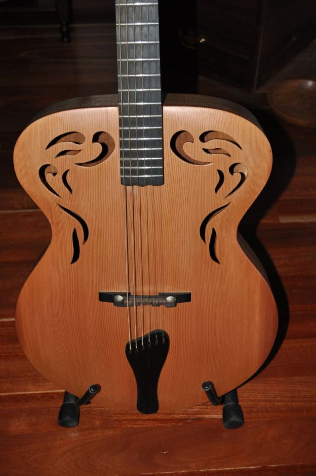

So after what would be 4 or 5 weeks of being finished I have finally got some photos. I have an excuse of my camera breaking and getting a new one for christmas but still.
So I used the Benedetto book to do this, its only a 16 inch body not the 17 in from the book and i did my own version of "f" holes on this.
I used western red for the top.

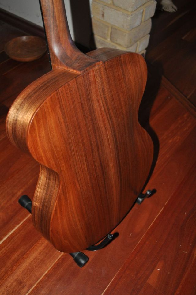

tassy blackwood for the back and sides
ebony for the rest. (granted i bought the bridge)
It was a real learning curve and has sparked something in me and I already have plans to make alot more guitars. so I am sorry but you all will be answering my questions from now on....your stuck with me.
It has a few little issues that i need to work out, but nothing that stops me playing it. I was surprised at how good it sounds very mellow and has loud bass tones. it is a little thin with the higher register but i didnt expect the worlds best guitar on my first try. all in all it took me about 96 hours to make from rough wood to playing a song. so it was alot quicker than i thought it was going to be.
enjoy
Aidan

Wow....that's really a great first effort, and reading your intro I was surprised when I scrolled down to see the pictures. When I hear arch top I just automatically think cutaway, and here you did something outside the square.

Nice job Aidan, I'm liking the timbers you've used and to 'stray' from the traditional "f" soundholes on your first & have them work... I admire your pluck
Well done.

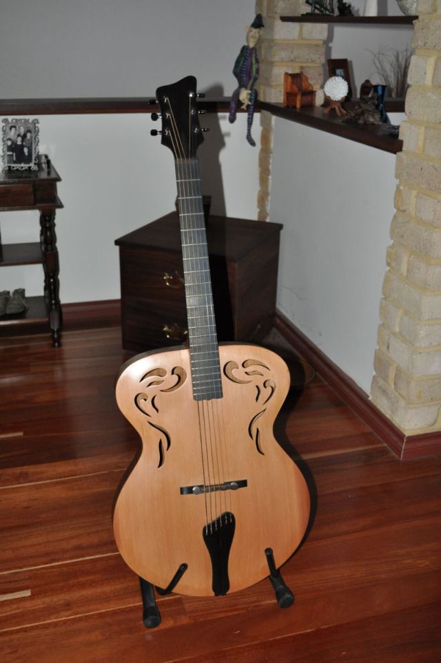

When you scaled down the lower bout size did you do the same for the upper bout? It just looks a little 'out of proportion' to my eye (infact the 2nd picture in the series, with the perspective taken into account, almost makes the upper look bigger than the lower) and seems to 'accentuate' the longer flat area either side of the neck as opposed to the nicely rounded 'arse end' . A small critique that doesn't detract too much from my liking what you have achieved.

Thanks for all the feed back. I agree about the upper bouts looking a bit too big. it only looked out of whack when i had gotten to far with it. One of the learning curves you get with these things. Its amazing how one little detail can throw your eye off. I;m not saying its ugly but its not what you would see as normal. lets hope that the ones to come dont have the same issues
