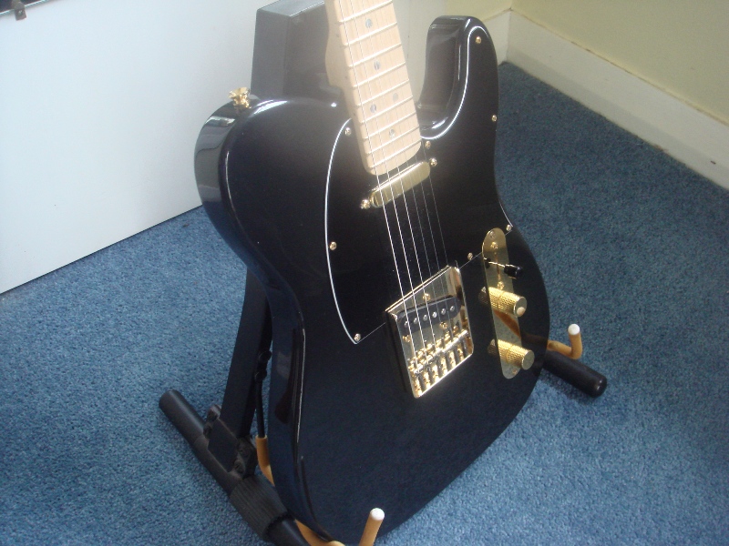

Weighing in a 4.5kg, I am proud to announce the arrival of Black Betty, a very solid body electric inspired by one of the most enduring design icons of the 20th century, IMHO, the Telecaster.
This guitar is my sixth and is a right hander, made with r/h parts cannibalised from my earlier lefty Rimucaster, as I have now found proper l/h gold hardware for that. It’s also an attempt to get one of my guitars out there, to see if anyone else thinks they are any good. I’m going to loan this to people and see what suggestions for improvement I get back.
So, the specs are:
Body - Kwila
Neck and F/bd - Rock maple
Gold EVO frets (thanks Nick)
Paua fret position markers
Kent Armstrong pickups
Action and pick up heights all to 52 tele specs.
Pyramid strings
Aus has sent some of their weather over here today, so hope they are getting a bit of a break while we prop up the cyclones. Consequently, the pics are not very good as I cant get outside and (though I say so myself as shouldn't) they don't do it justice.

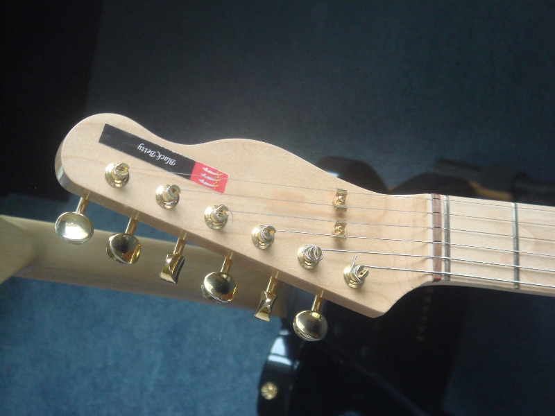

The Headstock

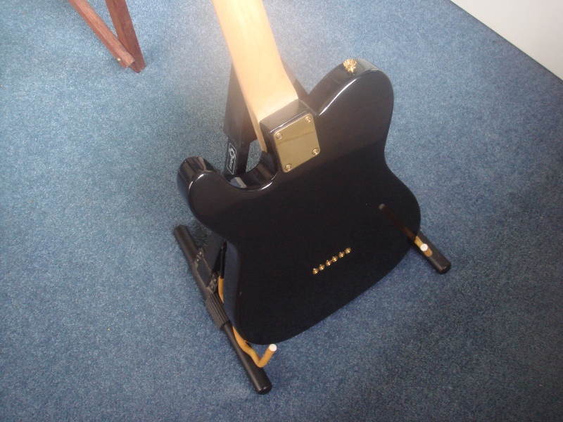

Rear view
