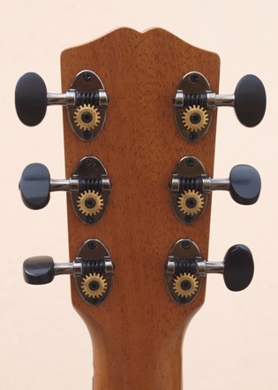

- Schertler tuning machines
- Tuners.JPG (46.07 KiB) Viewed 23550 times

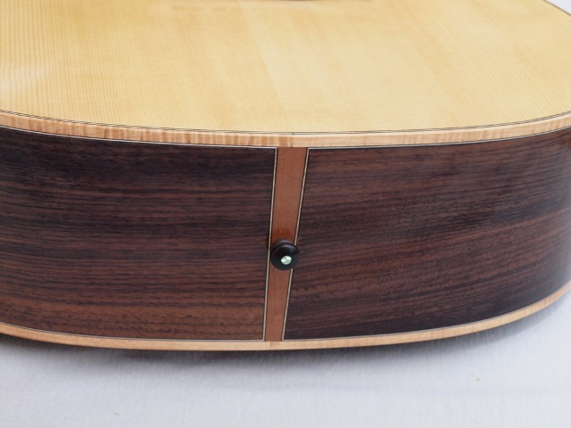

- Endpin.JPG (73.3 KiB) Viewed 23550 times

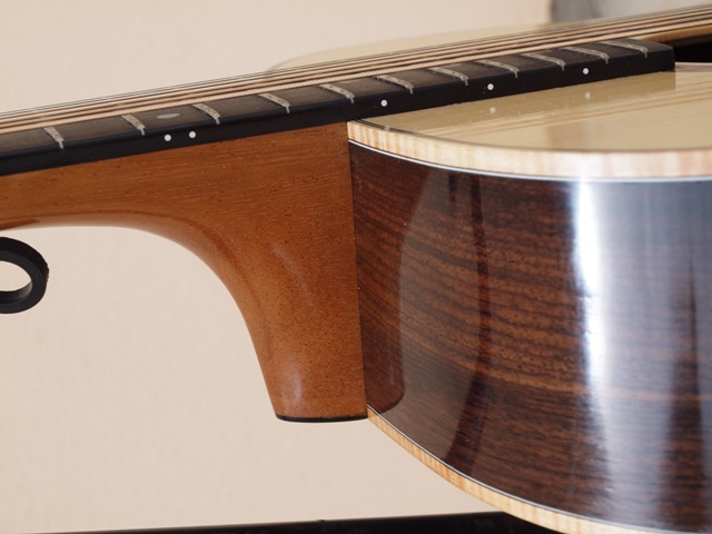

- Bolt on neck
- Neck joint.JPG (77.56 KiB) Viewed 23550 times

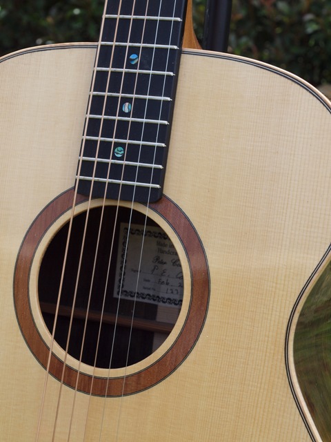

- Myrtle rosette
- Myrtle rosette.JPG (92.31 KiB) Viewed 23550 times

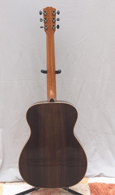

- EIR back, African mahogany neck
- Back.JPG (57.26 KiB) Viewed 23550 times

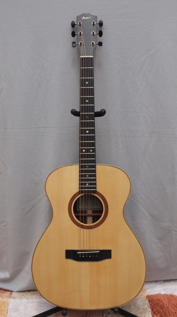

- Carpathian top
- Front.JPG (56.39 KiB) Viewed 23550 times

The tuners are Schertler, just recently offered by Stew Mac, made in Switzerland. Very nice, very smooth and accurate, and not too expensive for the quality. Knobs are Ebony. Recommended.
