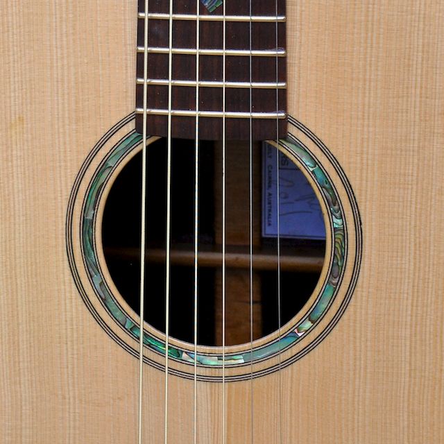

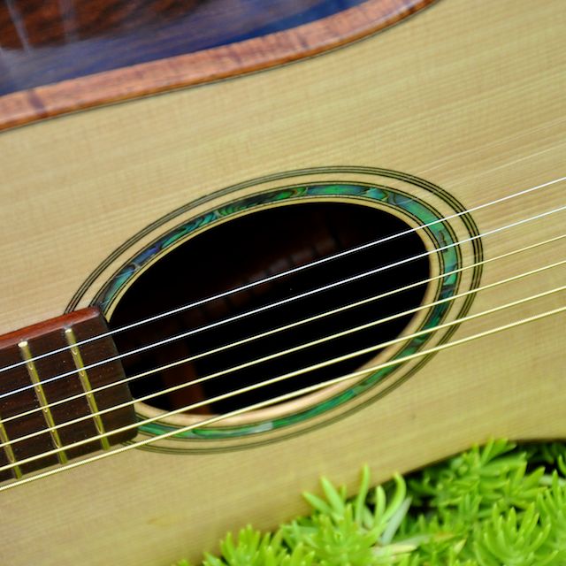

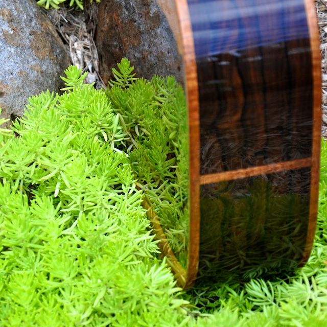

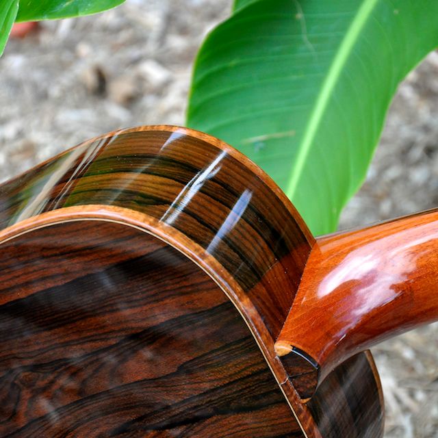

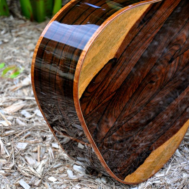

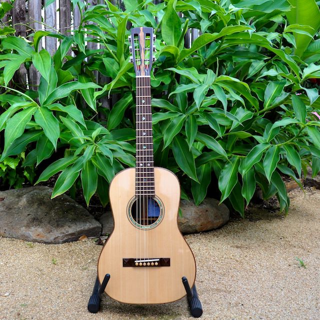

This ones been strung up for over a week now and been waiting for the weather to fine up a bit in order to get some pictures. We got a break from the constant downpour of the last 3 months for a few hours today, so out with the camera. :D
I had planned on building this guitar for some time, and when the customer came around to pick wood, he fell in love with the very pieces I would have use had it been my own. I love it when it works out like that. And it's not often that you get someone wanting a terz guitar.
Anyway, the details are thus:
Back and Sides - Zircote
Top - Adirondack Spruce
Bindings - Blackwood
Neck - Brazilian Mahogany
2 Carbon Fibre rods plus double action truss rod
Fret Board - Minneretchi
Bridge - Minneretchi
Bridge patch - Honduran Rosewood
Braces - Adi Spruce
Linings - Spanish Cedar
Fret Wire - Gold EVO
Tuners - Golden Age Restoration Tuners, Antique finish with etching
Finish - Mirotone 3220 over WEST Systems
Stings - 12 - 54 tuned 3 half steps up to Terz tuning

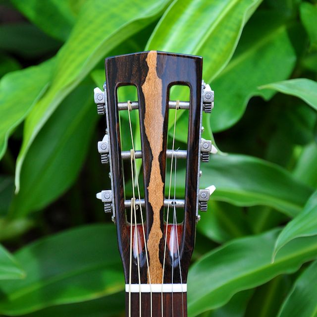

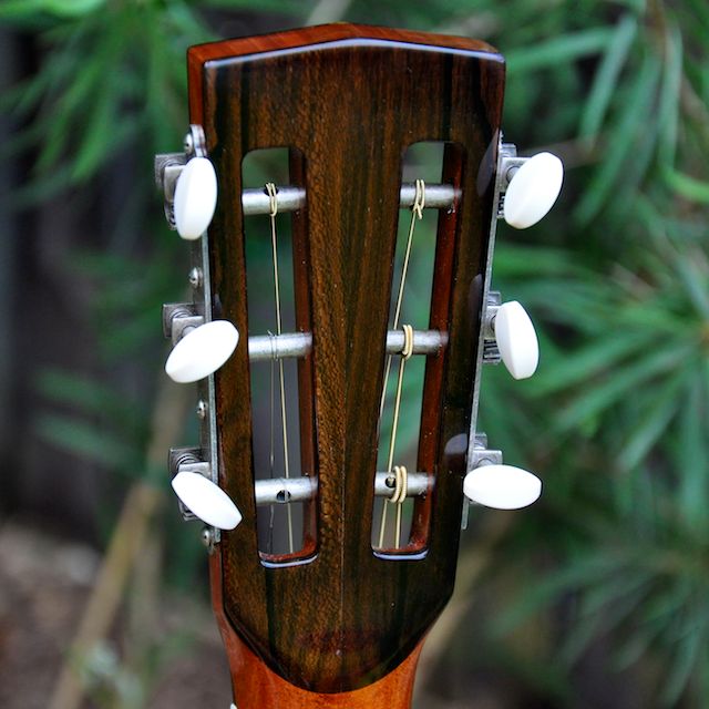

What an unreal little guitar! The headstock is a stunning feature and your finish is first class as per usual. Love the fret marker shapes as well. Beautiful mate!
Re: Zircote / Adirondack Style 5 Terz
Post by Kim » Sun Mar 13, 2011 9:08 pm
Yes this one is a lovely looking little guitar Al. I really like the delicate structure of the peghead, very nice indeed. By delicate I mean it is elegant, yet the tuners butch it up just enough to give balance so the look is classy rather than dainty.

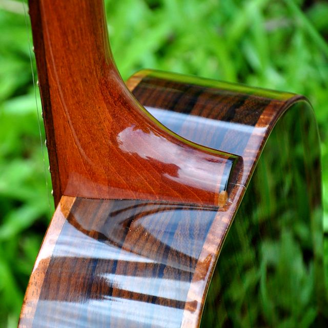

Thanks everyone for your kind comments. Trying to take pictures of these things is actually a lot harder than one imagines. Reflections and such either have to be eliminated....no easy feat, or try and make a feature of them....that's not so easy either.
I was trying to go with a bit of a vintage look, but the wood choices give it a rather modern flair, so it's a blend of both I guess. I'm pleased with the outcome and I think I pulled that off here.

This one has lots of fundamental and each note is very clearly defined. The Adi spruce is just so very stiff that it's going to take some time to open up. 3 weeks with strings on it, and it's just getting to where my other guitars have got to in a day or two.
I tried tuning to standard tuning, but the strings just wouldn't drive this one at all. So at a terz tuning is obviously brighter than your regular OM. Volume is building as it's opening up, as is the sustain which is really great. The customer is going to be picking it up in May when he's in Cairns and I'll try to get a video with sound sample if he's willing.

Post by Bruce McC » Mon Sep 05, 2011 8:21 pm
Hi Allen
Nice looking guitar. Do you insert bushes into the peghead to support the
tuners posts ?
Bruce Mc.
Posts: 5257
Post by Allen » Tue Sep 06, 2011 5:41 am
No bushes on this one. The first one I did used different tuners and I did install bushes, but it was a real pain in the arse to get them in.
Bruce McC
Posts: 397
Post by Bruce McC » Wed Sep 07, 2011 7:41 pm
Hi Allen
Thanks for your reponse. I think I can imagine why you say what you say.
Is it common practice to fit bushings to tuner posts on slotted peghead steel string
guitars?
I am currently working on an OM style and am planning to use Golden Age Restoration
tuners with a slotted peghead Queensland maple neck, hence my enquiry.
Bruce Mc.
Posts: 5257
Post by Allen » Wed Sep 07, 2011 8:09 pm
I'd never use bushings on a slot head again after that first time around.
