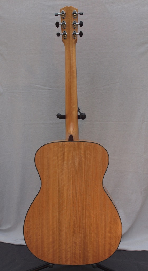

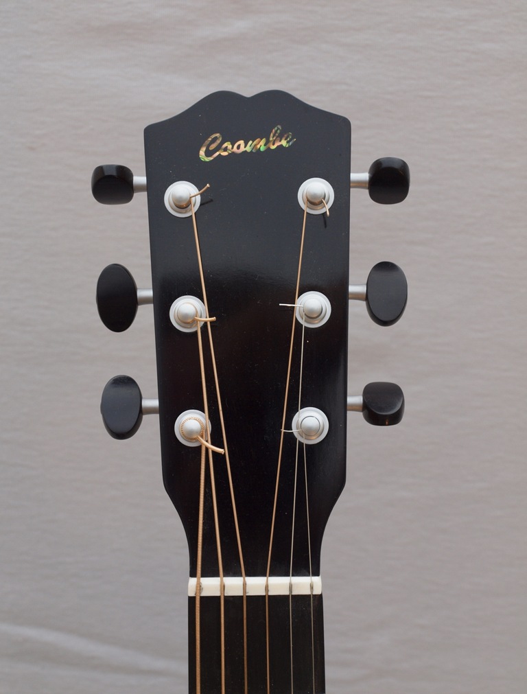

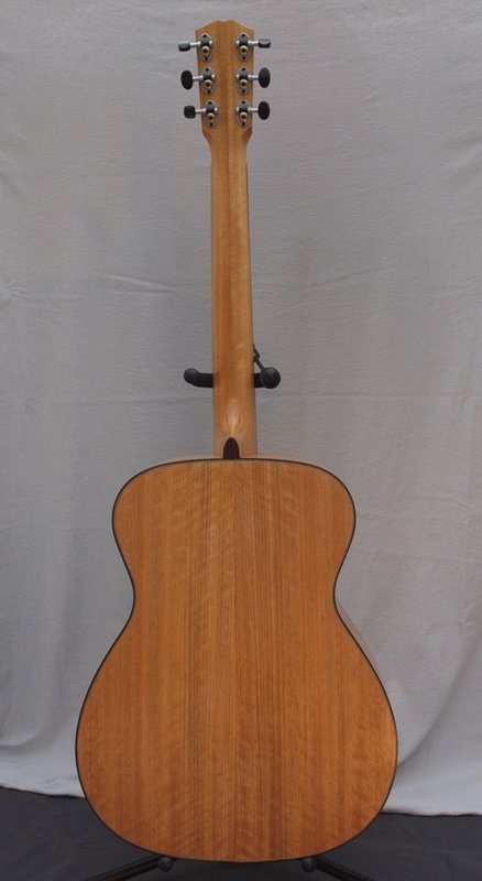

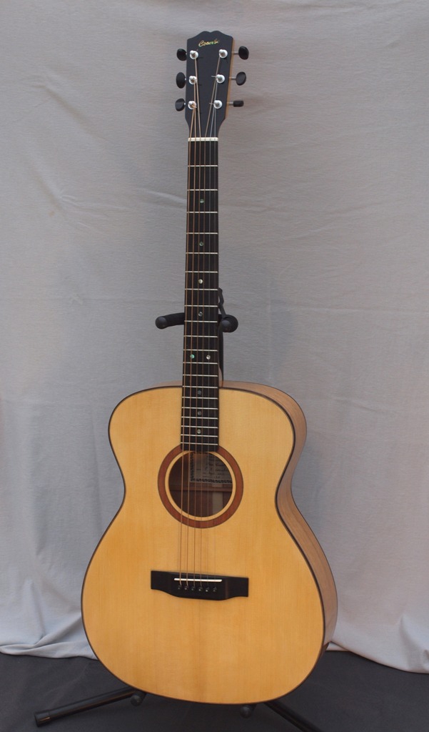

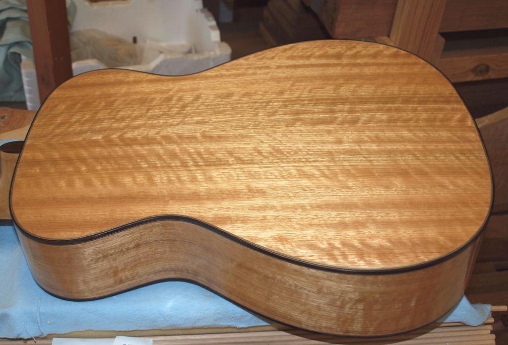

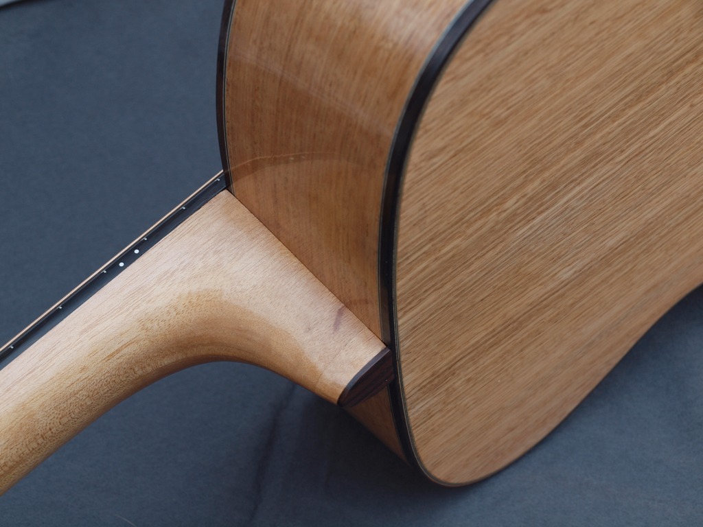

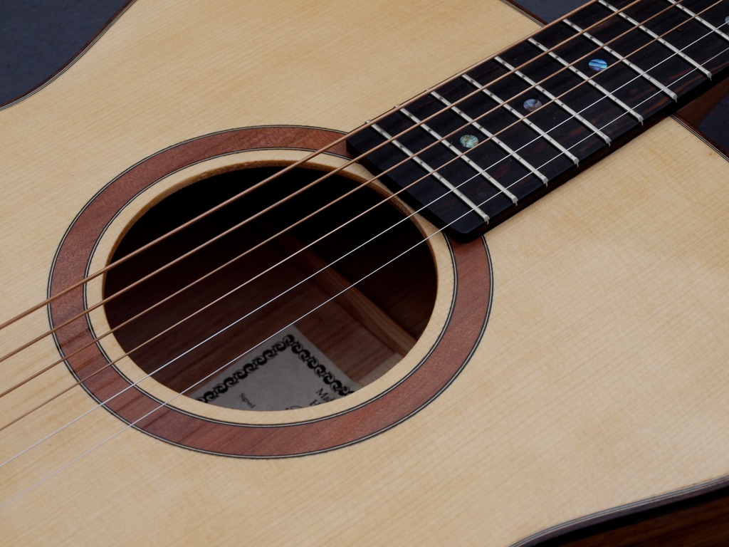

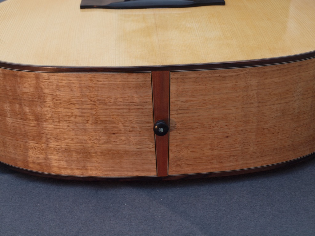

Doesn't seem long since I put up pictures of my first guitar. Well here is the second. Woods are Carpathian Spruce top, Tassie Oak back and sides, Qld Maple neck, Myrtle rosette, Indian Rosewood bindings, Ebony fingerboard, tuning knobs, headstock overlay and bridge. Bolt on neck, varnish finish. Made in the same style as the first, i.e. simple and elegant and sounding great. This one I think is a significant improvement on the first, so I am over the moon about the sound. Deep rich sweet tone, very nice indeed. The Tassie Oak is from Bunnings.

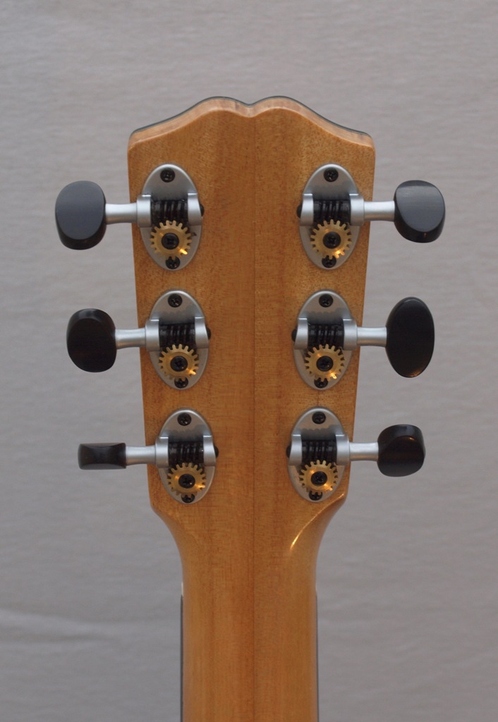

The Schertlers are well worth what you pay. Very smooth and accurate, they put the Gotah's on my reference guitar to shame.
I have quite a bit of really nice Tassie Oak from Bunnings, probably enough for 6 guitars. About 5% is worth a second look, so you need to sort through about 20 planks before finding one that is interesting. About 1/3 of the interesting ones I would be happy to use in a musical instrument.

Peter, what can you tell me about that rosette,I was planning something exactly like that my for first acoustic.I have a sheet of Australian red cedar that is only 1mm thick or less,it's like paper, but I thought it may be good for that type of rosette.

The rosette is a colourful piece of Myrtle that I sliced in the bandsaw and sanded to around 2.5mm thick in the drum sander. Cut the disk using the same jig I used to cut the rosette channel. At 2.5mm thick it is reasonably robust and stiff, and there is no danger of it falling apart. Myrtle is easy to work, so the Demel cut the disk quite nicely. It was glued in around 1mm proud of the Spruce surface and sanded level in the drum sander. 1mm is pretty thin and would be quite a bit more difficult to do becasue you have not much room for error and the disk would be very fragile. If it was me I would probably glue it to a base so it won't disintegrate when you cut the disk, and you would need to be careful about the depth of the channel because you can't sand much off. A solid piece of wood is much easier to work with since you can cut it thick and sand it down after gluing.
I have some stunning Tiger Myrtle veneer that I would like to eventually use in a rosette, but have not used it because I wanted to get some practice first on making wood rosettes. Can't afford to ruin it. This is also only 1mm thick, so I have the same tricky problem. Fortunately I have heaps of lovely figured Myrtle wood to practice with so I'm not going to sweat over the veneer for a while.

They are great looking tuners, was going to ask what they are but now know.peter.coombe wrote:The Schertlers are well worth what you pay. Very smooth and accurate, they put the Gotah's on my reference guitar to shame.
Peter
Where they the gotoh 510s you compared them to or just the standard line?
Do you remember how much you payed a set?

The Gotoh's I have no idea because I did not make the guitar I used as a reference. Prices of the Schertlers are on the Stew Mac web page.
Re: OM guitar #2
Gotoh 510's really are an 'excellent' tuner but you do pay for the privilege. I do not doubt Peter's judgement one bit when he states that the Schertlers put the reference guitar Gotohs to shame, but it is hard to imagine that any tuner could be 'that' much better than 510's for smoothness of operation, especially their 22:1 variation which really are quite incredible. With that I am happy to assume that those on Peter's reference guitar had been standard edition Gotohs. Must also add that looking back over the images the Schertlers really do suit Peter's work because they are understated, very refined and completely classy.

Oops apologies, after putting on the reading glasses, they are in fact Grover tuners, not Gotoh's.
