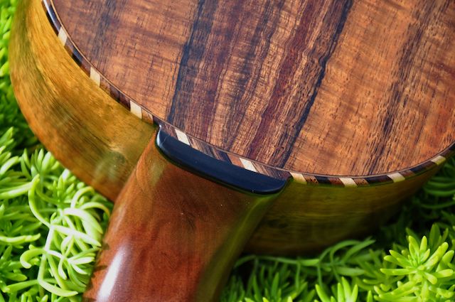

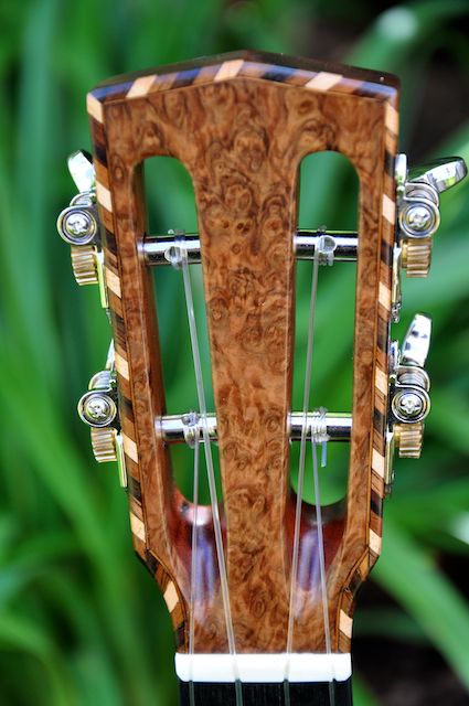

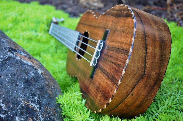

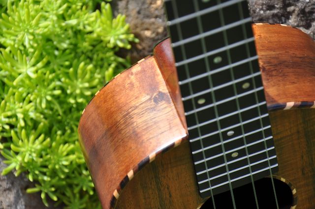

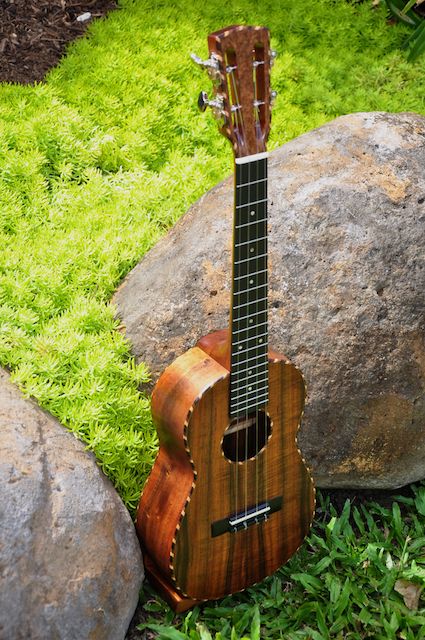

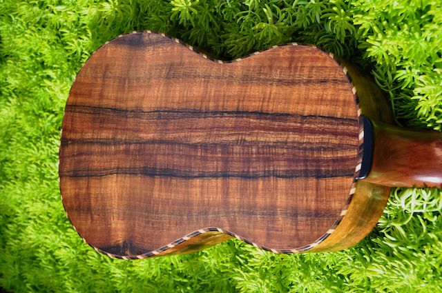

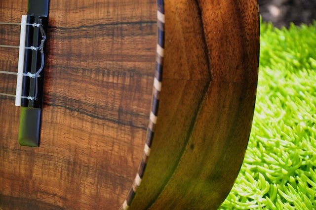

Here's one I've managed to get done in time for display at the upcoming Cairns Ukulele Festival in a few weeks time.
Koa is from the same sets of orphaned guitar backs I've got. This time I pore filled the Koa before finish. It's a bit more of an upscale instrument so finish needed to be a bit more refined. 30% gloss Mirotone. Less is more with this low gloss finish. If you start to pile it on the matting material makes the finish cloudy, so this has 3 thin coats sprayed on in the morning. Weather was fantastic that day. Then late in the afternoon a light rub back and another coat. Job done.
Carbon Fibre reinforced neck, CF bridge patch and 5 small fan braces. Head plate is a slice of burl that Tim Spittle had on offer to the forum last year, and is the first time I've got to use it.
Entire instrument is assembled with 315 HHG. I love the stuff.

You've done it yet again mate.
Lovely work, great match at the tail & you got to be proud of the heel binding integration.

The "rope" combines perfectly with the top and back wood.

Looks great Allen. I do like the slotted headstock along with the rope binding and the burl. Look forward to a first hand look at this one in a few weeks.

The rope bindings combined with the slothead and flat finish create a look of class and indeterminably age. I believe the burl on the headstock is York Gum...York is an area 'just' north of the furthermost reaches of Perth's northern suburbs.

It looks better without a butt strip too Allen. Those stripes line up perfectly.

Very very nice Allen, that wouldn't be a bit of black butt on the headstock would it?

Thanks everyone. I don't have a clue as to the species of the burl. Just something Mr. Spittle was offering up to us a year ago. Kim probably has the best informed guess as he's in Tim's shed more than me. I had some sent to Lillian as well, so if you're looking Lil, that's what it's like under finish.
And I have been practicing that butt join after seeing a couple that Nick posted some time back. I was amazed at how well he did them and I wasn't going to let some Kiwi have one over me. Especially one that drives a lime green commodore.:mrgreen:

OK, may be "I believe" was a little too soft...It IS York Gum Burl. :)

Think you've manage to better me there Allen. Very classy instrument all round, right from the tip of her lovely burled head right down to the tight join in her bum :wink: I'm not usually a fan of the traditional rope binding but this wooden one just fits in so well with the Koa around it & is, in itself, an attraction (along with the koa's figure). I also got some of Mr Spittles York Gum burl & I've seen it on your last two builds, I'm busting to build something to put it on now! It certainly looks the dogs bollocks 8)

Very nice Allen. Do you have any progress pics of making/fitting the rope binding?

Post by Allen » Wed Jun 29, 2011 6:35 am
I didn't make this binding Matthew. It was a custom order from Gurian. The binding is a real pain to bend by hand. I found that if you do it in the bending form with blanket that it goes really well. Then to get the pattern to line up at the tail block and heel are the only part that is tricky.
