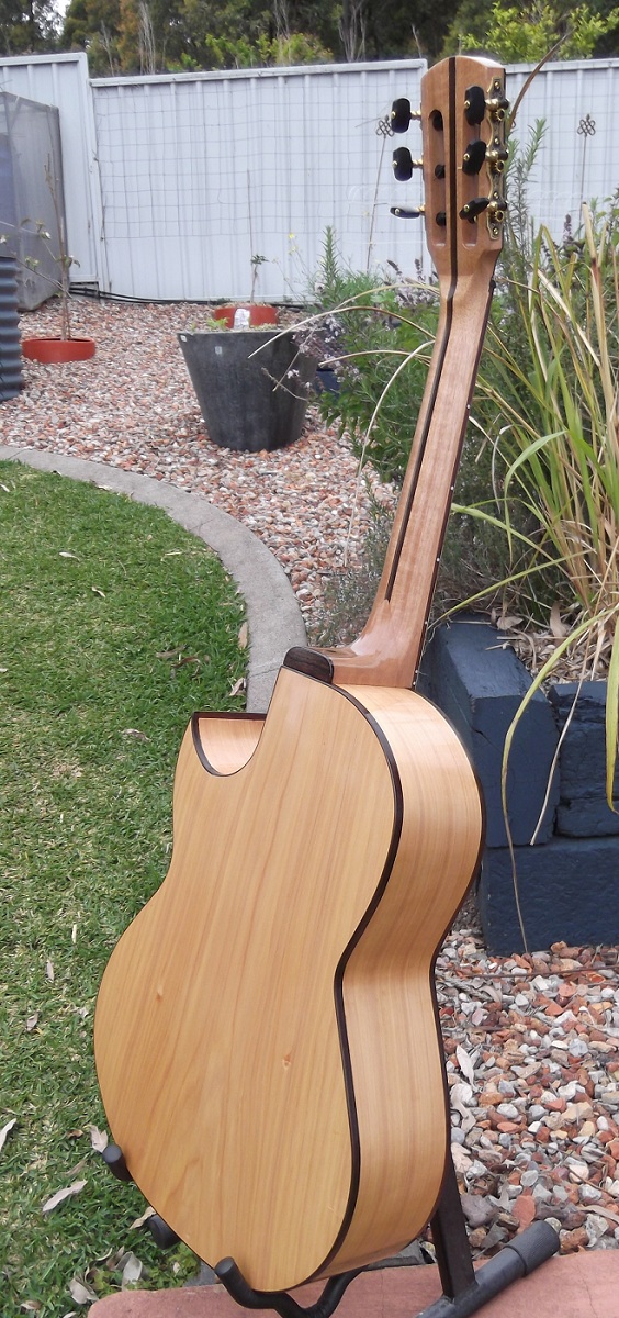

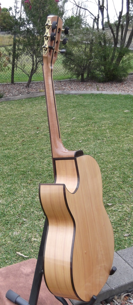

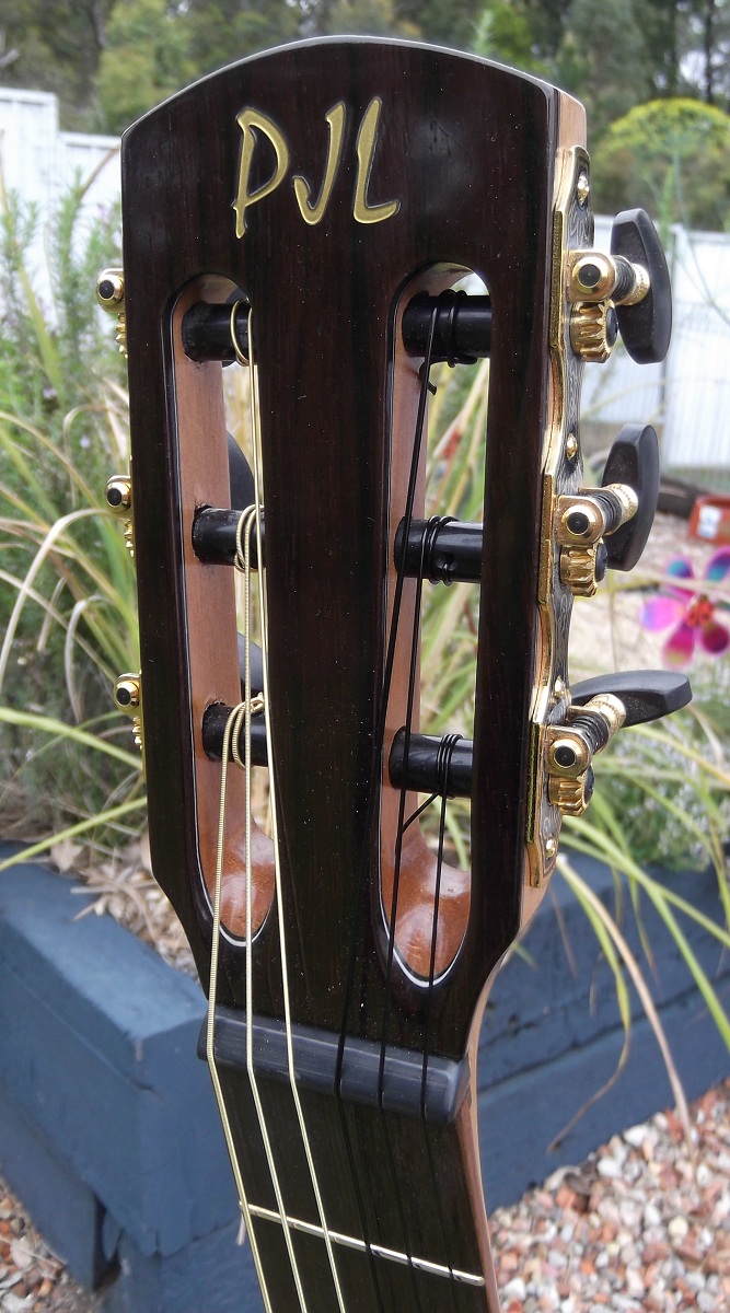

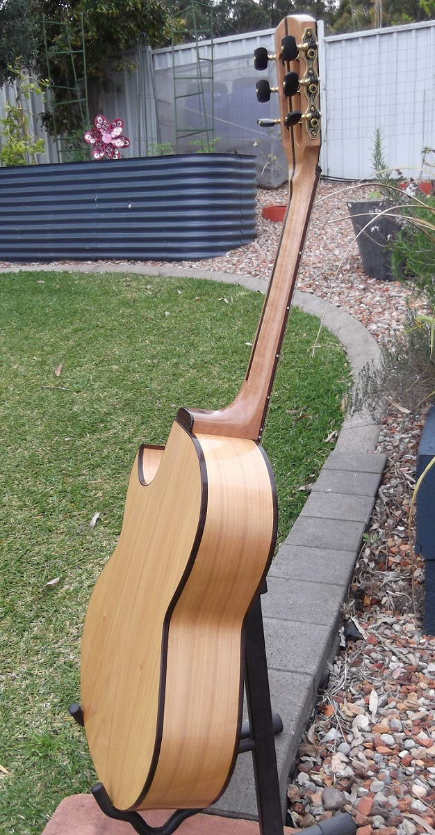

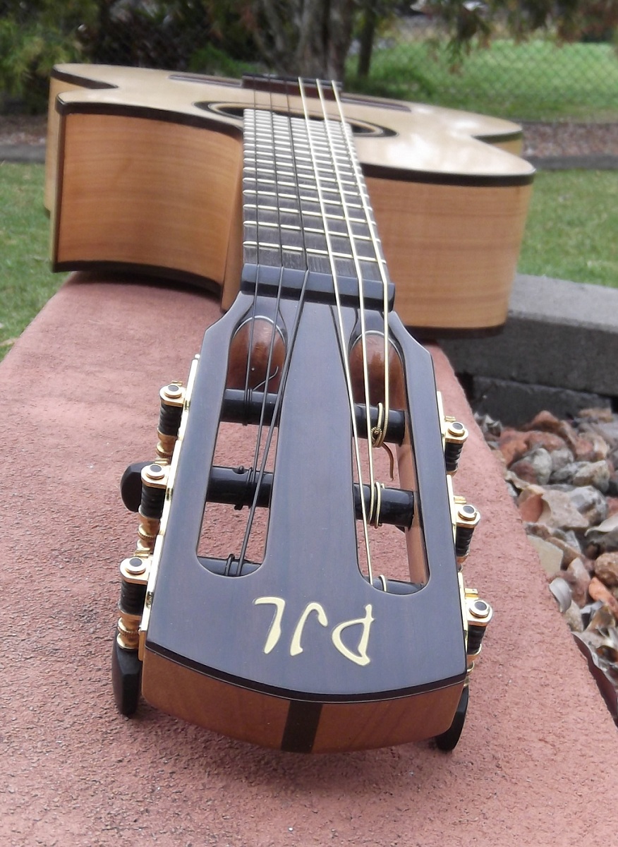

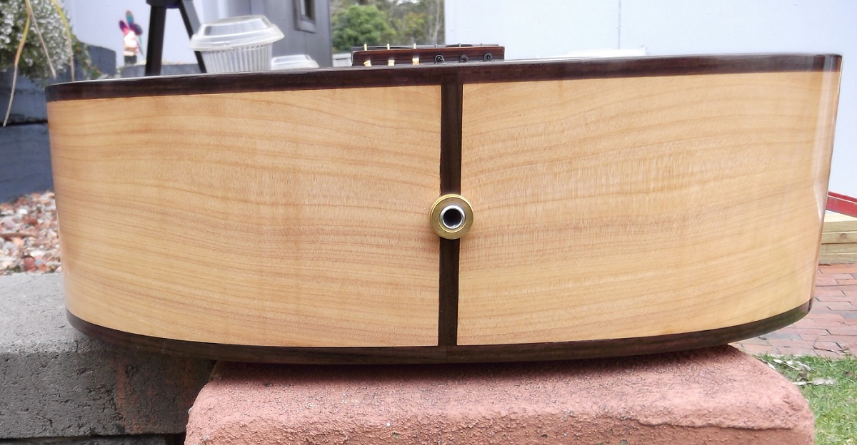

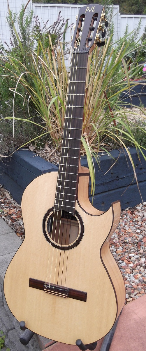

Hi All,

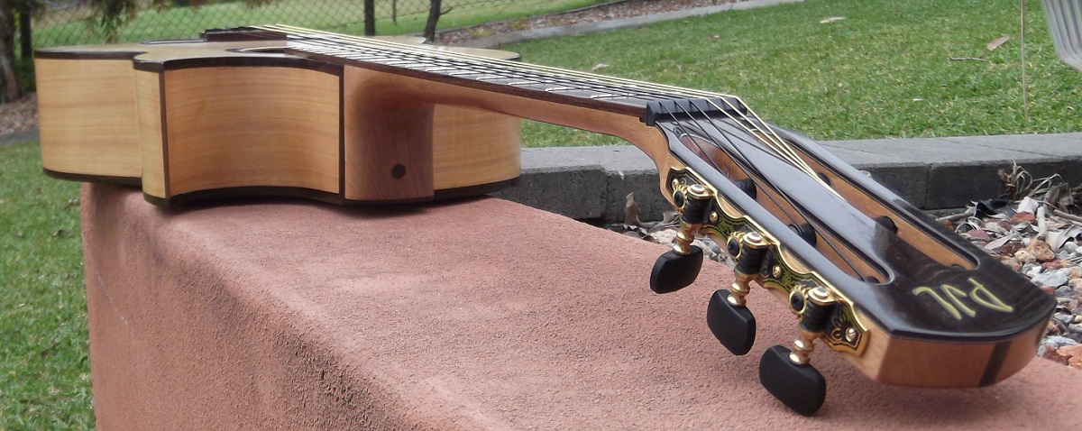

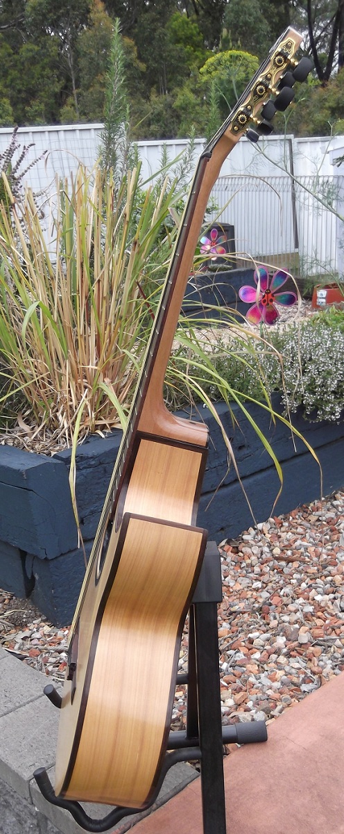

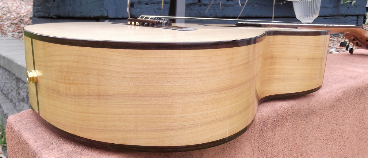

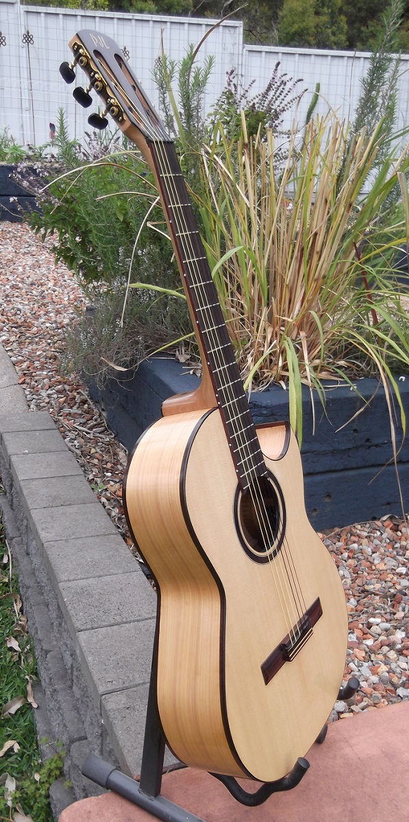

This is My first Nylon , it was a Steep learning Curve, Although I did have some Guidance from my mate Justin Montifiore. It was made for the same guy who I made the black and white Tele (guitar , not TV set) :? for , his brief was," I hate the feel of all the Nylon's I have tried, I hate the Look of all the Nylon's I have seen, I want it too feel like a Steel string in terms of the neck , I want it to look different from a Normal Nylon , I want to it to have a Pickup that reproduces the sound of the guitar , not the strings , and I want it to be Cutaway" . So This is what I have come up with, I used a plan as a rough guide , It has Falcate Bracing , but instead of a Transverse brace , It has a plywood ring around the soundhole that blend's up into the sides and becomes part of the neck block , It then has a Transverse brace that is 10mm down off the soundboard that supports the soundhole ring, and is attached by small blocks to the sides at the waist , with flying braces coming off that junction back to tailblock , Think Smallman meets Gore. the linings around the top are Laminated , the Neck is Bolt On , Bob Connor Style . The back and Sides are Monteray Cypress and the Top is Sitka , the Neck is QLD maple with a Rosewood lamination , the Binding's and Headplate are also EIR , the Pickup Is the K&K Ultra Pure active . It took ages to Complete and has caused it's headaches , But I'm well chuffed with the final result , as for the Sound I have nothing to compare it with , So i'll take it for a visit to Jeff and let him give his Critique, but for my money it sounds pretty good .

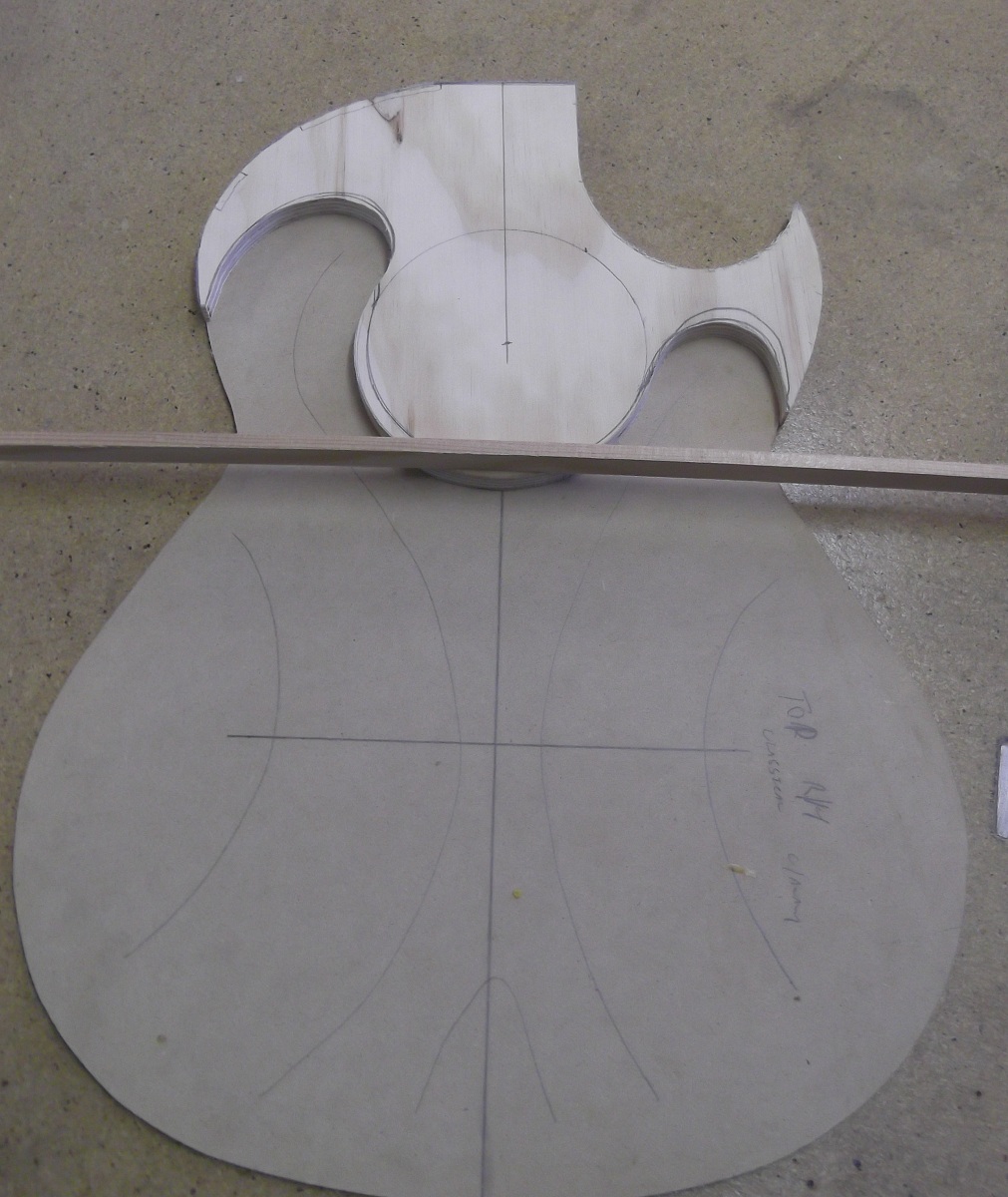

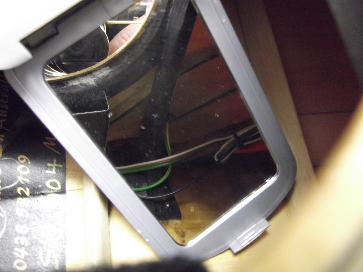

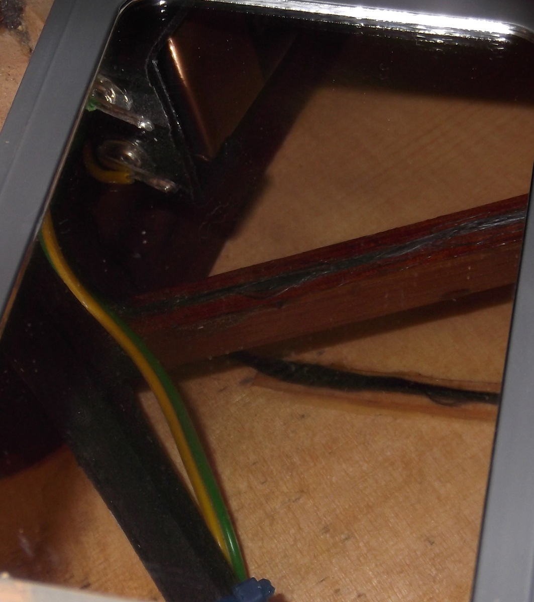

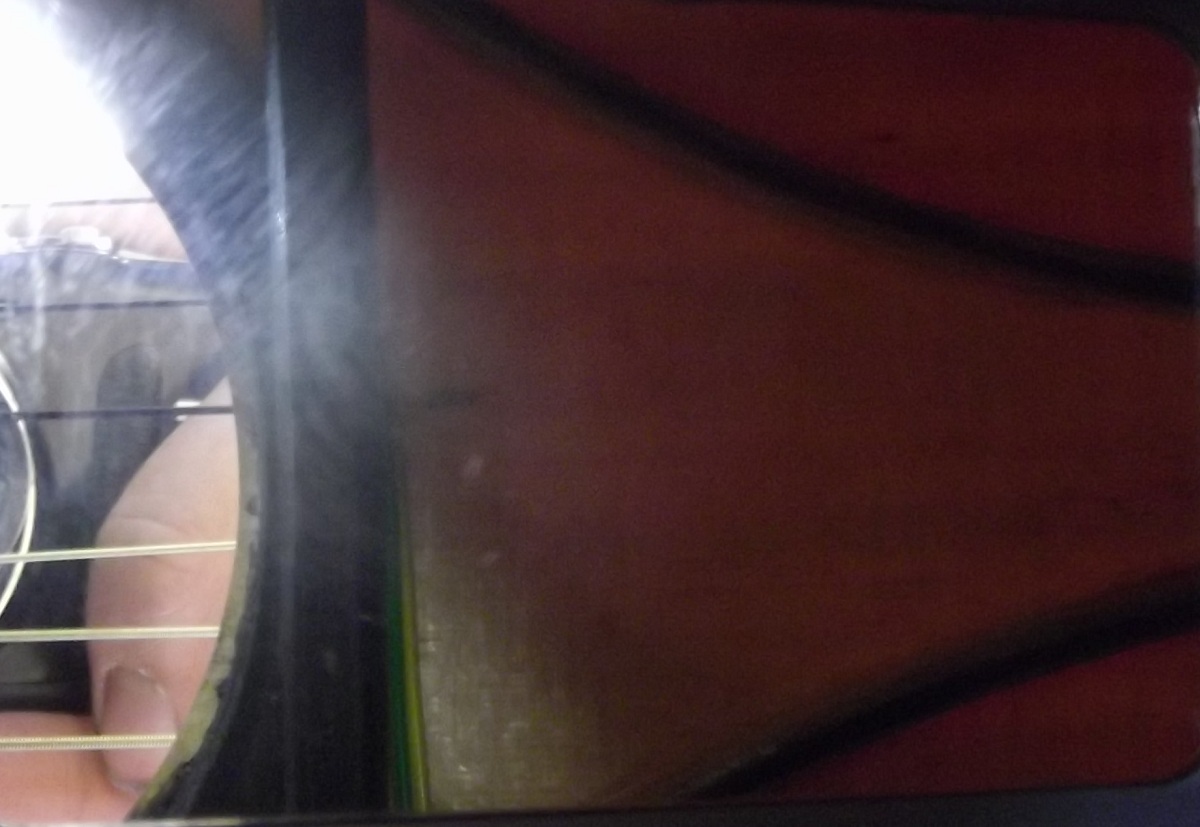

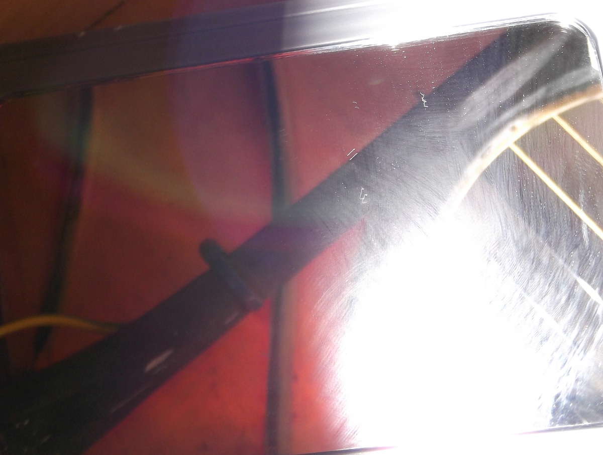

Thanks for your generous Praise , I have a photographic memory , so It often never Occurs to me to Take Construction photo's , Now after using a makeup compact and a shitty camera I wished I had , So it's the best I can do, Sorry , But I did a Mock up using a MDF template, a "Opps I F#@* that up" soundhole support and a peice of Bracing to give you the concept !!! :oops: :oops: :oops: .
my very poor mock up , with penciled in roughly, Falcate bracing.
Sound hole support and T. V . Brace Junction , the T.V. Brace sits down about 12 mm from the Sounboard and clears the Falcate braces by about 7-8 mm
same again different angle.
The junction of the suspended Transvers brace, the flying brace going back to the tail block and the block , attachted to the waist, with some wiring attatched.

Congrats on completing such a wonderful guitar Paul . Not often we see a florentine on a classical , but why not ?.
Your Smallman meets Gore bracing set-up looks interesting . Wish I could hear it ,or better still ,play it. Love the wood choices too. Blondes have more fun right ?? Great work Paul.

Well having played the guitar the other day, I can say Paul has certainly achieved his design goals on this.
It's a beautiful instrument as you can see.
Playability is fantastic, with the neck width, thickness and action closer to a steel string than to most classicals.
Sound is clear,full and even with a lot of sustain, more classical than flamenco.
Plugged in the sound was very natural, but with enough bite to cut though. definitely no UST twang with the K&K's and could get to quite high levels without feedback.
The new owner should be delighted.
