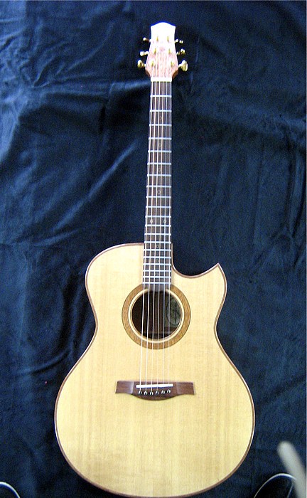

Adjustable guitar complete
Posts: 1086
Location: N.S.W. in the bush
Post by Craig » Thu Oct 06, 2011 9:29 pm

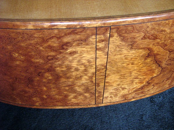

What an amazing level of detail Craig...nothing loud, just pure class. The binding and purfling work is beautiful, shows off your skills well but the wood if left to do all the talking, and I 'really' like the purfling detail on the headstock...Unique, stylish and outstanding work mate, congratulations. :cl :cl :cl :cl :cl :cl

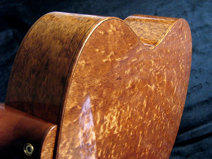

"All the Details " you say......... well that may take some time , but I'll make a bit of a start.
I bought the wood as Pommele figured African Mahogany . I thought it was busy enough on it's own without adding to it , so tried to keep the appointments simple by making the bindings,purflings,rosette, headplate, endgraft and soundhole binding with the same wood. I'm pleased with the look it's achieved .

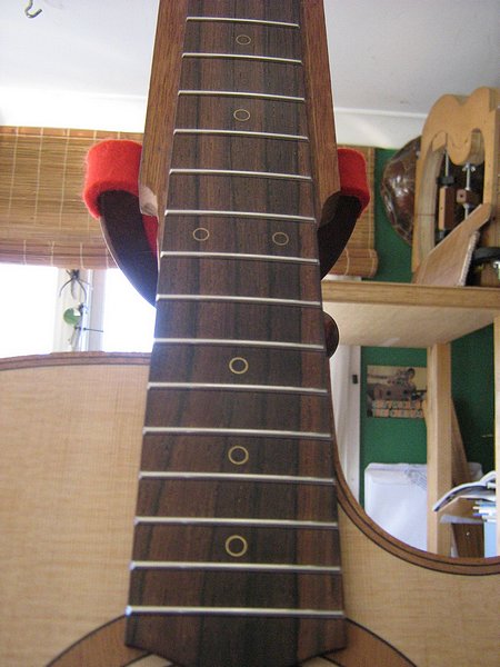

Like wise with fretboard markers and bridge pins,,,keeping it minimalist, although they took a surprising amount of time to make. Fretboard pic here before finish on the guitar

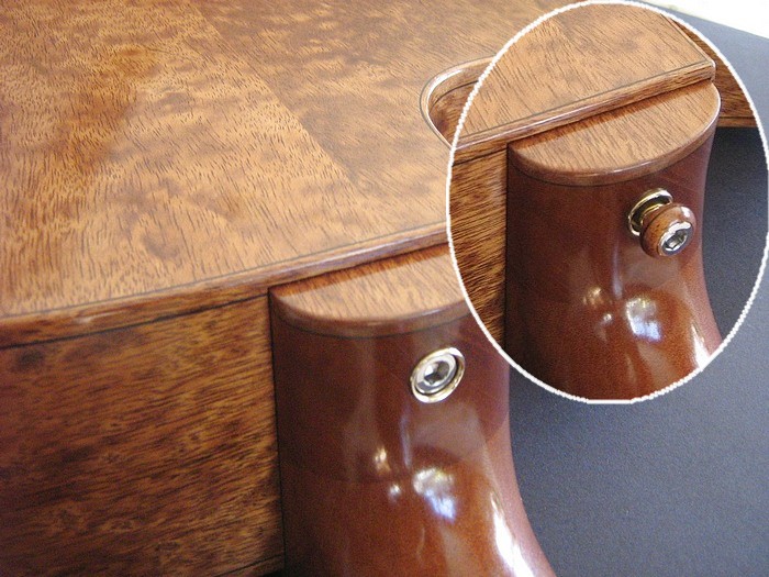

And the bridge pins to match :

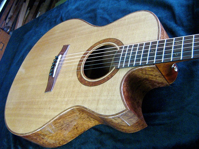

Onya Christian. O.K. a little more ....

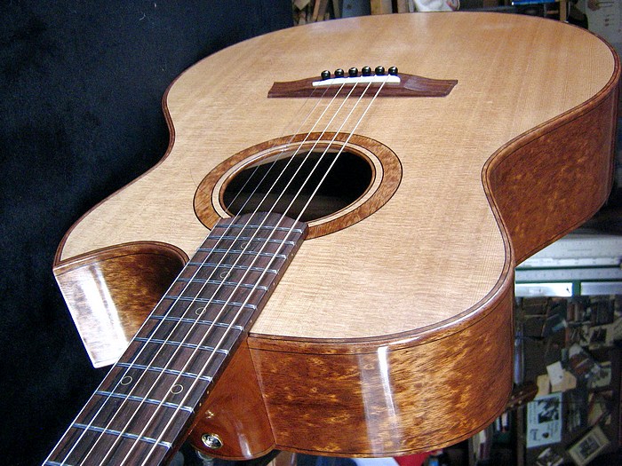

The finish is french polished Shellac ( hardened shellac )

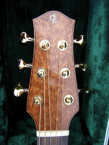

I fitted stainlesss steel frets. I like the wider crown width of .095" . A first for me but will now be my standard.A little harder to fit and tougher on your files etc., but well worth while in my book . As far as I can see , they will last a long long time before ever thinking of refretting .
The adjustable neck means no future neck resets either.As you can see I have longevity in mind .

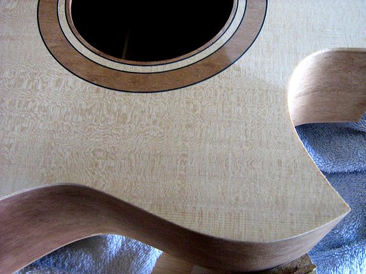

The unbound florentine cutaway mitre was achieved by stacking both the side and cutaway pieces on a shooting board ( as you would do plate joining ) I used a block plane which I had set on the correct angle to suit . (This was done prior to bending of course ) This picture taken prior to binding and finish

Thanks a heap Nick and yes that spruce ( Sitka ) is a mind blower . A huge thanks to Gerard Gilet who hand selected it for me many moons ago.That silking was more noticeable before applying the shellac finish :

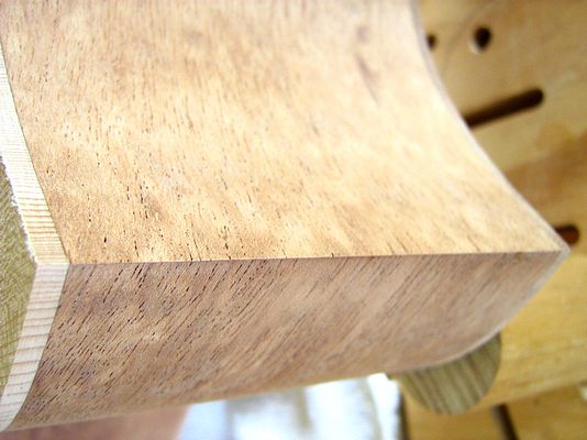

Post by Allen » Fri Oct 07, 2011 5:42 pm
Am I the only one left wondering how the hell you kept those mitres so nice after bending? I would have thought that wood with that type of figure would want to move all over the place on you.
christian
Posts: 338
Location: Bay of Islands NZ
Re: Adjustable guitar complete
Post by christian » Fri Oct 07, 2011 6:56 pm
Hi Allen, I'm not sure how Craig achieved his perfect mitre, but as a bit of a mitre fanatic myself, I found the trickiest part is getting the two cutaway cut angles just right,(usually achieved with a file) but once I'm happy I just glue and stretch my tape to pull up the mitre snug, you can also bruise the mitre by lightly by rollling a screwdriver shaft over it, this forces the fibres together, the beauty of a mitre you have the luxury of scraping or sanding either side of it if it doesn't quite marry up perfect.
hope that helps,
Christian.

Allen wrote:Am I the only one left wondering how the hell you kept those mitres so nice after bending? I would have thought that wood with that type of figure would want to move all over the place on you.
Wonder no more Allen . As I said in an above post . I stacked the two pieces on a shooting board . Planed them on the correct angle to suit that florentine mitre angle ( Before bending ) I didn't file ,or sand or 'bruise' the mitres as Christian suggests. All done with the block plane .
I hate to force anything. Having the pieces a perfect fit to begin with is half the battle done . Edge tools give a far crisper result . You're right Allen about this Pommele figured Mahogany not really wanting to play ball . It was a case of careful planning , lots of patience , Holding your mouth the right way. Seriously though , it was a case of a well thought out plan where I could clamp the ends to the corner block . A time when you wish you had three hands . It was tricky ..... .
Also , what you may not have noticed is that I pulled in the upper bout on the treble side about 10 mm. from the template line ( asymmetrical ) to give a much more groovy florentine .The smallest change to the template line can make a world of difference . Here's a poor picture but shows what I mean. I've been calling it a "Tucked " Florentine .

That pull-in on the cutaway looks better than the "normal", subtle but definitely an enhancement.
Difficult to tell from a pic, but almost a 90 degree?
I take it you had to make a side mold specially for that side?

Craig wrote:Also , what you may not have noticed is that I pulled in the upper bout on the treble side about 10 mm.
Yes, of course I noticed that kink in the upper treble bout but I thought it was just a mistake! :mrgreen: :toi

Hi Colin , I played around with outline shapes for quite a while before deciding on what I've called this "Tucked " Florentine. It just looked so much better . A cutaway on the template line tended to look like a guitar with a bite taken out of it :lol: . The shape didn't flow quite as well. As I said above , it takes only a tiny amount of change to your template line to make a world of difference to the overall shape , look and vibe of the instrument.
I can't quite remember what degree the tip was Colin but I'm pretty sure it wasn't 90. No I didn't make a special mould for the Tucked cutaway . I just added a 10 mm. shim right at the cutaway point ,into my existing outside building mould . I did have to do an extra bit of bending to the treble side on my hot pipe for it to conform to the new "Tucked" shape .
