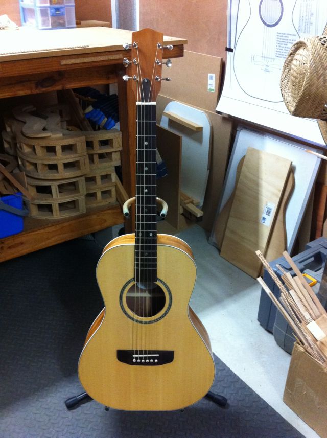

Just finished two guitars. First one is Lutz Spruce, Goncalo Alves B&S, QLD maple neck, rosewood fretboard and bridge. Body size is modeled on a Tanglewood TW45 body size, (think mini jumbo/folk). I started out to make a baritone but when I was measuring up to fit the neck realised the bridge plate was too far forward - doh.

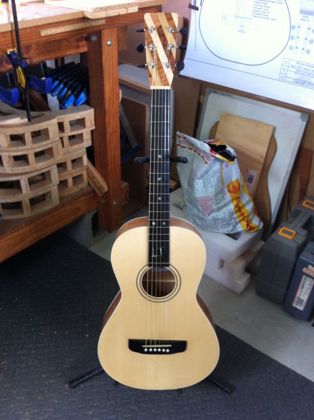

The second is an "O" that I helped my son build. Lutz spruce, QLD maple B&S and neck, ebony fretboard and bridge. He is as proud as punch and deservedly so. Its a little ripper of a guitar. Got the idea for the headstock veneer from Alan the Ozzie Bluesman - thanks mate :cl
Both are bound with plastic and are a bit dodgy. I really need to get a jig to cut the grooves parallel to the sides. The tops are OK but the bottoms near the neck join could have been better. Live and learn.

The first one. Don't mind the look of that Goncalo Alves
My lads first guitar ( and me thinks he's hooked)

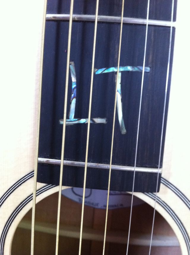

.. and of course he had to have his initials in the fretboard

Well I had the privelige of seeing, playing and hearing both these guitars yesterday. Both ripper guitars especially the parlor. It has nice bass response and sounds very sweet. Such a great size to pick up and play at anytime. The mini jumbo with its larger body has a bigger tone and both the Lutz tops have that lovely silking. Full marks to the young fella for his workmanship and patience. Good on ya Dad for showing the young fella the ropes.

Re the Goncalo Alves. Burdekin Plum is a very close timber in weight, colour, figure and close grain.
A customer once brought me some B Plum for a job and I was surprised at how similar it was to Goncalo Alves. I have a mallet that I handled with GC for comparison. I did a search and they're not related. I wasn't in to luthiery at the time, so I didn't check for any tap tone.
