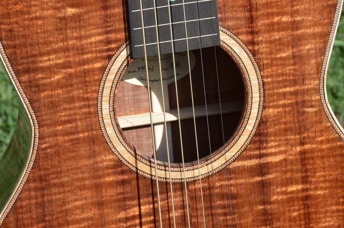

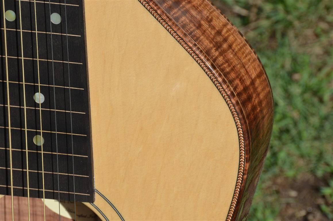

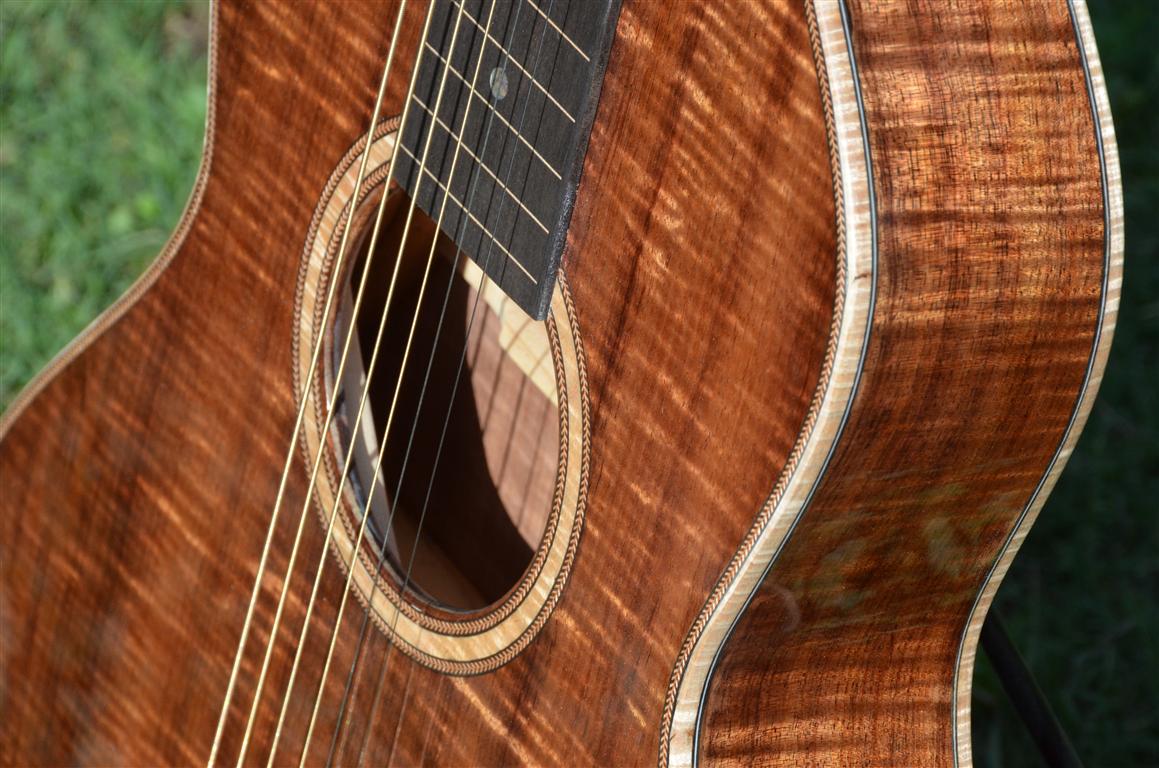

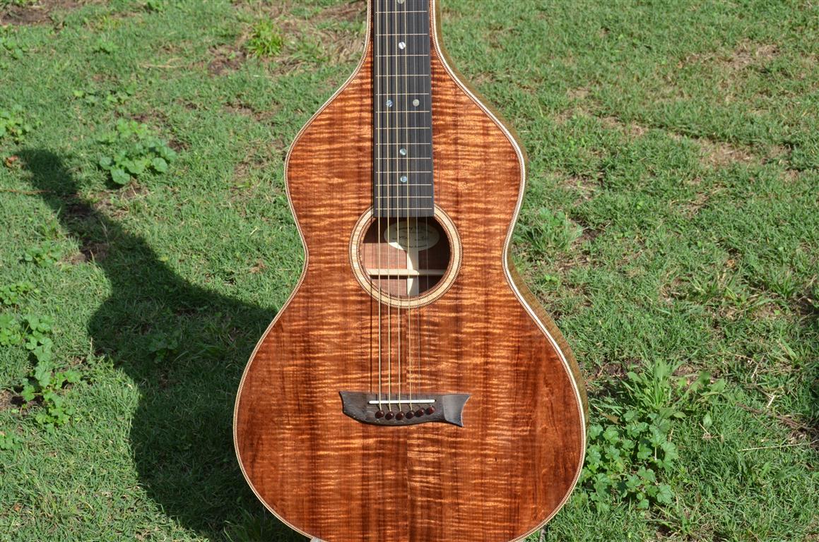

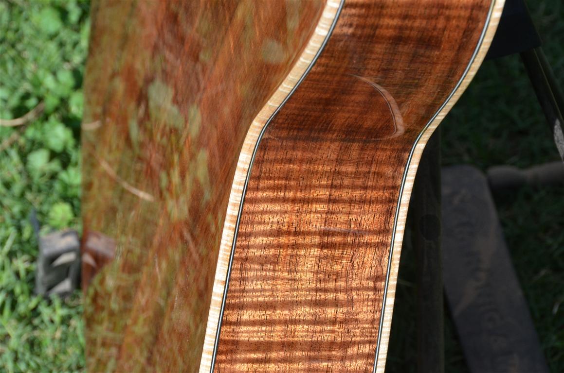

Well the Port Fairy Folk Festival is on next weekend and I've been slaving over a hot buffer to get these two ready.
The strings went on this afternoon but they still need a final detail before showing them.

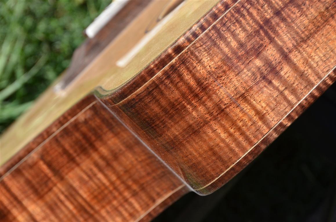

First one is all Blackwood (including bindings) with a Brazilian Rosewood bridge and Honduran Rosewood bridge plate ( pluce Red Spruce Braces the only exotic species in it.
The sides are laminated (2 ply) and the bracing is X braced with lattice bracing in the lower bout. I didn't tuck the lower ends of the X brace in these ones.

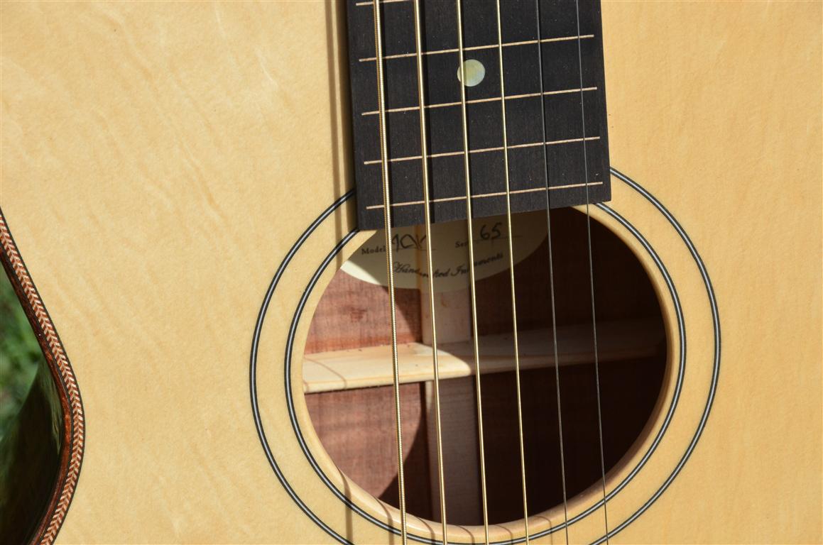

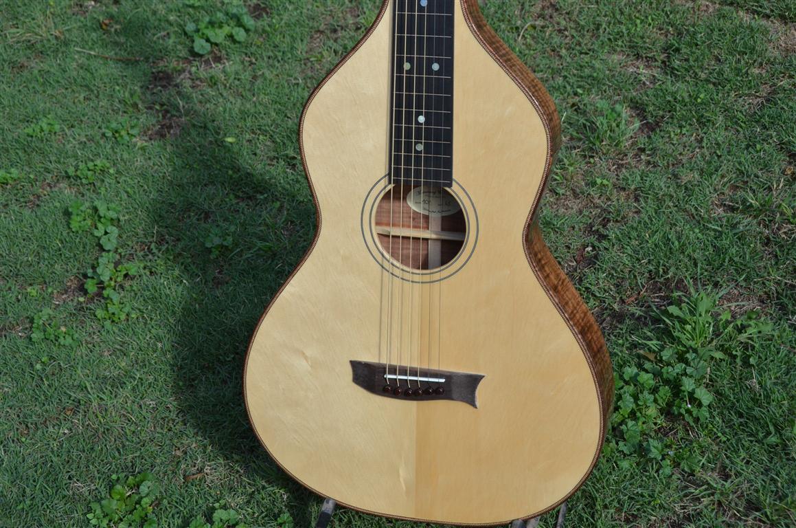

Second one has a Huon Pine top with whitebait figure and the back and sides are Blackwood from the same billet as the other
They both sound fine to me both still a little tight. They'll open up over the next day with some playing and the Huon will sound great in around 6 months teh Blackwood one in a few years. :)
Anyhow thanks for looking here's the pics.

Really great work Bob , as beautiful as they both look , what I cant get over is the use of the Blackwood for the binding on the first one, It must be the sap wood? It looks great, I would think no one would ever guess it if you asked what it is .

Your Binding and herringbone purfling on the Blackwood model was a perfect choice . Incredible bit of Blackwood too !!
The simplicity of the Huon pine model is also a class act. Beautiful work Bob

What do you think of Huon for a sound board? I've got some pieces here but am a bit uneasy on using it. It doesn't tap all that great.

Allen - This is the second Huon Pine topped Weissy I've built and I think it sounds great. (for Weissenborns anyway) Tim Spittle stayed with me recently and he was surprised at the sound of the Huon one I had already built.
Mind you there is a lot of variation in Huon Pine and the stuff I've got is comparatively light and not too oily. If you look closely there is figure through it that looks like whitebait swimming up a river. I was told by Chris Searle that this type of wood comes from a plateau up behind Strahan and the wood from there is quite light in weight. I don't see any reason it wouldn't work for a steel string - don't think that a uke would drive it though.

I'm in Blackwood heaven! Great looking Weezy's Bob and the sapwood bindings look the dogs bollocks. Pretty figuring on the Huon too, the stuff I've seen was very bland & uninviting but this looks great. Don't need to sound good, looks alone make them a winner. :cl :cl :cl

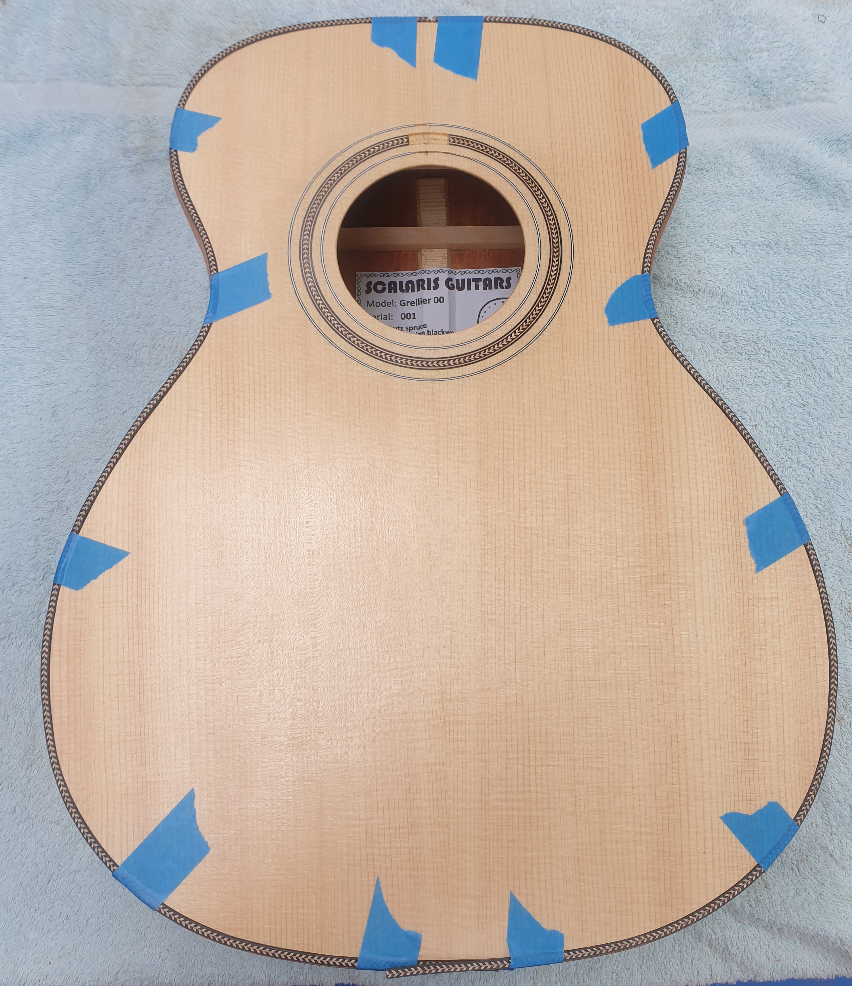

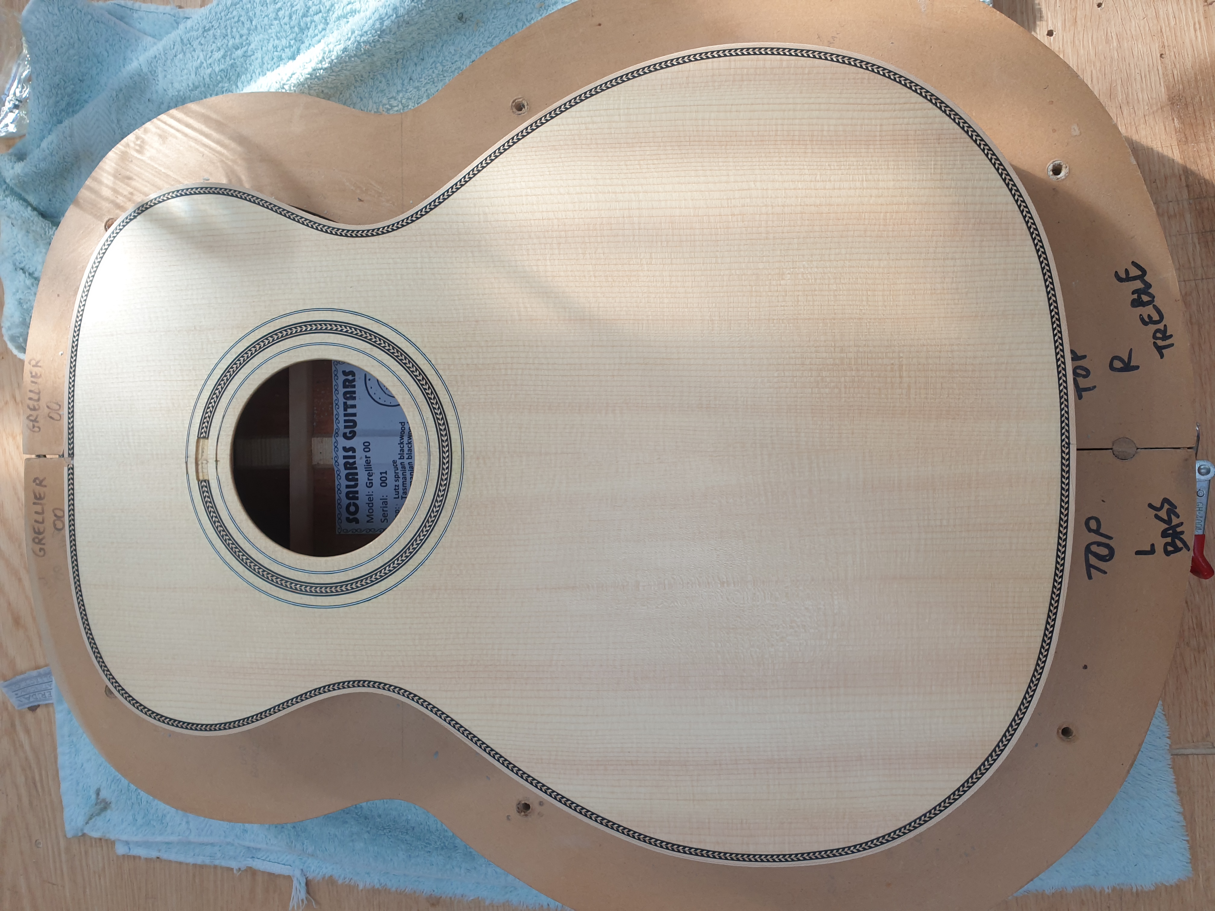

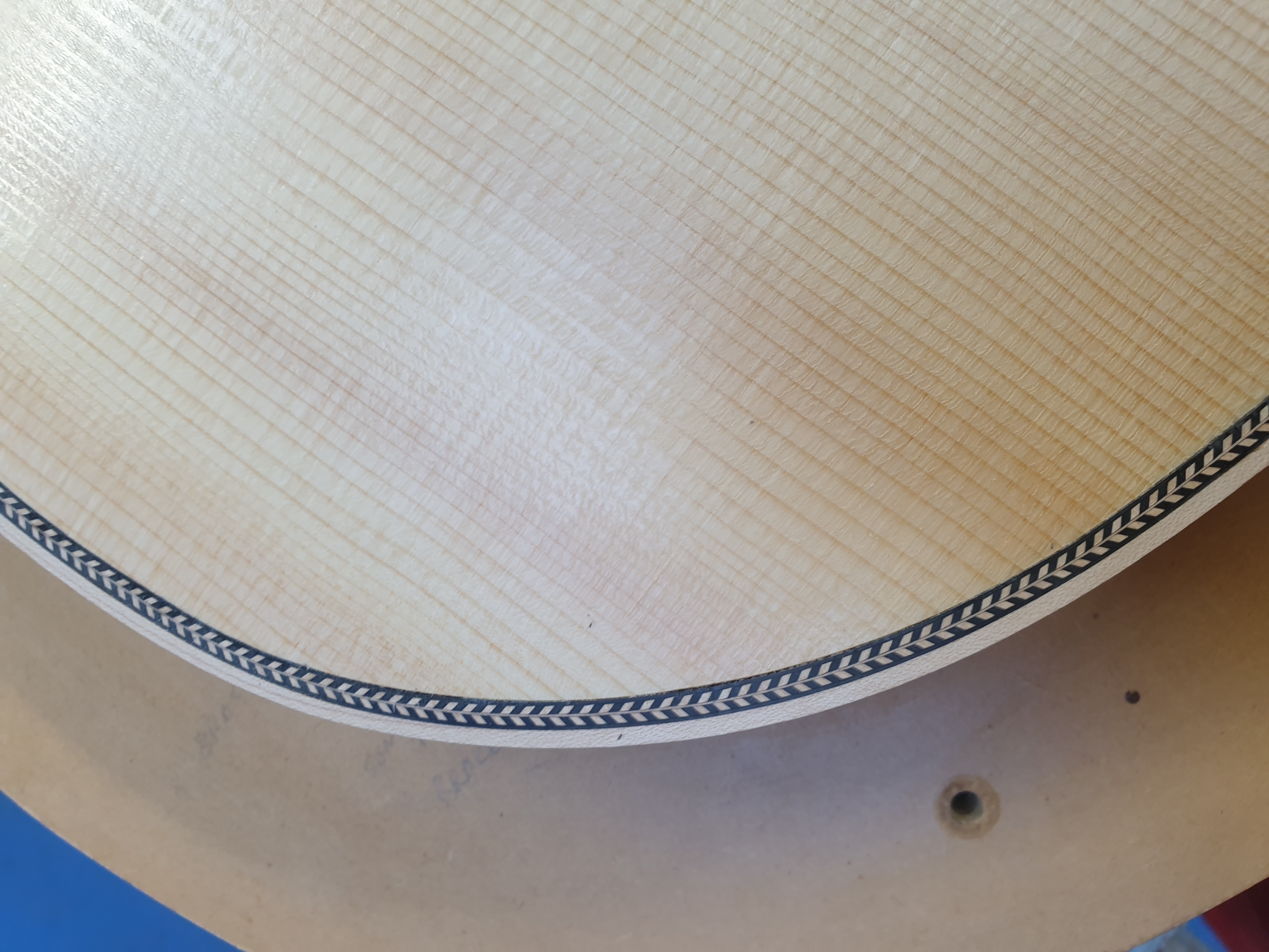

I've reached an impasse on my first build (going very sloooowly) with the herringbone purfling installation. It's a Grellier 00 Lutz top Tassie blackwood back and sides. The binding and purfling channels are finally cut and cleaned up. The binding and purfling have been bent in the side bender but will need to be touched up on a hot pipe bender.
My question is do I glue up the herringbone purfling separately or together with the maple binding. Here is a photo of a dry test of the herringbone - it looks ready to glue up. I intend to use original Titebond painted on the channel and tape it down with fibre reinforced tape unless 3M blue auto tape is plenty strong enough. The body has been shellac-ed to reduce tearout and the tape ripping out fibres.
Note, I try and follow the G&G bible whenever I can which does say to glue BWB purfling and binding at the same time but there isn't anything on herringbone or similar.

I decided to glue in the herringbone purfling first and the next day after cleaning up the binding channel for any glue (very little) did the maple binding. The purfling turned out surprisingly well given the small number of gaps in the back. No fixes required. The maple binding installation turned out well too.

Your L-00 looks great, and very nicely turned out for a first build. The lutz and maple bindings look lovely with the herringbone. Very nice scheme. The main trick with using herringbone is to pre-bend it, but then it is very easy to install. It is not hard to do it at the same time as the binding - probably easier than trying to wrangle multiple strips of bwb at the same time as binding.
