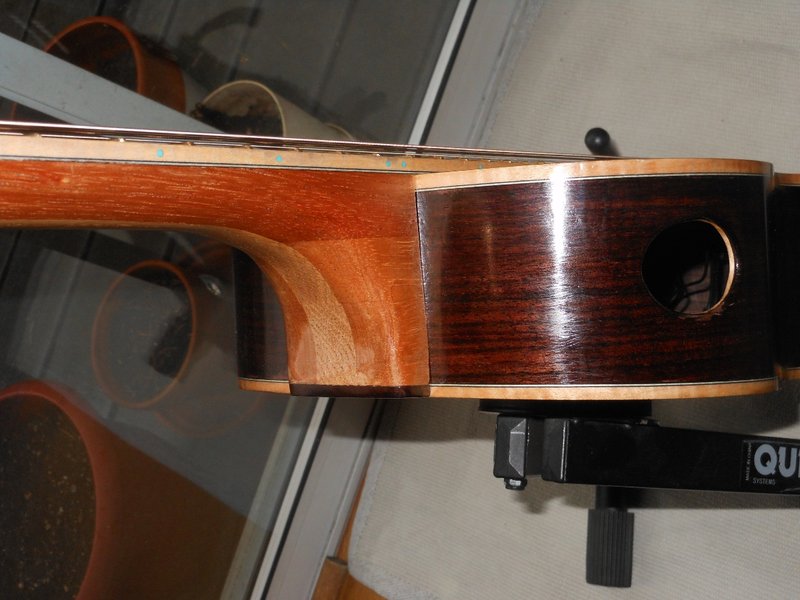

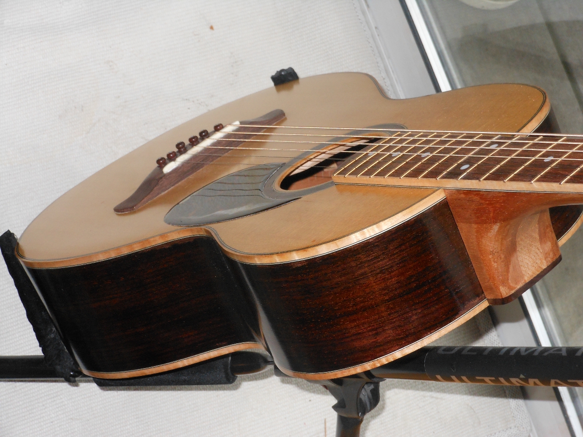

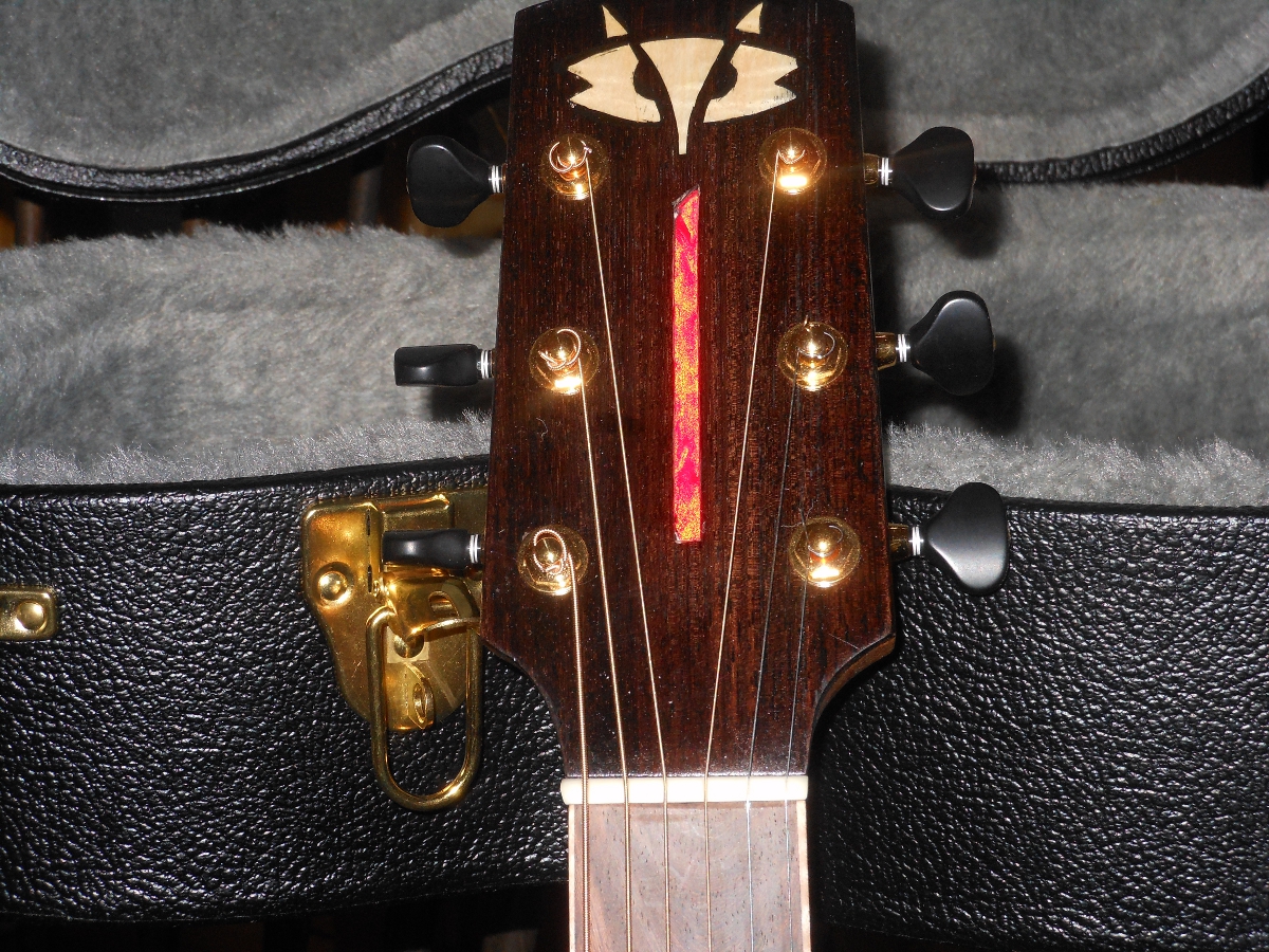

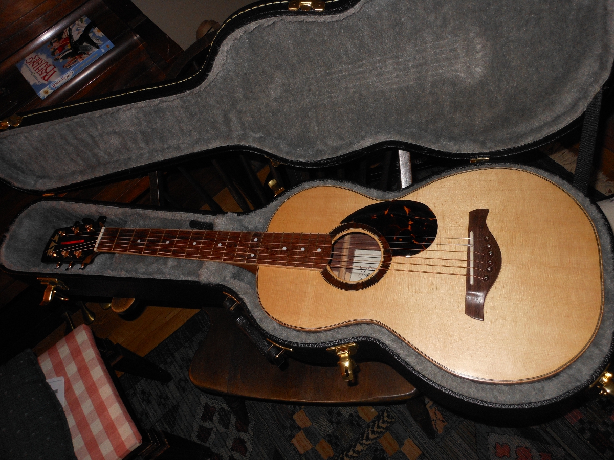

Finished #3, a parlor for my six year old grandson. This one sounds better than the first two, and is the first one where I am even remotely pleased with the finish.
The Specs:
Top: Sitka
B/S: IRW
Neck: Spanish Cedar with an oak center lam
Fretboard: Madagascar Rosewood
Frets: EVO
Headstock decoration: light saber. He's six, what can I say?
Rosette: Left-over rosewood from my second guitar's back.
Finish: Tru-Oil

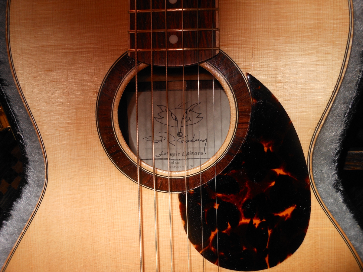

The wires you can see through the sound port are a set of K&K minis.
Thanks for looking.

How did you come up with the size of the sound port and did you use a patch to support it inside the guitar?
Where did you buy the case for it mate and how much?

Thanks folks!
It's a 24 inch scale. I wanted it short so it would be easy to play for a child, but long enough to stay in tune.
I got the case from FineCases.com (http://www.finecases.com/canadian-case- ... -case.html). It ran me US $110 plus shipping. They were prompt and had the case to me in just over a week.
The sound port started out much smaller (I used an off-cut from the soundboard to reinforce the port). I enlarged it a little at a time after stringing it up (but before doing the finish) until it sounded right to me. Someday I'll learn the math and just do it once
. Then I took the bridge off and did the finish work.
--Paul

How did you apply the tru oil ? was it brushed ? or hand rubbed ?

Hey Todd -- I hand-rubbed the finish. 25 coats (and wasn't that fun...much easier than french polish, though). Tru Oil's only flaw that I can identify is that it really stinks up the house. Even with the door to my workshop closed, and the outer door open to vent the place, upstairs, the cats were trying to figure out how to open the sliding door and escape.
