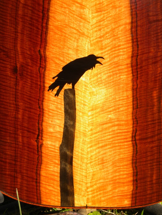

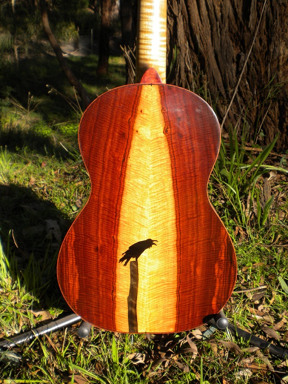

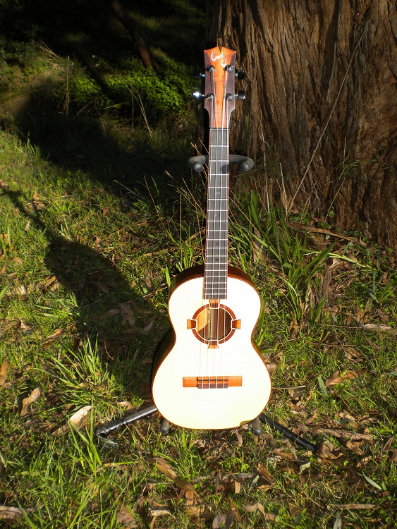

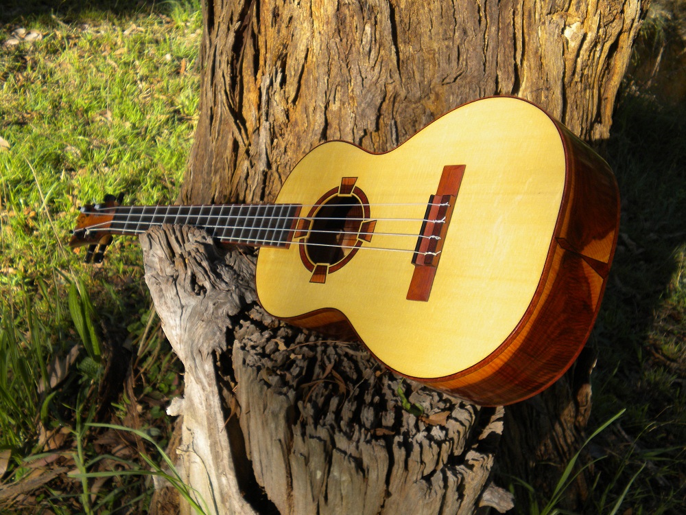

Here's some photos of one of my recently finished stringed things , a baritone ukelele , which I've ( for soon to be obvious reasons ) called the Raven .
The build is as follows :
Back and sides - Boonaree . Alectryon oleifolius . This awesome fiddleback Boonaree is from a tree I sourced near Wilcannia N.S.W.
Soundboard - Engelmann spruce . Some really bright split billet stuff I got as swapsies from Jack Spira .
Neck - Curly maple . From Alestair Boell from the Melbourne guild of fine woodwork .
Fingerboard - Pacific Blackwood . Xanthostemon sp.
Bridge - Scentless Rosewood . Synoum muelleriana . The bridge was cut from an old Qld forestry sample for which I had a double . Talk about rested timber , the sample carried the notes ; Atherton district 1948 !
Bindings - Hooked needlewood - Hakea tephrosperma . From a fallen tree that I sourced near Deniliquin . N.s.w . Black dyed swiss pear purfling lines .
Rosette tiles - Boonaree , Hooked needlewood and dyed Swiss pear .
Finish - Bleached shellac french polish , cut back with rottenstone and orange oil .
Nut and Saddle - Water buffalo horn from N.T.
Inlay - The Raven is Water buffalo horn , for those that have'nt worked with it , it's ability to hold detail whilst remaining flexible is stunning . The fencepost on which the raven sits is Ancient ged gum .
The verdict ; I'm super happy with the sound , much more small guitar than uke . It's full and rich with some really pleasing complexity .

To answer a couple of questions , the strings are Aquila branded nygut type . They took a full three days to stretch out , they now seem pretty steady staying in tune . I won't claim any real experience in the matter but the feel is acceptable , maybe a bit over sticky on the wound strings , the sound is excellent .
I'll have a go at some detail photos of the rosette . I'm embarassed to admit that it took near on three days to do the rosette , design included . The soundhole cut outs around the rosette tiles were particularly sensitive in the soft , white spruce . Give me hard , dark mean timbers for inlay work any day .

Great looking uke and beautiful wood! I like the bird on the back. Did you have to reinforce the back where the inlay is? How thick (thin) is the inlay? What technique did you follow to do the inlay?
