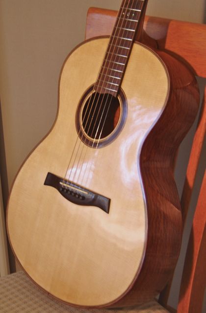

I actually finished this one before Xmas but a clapped out hard drive and a few other projects have put the posting on the back burner. Got a new IMac and in the process of learning to drive it I thought I would finally get this together.

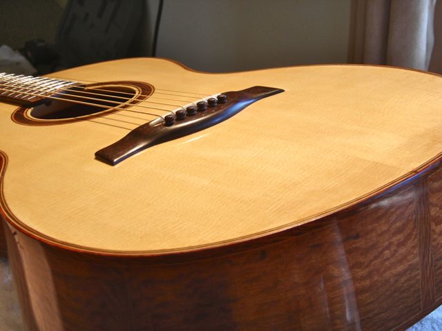

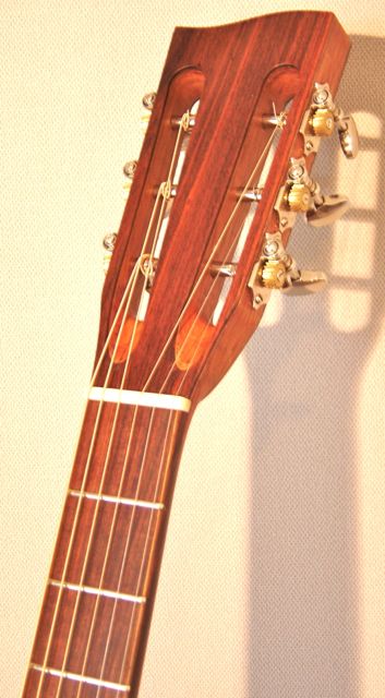

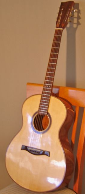

Last year I got Ervin's books and this guitar is in response to reading them, notably a lighter, more responsive top. It is my own design based on an OM. It is 20" in body, 15" lower bout, 95mm at heel and 105mm at tail. It has a 650mm scale with the design placing the saddle at the mid point between tail and upper transverse brace. The top is double X brace and the back is X brace lower bout with 2 ladder braces in the upper area.

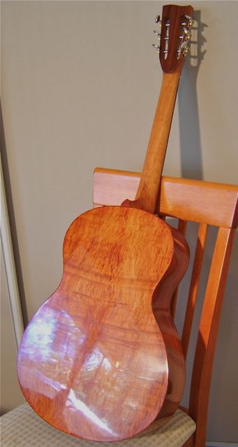

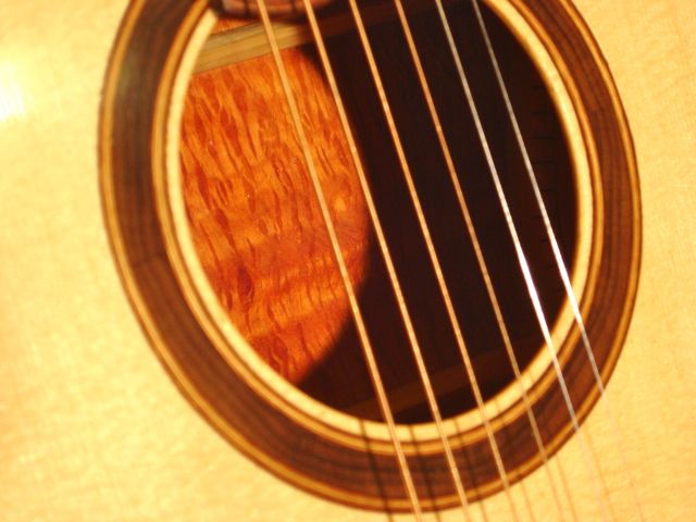

Again the wood is from Tim Spittle and is Lutz Spruce top, WA Sheoak back, sides and neck, Mulga head plates, fret board and bridge. The bindings are figured Sheoak, the rosette is Tassie Blacwood with all the purflings and head veneers being native Australian timbers blackwood, myrtle, hoop pine and Qld maple. The guitar has 28 and 15 ft radius.

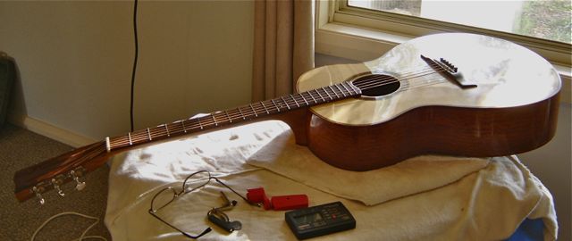

I had only just finished French polishing a few days before the pics were taken and on this one I used the U-Beaut Hard Shellac for the first time and while waiting for it to cure completely before buffing out I strung it up for the first time so when all has settled in I can pull it apart agin, buff the finish and then do a much closer set up and it has not moved since.
The sound is very strong and rich with good note separation. The thinner top makes it ideal for finger style but I don't think I would amplify it and play it onstage, not at any volume anyway.
The pics have got a bit of glare from the window, but you can still get a fair idea. By the way, I have since got Trevor and Gerard's books and already have the next one planned in the head, pretty much the same as this with a few alterations.

Archie it turned out a treat.

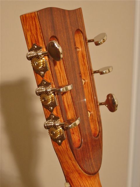

Lovely job there Archie, I particularly like the headstock with the blackwood / she-oak sandwich, looks very classy. I've got some she-oak from Tim for my next build and this is making me very eager to get going with it.

Lookin good there Archie and I'm sure Edith (pronounced Ead it) will approve. Have you Lacked up the inside or is it just an optical?
Re: Archie's No5
I like that a lot Archie. I particularly like the way the upper bout has nice rounded shoulders into the neck. So often you see that transition quite square and looking pretty industrial. Your's is very elegant.

Just got in from dog walking and have seen the comments. Thanks very much one and all. Yes Steve, there is a lick of plain shellac all over the inside, i think it just looks good. Alan, I love the rounded shapes in upper and lower bout which I decided to design into this one and it threw up a few extra challenges in block fitting as well as setting the neck but I am keen now to do the next with the hindsight I now have. Thanks John, this is the second Sheoak I have made and I have a couple of more sets ready to go. It is a bit tricky to work and needs a fair bit of pore filling but is a stunning timber that has ( to my ear) nice acoustic qualities. Tim has great timber for sure.

The slotted headstock sets the guitar off nicely.

I've often wondered why the interiors of acoustics have no finish. Does the finish affect the sound, compared to non-finished interiors?
