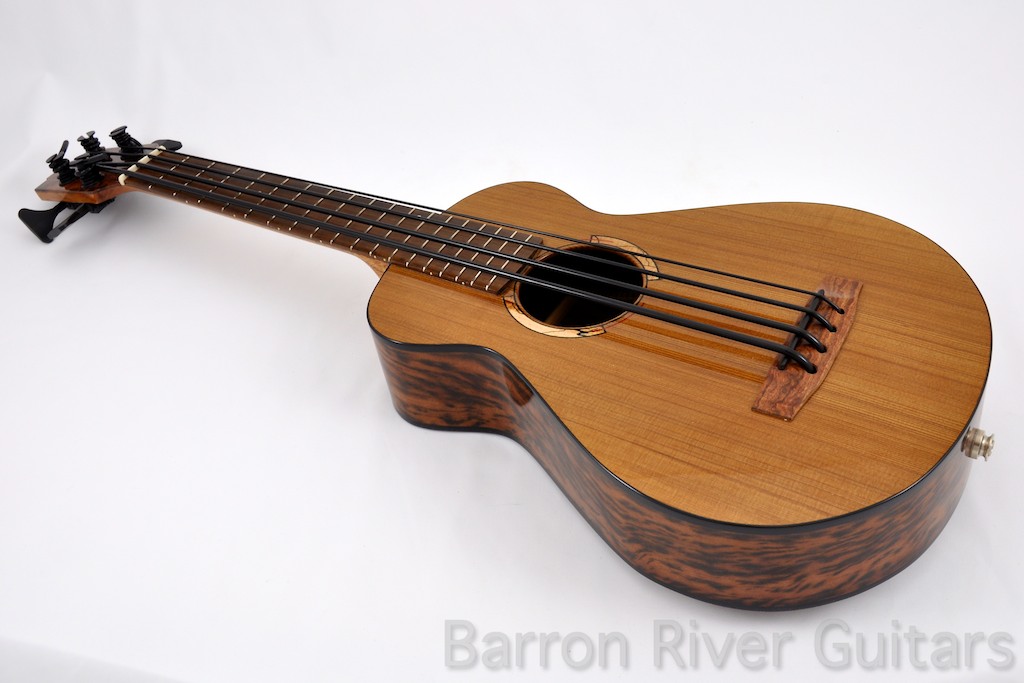

This is the first Bass Uke I've built and is a commission for a lady in New Zealand.
Never having built one before there was some serious research into the design and dimensions, because as you can see, those strings aren't like anything you would have come across before. As well there was a pretty tight deadline as it had to be ready to go after the Cairns Uke Festival, and that left me with scant time especially when I didn't have tuners or strings for this instrument on hand.
Parts of the build are pretty straight forward, but others were a best guess. I couldn't find out anywhere what the total tension on these strings are when up to pitch. I was fortunate enough to get a response from Owen Holt who designed this type of instrument and got the compensation numbers from him. And while the strings do make a bit of volume on there own, this instrument absolutely must be amplified.
Body - Tiger Myrtle
Top - Western Red Cedar
Neck - Spanish Cedar
Head Plate and Back Graft - Tiger Myrtle
Fret Board and Bridge - Gidgee
Rosette - Spalted Maple
Tuners - Hipshot Ultralites
Strings - Pahoehoe
Pickup - K&K Twin Spot Internal
Finish - Mirotone 3220 Gloss over Boat Coat Epoxy
Body - Tiger Myrtle
Strings - Pahoehoe

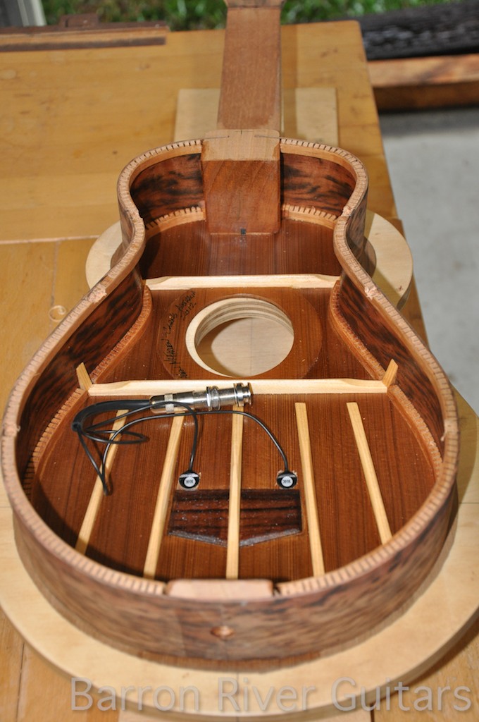

Can you elaborate on those specs, Allen?Allen wrote: I was fortunate enough to get a response from Owen Holt who designed this type of instrument and got the compensation numbers from him.
And do you have an 'inside' shot showing how you anchored the pickup pads?

1/8" on the G string and 1/4" on the low E string. So setting the front of the saddle 1/8" longer than the scale length and using a 1/8" saddle puts you right in line with what his recommendations are. He uses 4 to 4.5mm relief at the 12th and at least 1mm at the nut. These strings are just so soft and pliable that you don't even think about that much relief.John Maddison wrote:Can you elaborate on those specs, Allen?Allen wrote: I was fortunate enough to get a response from Owen Holt who designed this type of instrument and got the compensation numbers from him.
And Owen uses the K&K for his pickups, so I contacted them directly about where to place them. They said either right under the saddle, or just in front at each end of the saddle. As the sound hole is too small for me to get my hand in after the fact, I put the pickup in prior to gluing on the back. And I always use panel pins in the saddle slot to stop the bridge from moving while clamping up, so putting them right under it wasn't going to work for fear of drilling into one or both of them.

Good info & pic Allen, much appreciated!
Was it pricing or performance that influenced your decision to go with a 2-pad pickup in favour of the 3-pad Mini Western K & K?

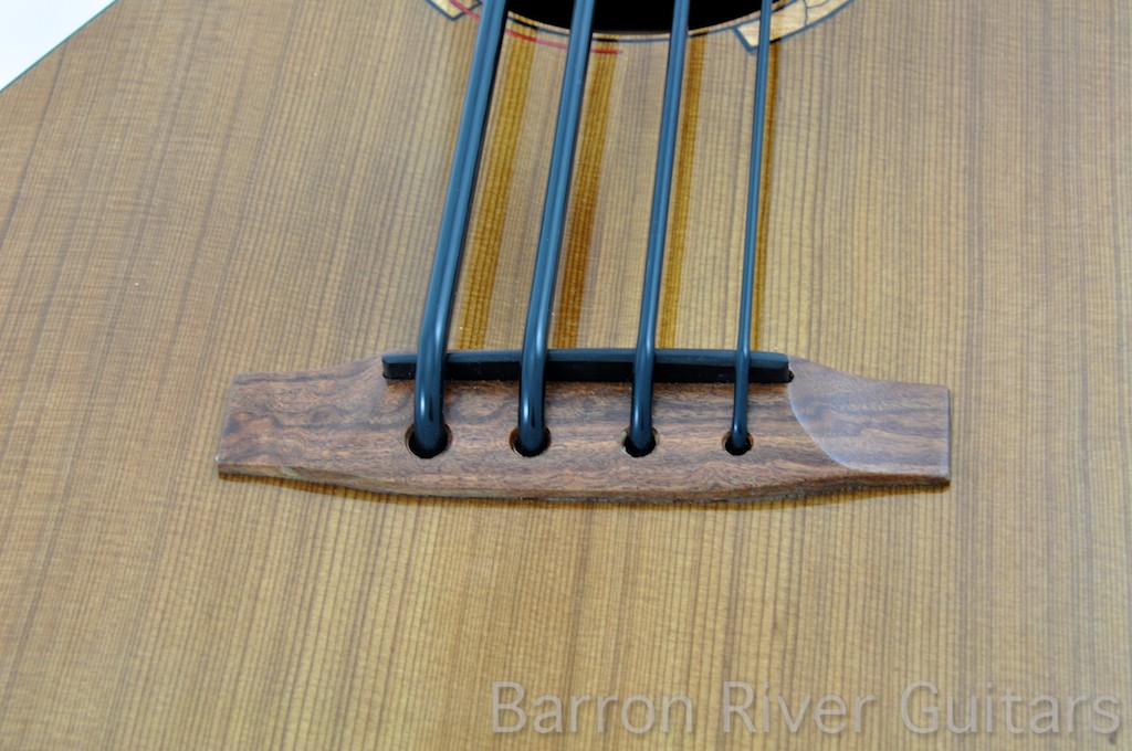

And while we're on a roll with questions Allen ... how DID you manage to thread the poly strings up through the soundboard/bridge holes, given they come already fitted with tie-off anchors?
John M
Re: Bass Ukulele of Tiger Myrtle and Western Red Cedar
I asked K&K which would be the best choice, and that was their recommendation. And as far as I can tell, it's what Owen uses as well. Good enough for me to not second guess. I've used the K&K's without preamp on other instruments and they work fine. I just have a small amp for testing pickups and certainly not suited to a bass, so I don't know if you had a bass amp how they would preform, but with my little amp I'd think a preamp would be the go.
I still really don't have any idea what the tension on these things would be. I made the top to hold up to normal Baritone string tension as my best guess. Knowing full well that a bass doesn't put out enough volume without being amplified anyway. I don't see any distortion or stress on the top, so it's fair to say that tension may be similar or even less. I'm thinking less at this point.
Holes in the bridge have to be drilled a tad larger than the relaxed state of the string. When stretched they narrow up a fair bit. It's actually very easy to string them up. Instructions come on the package. Thread a needle and drop it down the string hole and fish it out the sound hole. Poke the needle into the end of the string and then carefully pull it up and through. Works a treat and is a hell of a lot better than cutting a hole in the back of a uke for an inspection plate like Kala does.
