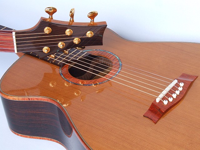

In best David Attenborough voice:
Rarely seen alone in the wild and even more rarely seen together as a mating couple, these two fantastic specimens were caught on film during their courtship routine. You can appreciate their gleaming coats, beautiful markings and their fine pedigree; absolutely superb examples of their species. Well known for being highly strung and responsive to even the gentlest caress of just the shadow of a falling feather, they have a tactile response that is little short of explosive. One false move and they’ll have you for breakfast.

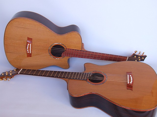

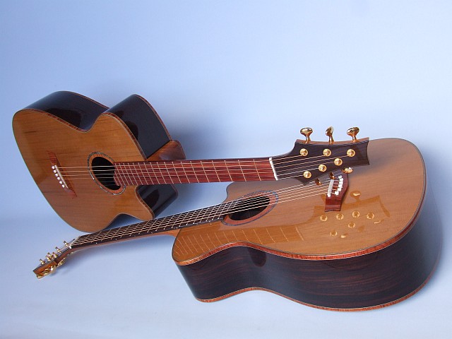

Wait… a move is being made. Just watch that graceful approach…
…and before we know it, with a soft caress, it’s all over.
With a three month gestation period, we wait with bated breath to see the outcome of this rare encounter.

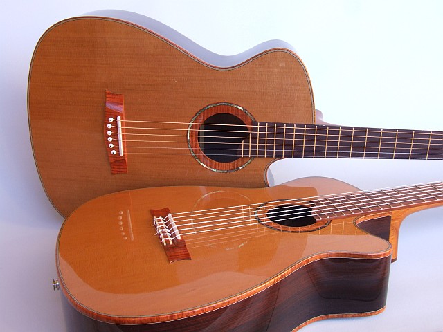

We’ve been following trails for two weeks now and we think we are getting close to seeing something very special.
Yes, this is a classic!

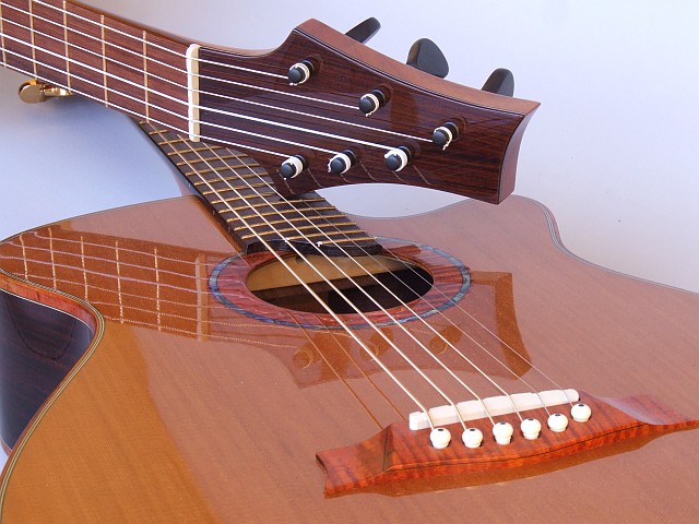

This is extraordinarily rare. The general features that this species is well known for, are all there, but this mutation must be a one in a zillion chance.
There is already an inquisitive nature to this young pup. In search of the lost chord?

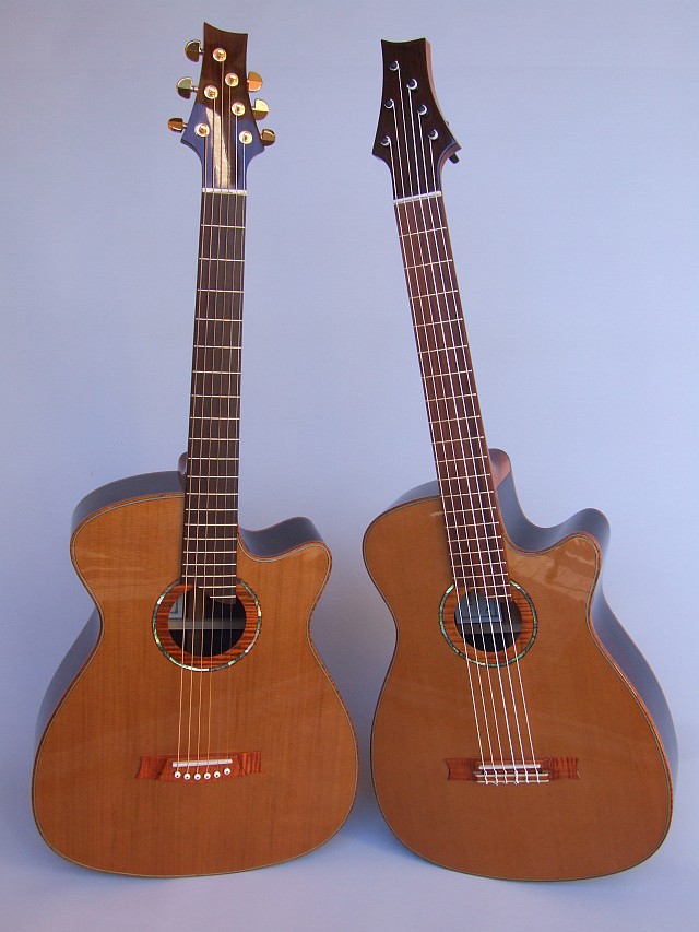

And here we have the first rather shaky steps. Let’s just hope that this family grouping endures the loss of habitat and weathers the threat of death by a thousand pieces of paper that their environment has been subjected to, and that, in the future, we will be seeing more of this glorious species.

Great looking guitars, timber choices work well. Are they going to the same owner? shame to break up a family.
That comment about "one soft caress and it's all over rings a bell".
Riveting presentation too.

Mighty nice specimens Trevor and love the friction tuners. Could you please explain the laminated bridge as well, looks like A melo?

And it's a lovely little classical off-spring Trevor.
But then it is from a fine pedigree!

I got an email from a player who was interested in a cedar/rosewood steel string, so I called him up. He was about to head off to the USA, but was quite local, so he dropped in that arvo and walked out with a cedar/rosewood SS. He's an accomplished player who plays a lot of styles. A couple of months later I got another email, "could I build him a matching classical?" Very hard to say no! So that's how the classical came about. It is a full-on classical (neo-classical body shape), just dressed a bit differently from your usual classical. He had played one of my cedar topped classicals when he first visited for the SS. A great customer!
The second SS was built to replace the one Bob bought. They always seem very popular and I've sold them in the USA and the UK as well as here, but this was the first time I'd actually seen two of the SS's together, because Bob brought his in for a pick-up install (K&K). The classical is also K&K loaded.
So the three guitars have never been all together. I was lucky in being able to replicate the lighting so the pics didn't need any colour correction to look like they might have been.

The tuners are the planetary pegs, with a 4:1 gear inside the shaft. They let you do a straight string pull as well as having zero backlash.Kamusur wrote:...love the friction tuners...
The SS has a CF laminate in the bridge plate and there is one layer of CF in the bridge to effectively form an I-beam. The bridge is very much part of the bracing in the falcate bracing system. The classical has no bridge plate but has two layers of CF in the bridge to achieve the same effect.Kamusur wrote:Could you please explain the laminated bridge...

Excellent Trevor, and thanks for the answers.
