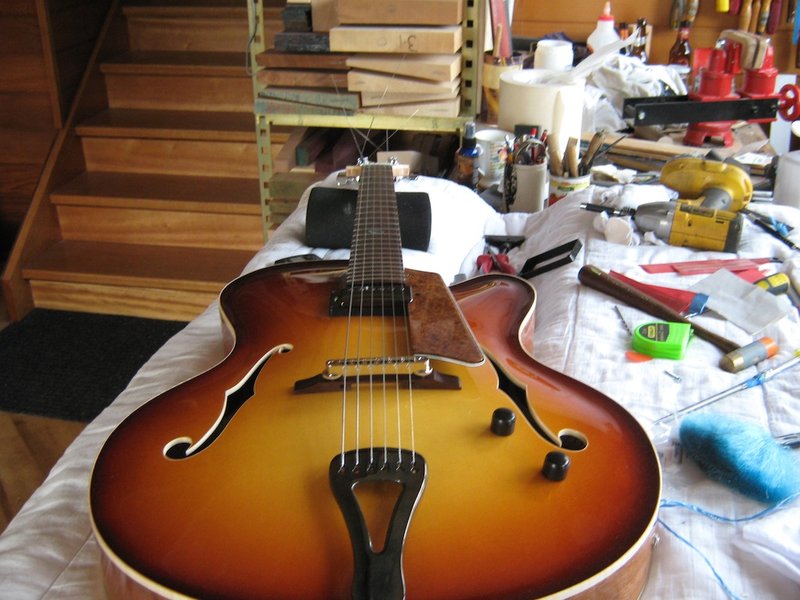

Post by rocket » Tue Sep 25, 2012 7:21 pm

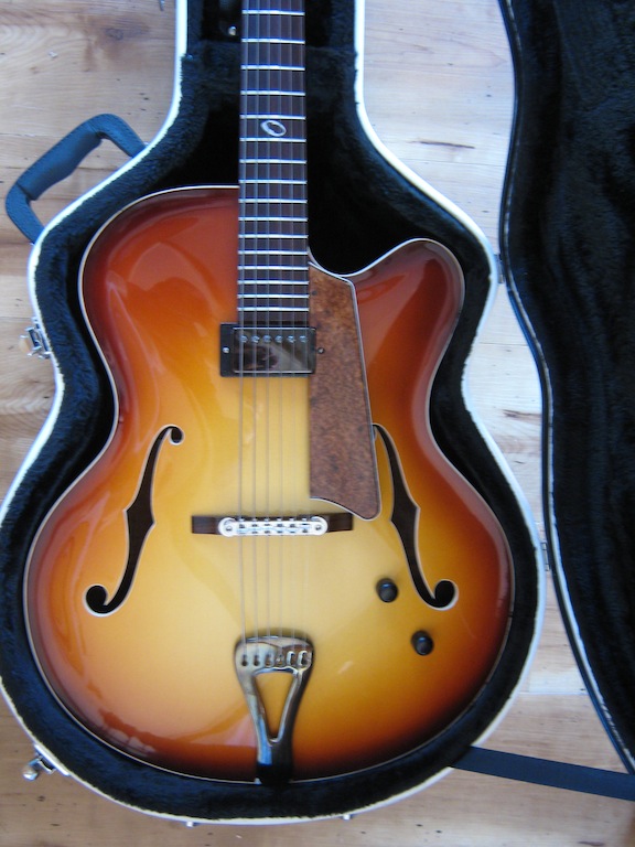

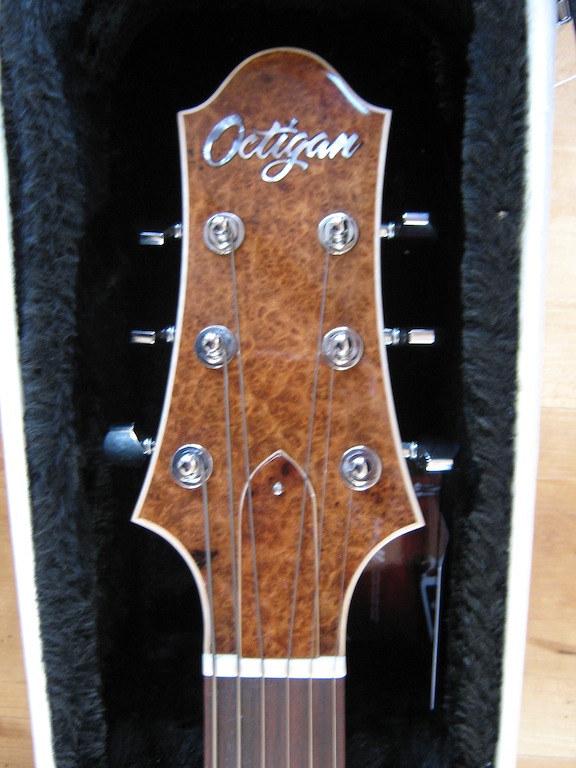

Just took some happy snaps of this one before it goes to it's owner, prob won't have time for some pro shots.
Blackwood b/s
Engleman top
Irw fretboard/ pearl inlay
maple/ purple heart neck
burl headstock veneer
Benedetto A6 pup
17" lower bout

Another beauty there Rod. Stunning burst. Did you get any shots of the back?

Great Archtop Rod. Your finish is spectacular and the home made tailpiece looks just right!

BTW, Nice job Rod, you've got the bursting down pat. The Engleman must have been some tight even grained stuff! Can't spy a grain line anywhere :wink:

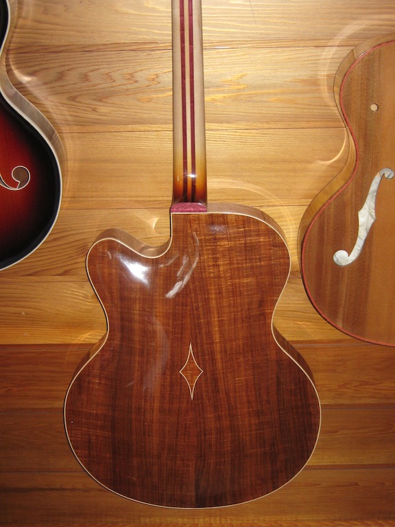

I'll have a look for a back shot.

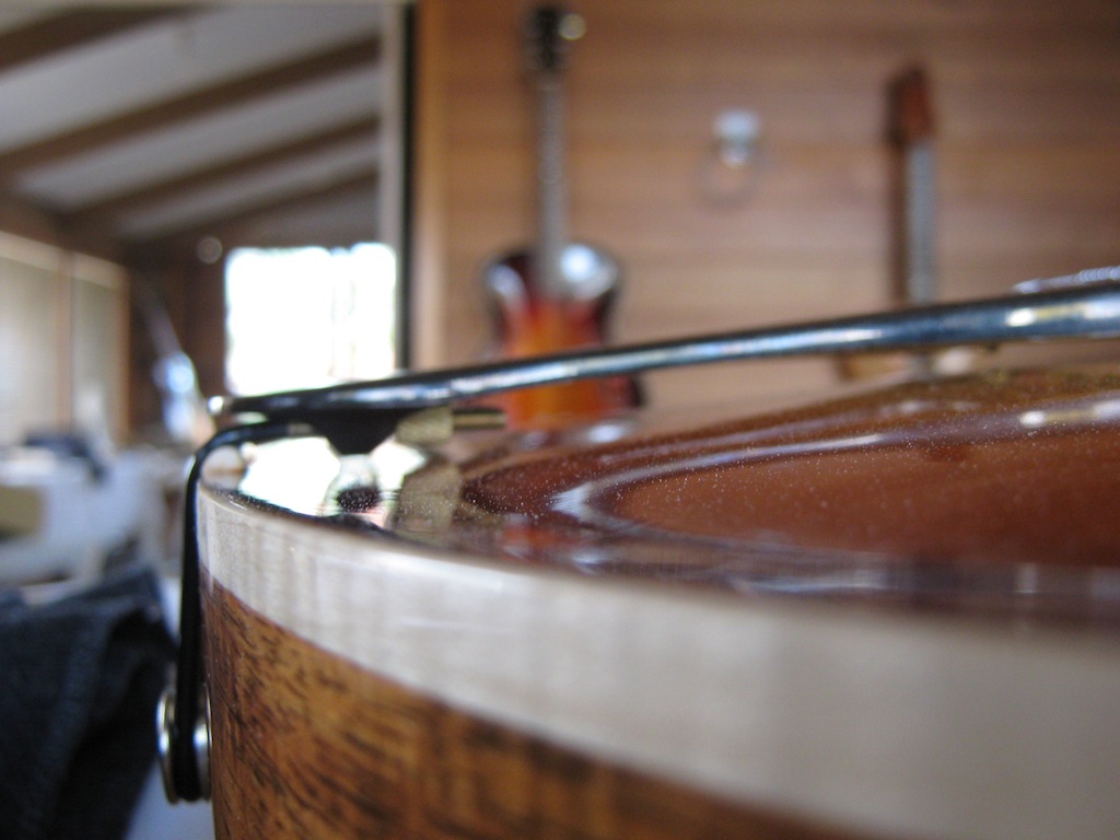

Post by rocket » Wed Sep 26, 2012 5:31 pm

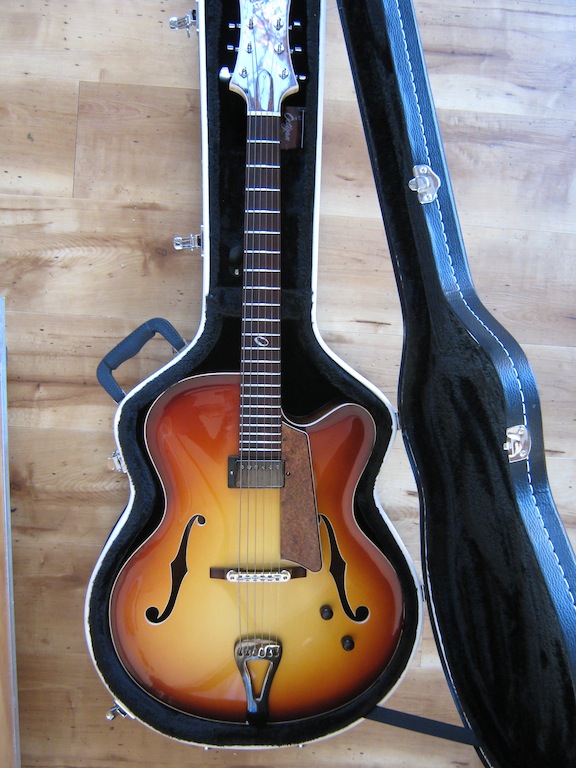

This is not a very good picture but for Alans information regarding the tailpiece, i've designed it so as it doesn't touch the soundboard at all like sir Bob would have you do, i put a raised saddle in the rim to lift it clear of the top, hence no damage to the spruce

Post by ozziebluesman » Wed Sep 26, 2012 5:57 pm
Ahhh! Thanks Rod for that small but very useful piece of information. I remember Dominic had a similar tailpiece dwsign to yours.

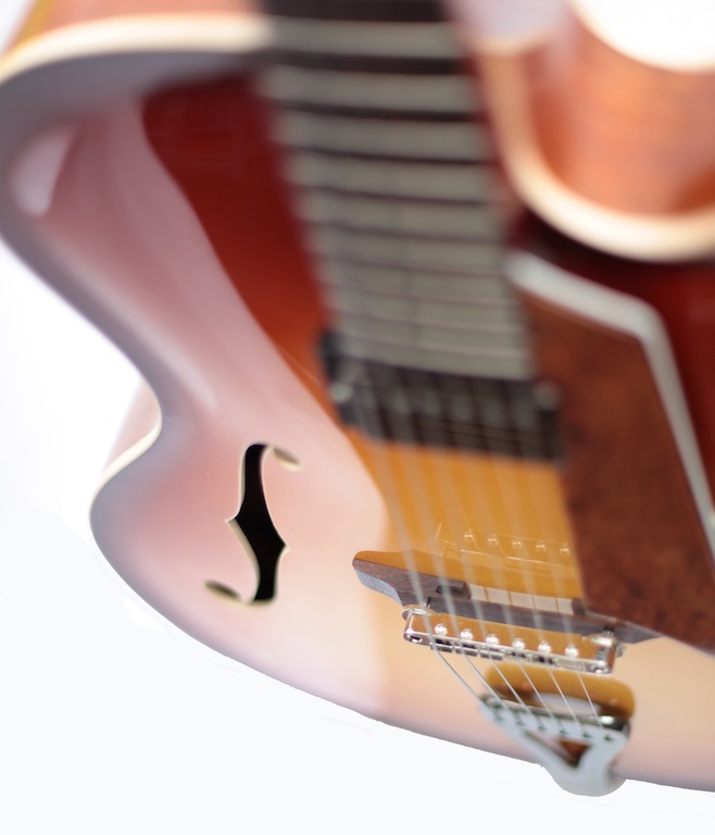

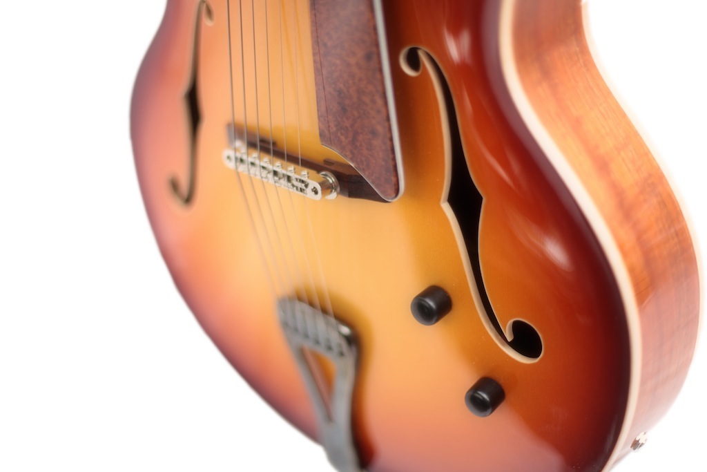

Post by rocket » Fri Oct 19, 2012 9:51 pm
IMG_8927_downward strings.JPG (69.96 KiB) Viewed 15202 times
IMG_8930_full guitar.jpg (45.3 KiB) Viewed 15202 times

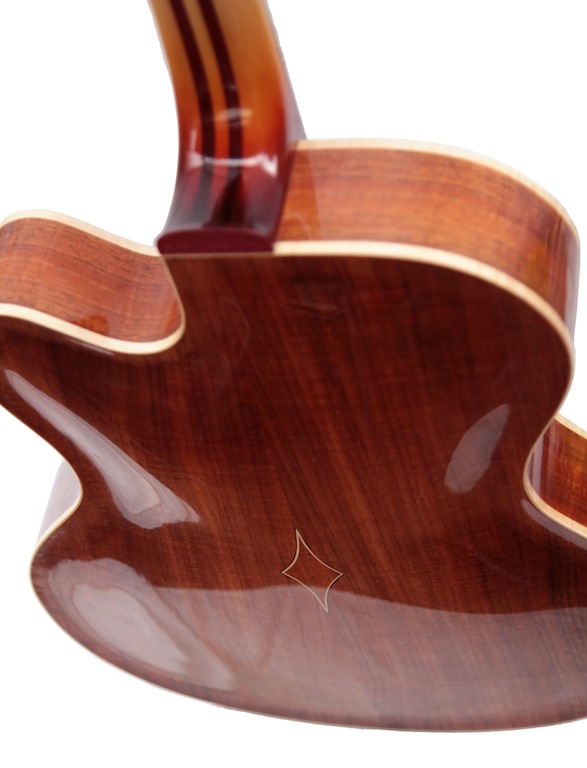

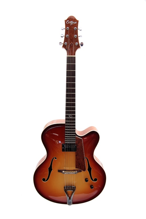

Some more eye candy.

Just looks like martini's and jazz....really nice!
