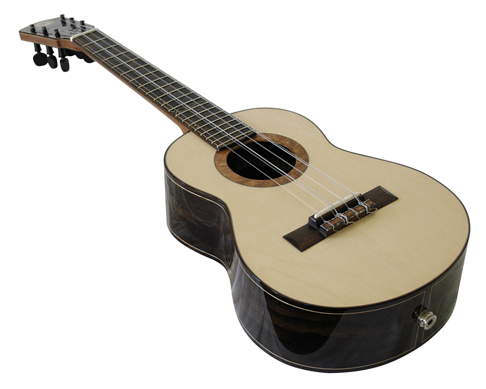

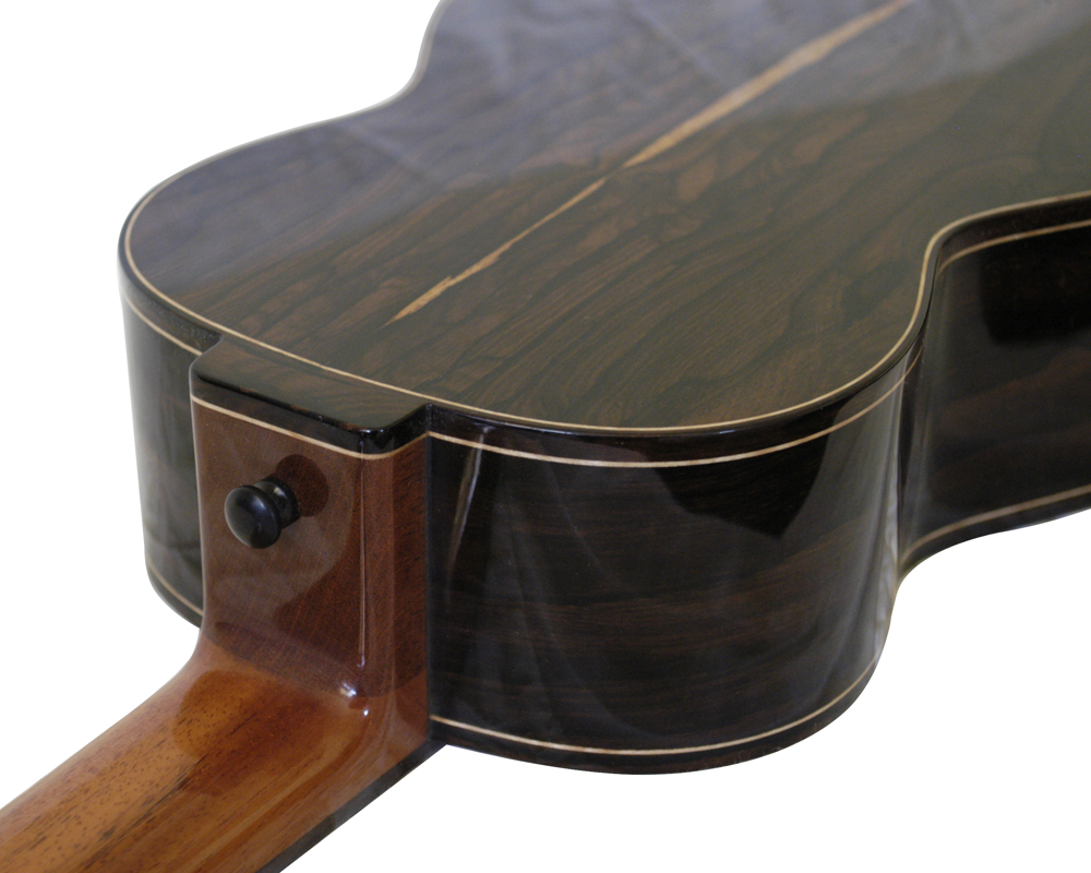

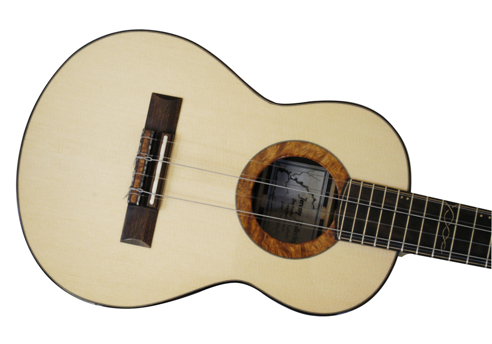

Hi All.
Another commission; another uke... A little different this time round though.
This is the first six string Tenor Ukulele I have had commissioned, or made. It is not six individual strings or notes like a Guitalele, as the pictures will show. Two courses are octave doubled like some Bouzouki's, so it is tuned - G, High C, Low C, E, Low A, High A.
David Hurd warns builders that going from a standard four string tenor ukulele at 39lbs tension, increases the cumulative string tension to the six string version at not quite double that - 65lbs. A big jump and one that requires careful consideration of bracing and a proportionate increase in bridge size/gluing area.
Anyway, this is what I came up with. I am very happy with the resulting tone of this build. The added courses certainly give a rich texture and full sound to the ukulele, but I'd really like to hear it in the hands of a talented player as opposed to my clumsy attempts. I hope the customer will do some recording - if so, I will post a sample.

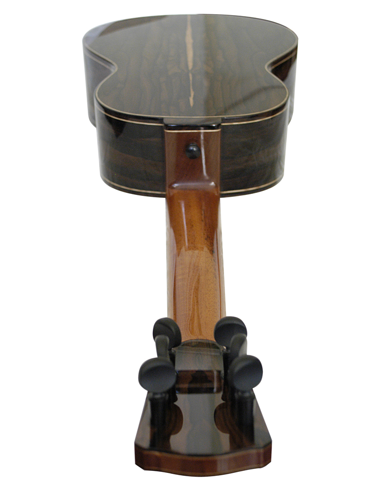

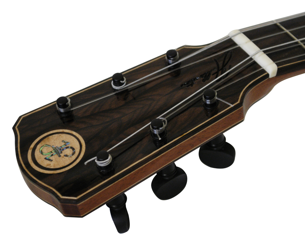

I used Pegheds on this build, to limit the weight and size required in the headstock. I think they suited well. Also in reference to a recent thread on the subject, this unit had a K&K Twin Spot installed. I mounted this directly under the saddle, on the bridge plate and it is certainly loud, even and clear.
Specifications are -
Back, Sides, Binding, Headstock, Fretboard : Ziricote (stunning set!)
Soundboard : Englemann Spruce
Neck : Mahogany
Rosette : Amboyna Burl
Bridge : American Walnut
Purfling and Inlay Details : All 0.8mm Maple
Logo : Paua
Pegheads : Pegheds!
Pickup : K&K Twinspot
Finish : Mirotone High Gloss
Strings : Combination Worth High Tension and D'Addario Wound
Thanks for letting me share it. 8)

Are the tuning pegs of the Stewmac variety? And is there any noticeable 'slip' when the Uke is tuned up?

John - The tuners are "Pegheds", as in, that is their trade name. They are not a traditional violin style friction peg, but so called mini 'planetary geared' tuners. They are 4:1 ratio I believe, which seems coarse, but works very well. I found them quick and easy to tune with no "noticeable slip". The only thing I did find is that a couple of them 'felt' a little more difficult or 'rough' to turn than the others - but they all did their job admirably. I don't believe Stewmac stock them - you get them direct from the maker.

There is a bit to installing PegHeads correctly. They require a tapered hole and you will need a violin peg taper reamer. I got mine out of China at a fraction of what StewMac wants.
Several places that I know of getting PegHeads, with simply outstanding service from Bill Thompson at PegHeds.net. He's not the maker, but I believe one of the biggest distributors.
There is also a bewildering variety of options on PegHeads. And they are not an inexpensive option. I charge an upgrade price on using them as do many other builders. They are very light, so good on soprano's and concerts. The gear ratio is only 4:1 so not all that fine, but a lot better than plain friction tuners.

Thanks Allen & Jeremy for the info! So, are they a friction fit, or do they come with an anchoring nut?

May have answered my own question by looking at the FB images; seems there is a thread machined into the outside of shaft.

The ones I have are a very fine thread (something like 40 tip) and you are recommended to put a dab of glue on the threads prior to installing them. Like I said, they are a bit of a task to get to fit well. You have to ream that hole just the perfect amount or they will not seat deep enough, or just a hair too much and they will come through too far.
There is also a right side and left side, and it's impossible to tell the difference just by looking at them. Unless your eyes are a lot better than mine.
