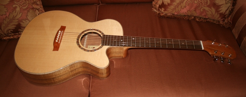

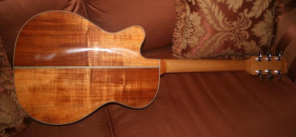

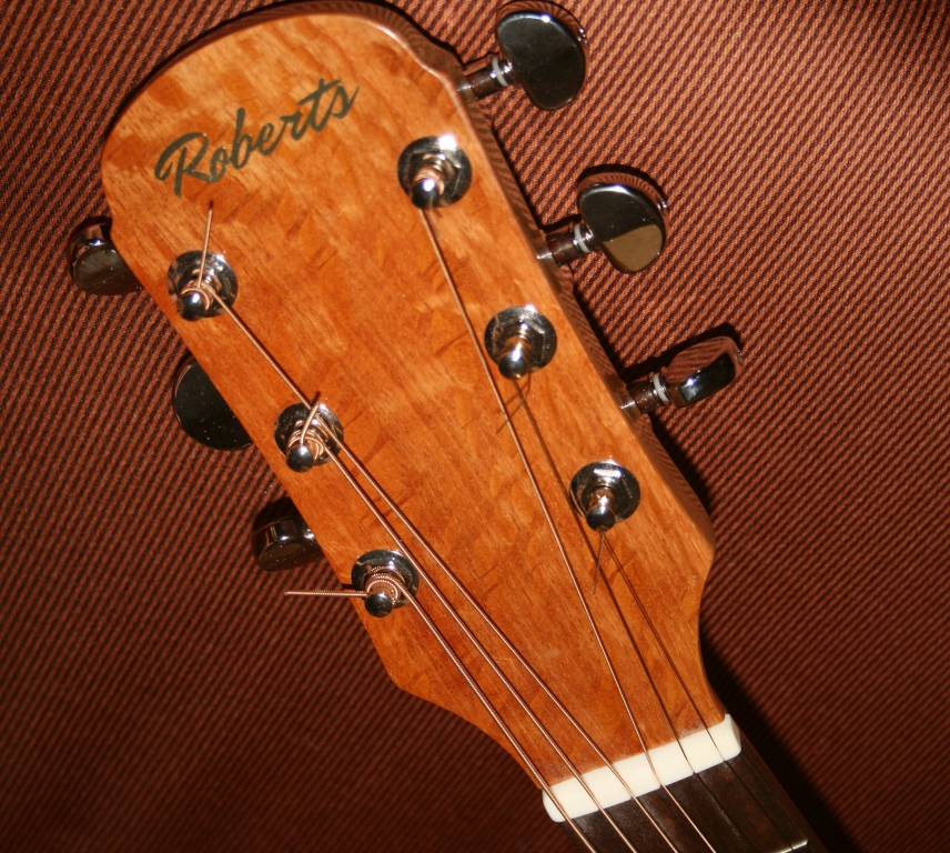

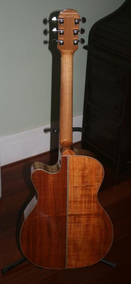

I finally finished my 16th guitar on 12/12/12! It has Tassie Blackwood back and sides; Sitka Spruce top and SheOak headplate & bridge.
It is the first guitar I have built with a live back and I followed Trevor's guides in his book re frequencies to the best of my ability and am very happy with the results - I think it is the best sounding guitar I have made to date.
Anyway, I've attached some photos for you to look at.

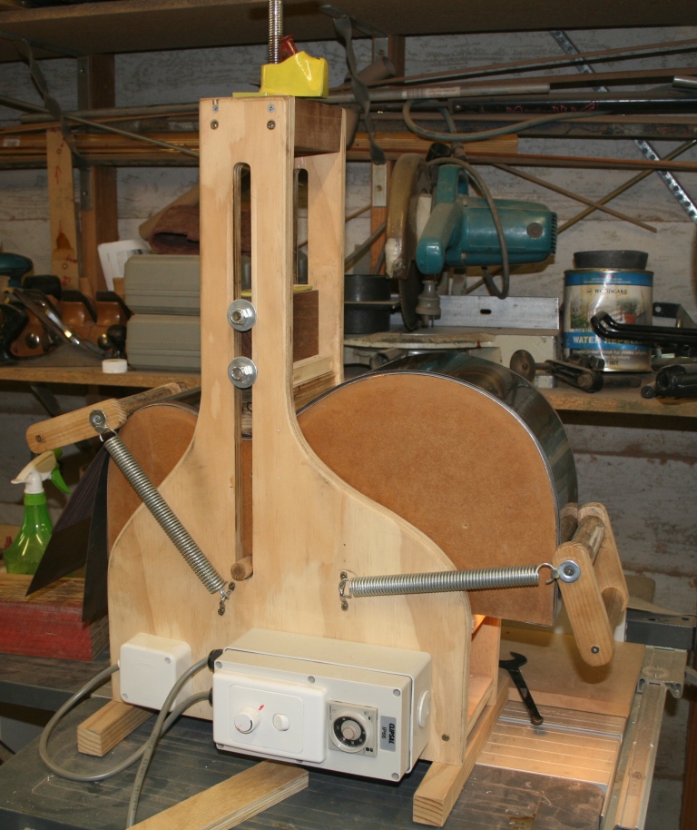

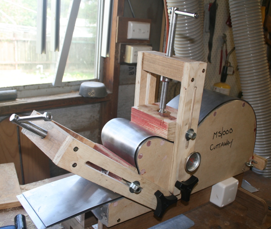

Curious to know how you go about your cutaway, bending iron or in a jig? I am yet to do a cutaway, I know it is inevitable but still a bit freaky.

Martin, in response to your query about how I bent the timber for the cutaway, this was my first cutaway so I bent it by hand using a piece of pipe, a blow torch and a lot of perseverence!
I figured that since I will probably be asked to build more cutaways I would make a bending form, which I have now done and am using for my current "lefty" build. See the attached photo of the mould and heating unit built as a fox style bender with heat lamps inside.
Even though I am not a big fan of cutaways, the market demand is certainly there. Hope this helps you.

Great jigs! Certainly better than the ones I've thrown together. I'll probably be lifting some elements from you in the future, thanks!
