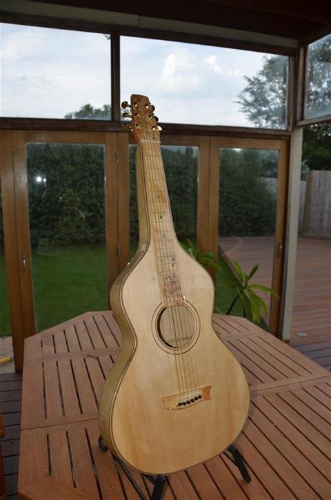

Post by Bob Connor » Mon Feb 25, 2013 7:16 pm
Everything is Huon Pine - braces, linings, bridge and fingerboard (not to mention back, sides, top and headstock)
The purflings are Blackwood. The bridge plate is Honduran Rosewood and there is some carbon fibre epoxied to the A-brace.
I built this more as an ornament or piece of art but it sounds surprisingly good. it certainly wouldn't hold up to the rigours of touring or gigging considering the softness of the timber but you'd definitely record with it.
A big thanks to Kim Strode for providing the fingerboard and bridge

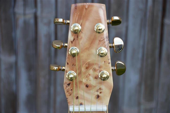

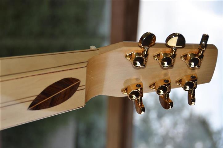

Well ain't she a pretty blonde! :D The fingerboard & headstock especially, look fantastic. Is that a Jeff Yoong style leaf inlay on the back of the neck?

I've just noticed :oops: that you use an interesting string wrap around the tuner post Bob, your thoughts behind it as opposed to the 'normal' (one wrap above, one below the string tail) wrap?

Nick wrote:I've just noticed :oops: that you use an interesting string wrap around the tuner post Bob, your thoughts behind it as opposed to the 'normal' (one wrap above, one below the string tail) wrap?
I just hook the string under itself so that when you tighten it, it locks against the tuning post.
No need for multiple wraps around the post and it's very quick to do string changes mid gig.
