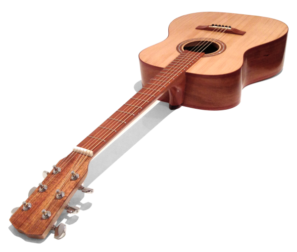

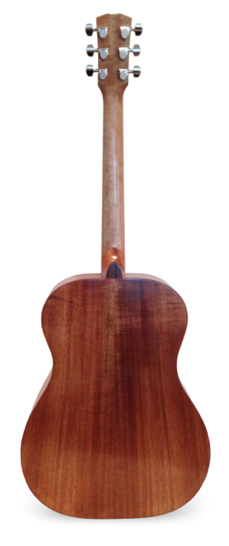

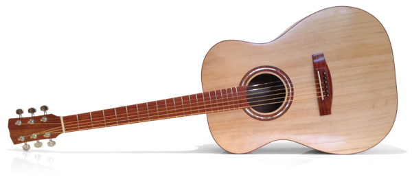

Another small body acoustic done. This one had to have a smaller neck width and thickness due to the customer having limited hand and finger movement.
Back and sides - Tassie Blackwood
Soundboard - Bunya
Neck - QLD Maple
Fretboard and Bridge - Mulga
Scale length - 25.34"
Soundboard - Bunya
Neck - QLD Maple

Re: Custom Blackwwod small body
Hi Martin,
Very nice, simple & neat.
What's the bindings, rosette & finish you used?

The bindings are WA Jarrah
Rosette is Tassie Blackwood with Mother of Pearl inlay
The finish starts with sanding the whole guitar down to 1200 grit, then I use is 6 coats of Rustin's Danish Oil applied with cotton cloths (rubbing with 0000 grade steel wool in between each coat) and then 2 coats of Wax (again steel wooled between coats).
I find the finish is really natural with a satin look. It plays in really fast and if I ever have to do a repair is really easy to refinish just where the repair is. It is also no where near as toxic as most spray finishes.
I like simple and neat.

A very nice looking guitar.
It seems that you don't like frets all the way up to the end of the fretboard!

Re: Custom Blackwood small body
Thanks Markus,
When I finally do a cutaway I'll probably add in a 21st and 22nd fret but until then I haven;t had anyone need more that 20. I have 2 builds to do before I can start a cutaway. I know I'll be getting as much advice as possible to set up the cutaway properly.
If anyone has any advice feel free to send it my way! (or plans)
