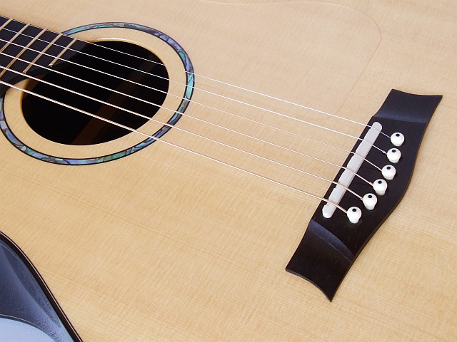

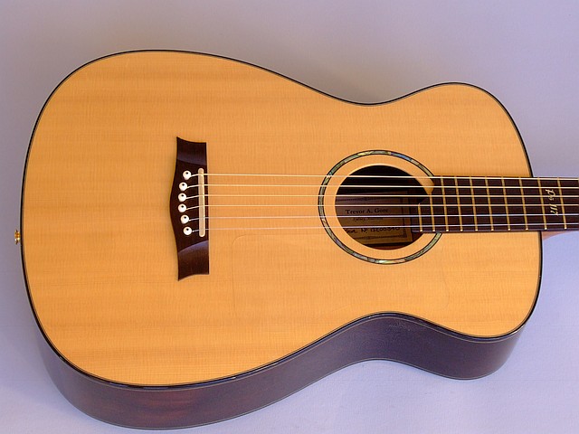

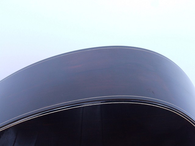

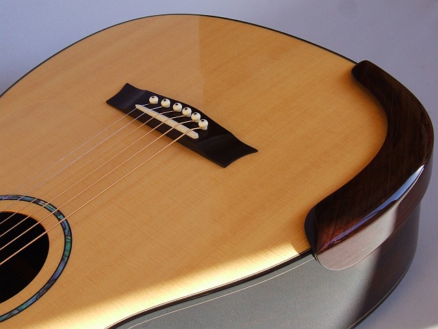

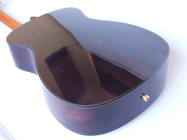

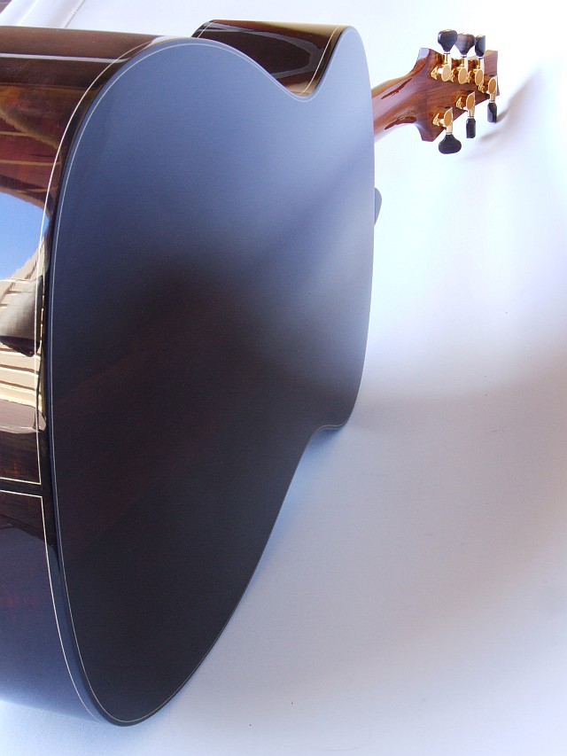

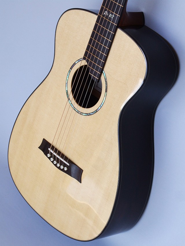

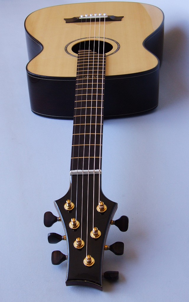

Some guitars are really hard photograph; like this one. The BRW turned out so dark it is almost black, so my feeble attempts to photograph it don't really do it justice. It's one of those guitars that you feel you should be pulling on the white gloves before you touch it. It started out with the prospective customer calling me to say he had some wood and could I make him a guitar. It was a tough negotiation! It's BRW back, sides, fretboard, bridge, bridgeplate, and rosette trim. The top is Lutz. The body shape is one that I use for both SS and CL, perhaps more often seen as my neo-classical. It's about 00 sized. It's got a magnetic arm rest and is fitted with K&Ks. The rest, I think, you'll be able to figure out.

Looks great Trevor. What's the neck and armrest made of? It all seems to match in really nice. Wayne

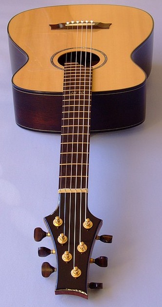

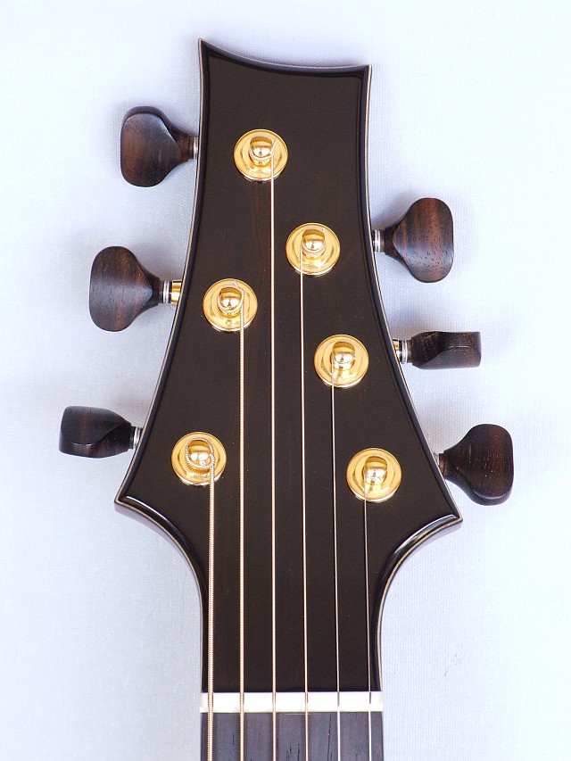

Trevor that's a stunning guitar, your finish is truly superb, I have not seen a headstock done like that it really suits the guitar and I love it. :cl :cl :cl :cl :cl

Wayne, the neck is NGR, armrest is EIR. The finish is nitro all over.

Post by H3ytm@n » Wed Mar 20, 2013 11:56 am
Beautiful looking guitar. Love it.

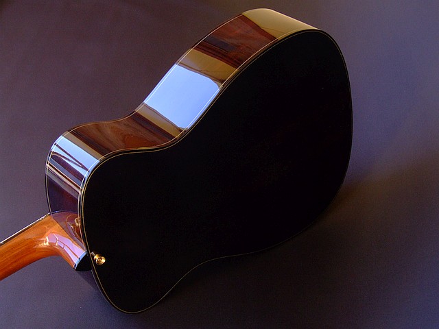

Can't work out whether it's satin on the back (pic 1) or something that you've done with photoshop?

Post by Trevor Gore » Wed Mar 20, 2013 7:56 pm
H3ytm@n wrote:Can't work out whether it's satin on the back (pic 1) or something that you've done with photoshop?
:lol:

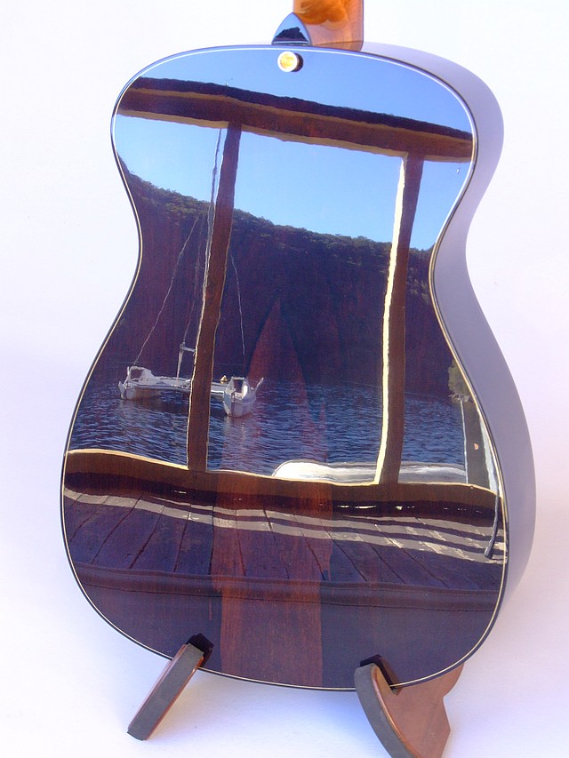

Neither! Oh that my Photoshop skills were that good! The back is high gloss, just like the sides that you can see in pic 1. What you're seeing is the reflection of the matt blue background in the high gloss back. With a photo of the back taken any other way (in my very constrained "studio") all I could get was pure reflection, as you can see in this picture of my "antique" Chateau Tanunda thermometer (which is about a metre tall, if you were wondering!)

Post by H3ytm@n » Fri Mar 22, 2013 3:29 pm
Yes quite the reflection!! There's so much gloss there I can't tell what type of wood you used. :lol:

Post by Trevor Gore » Wed Jul 18, 2018 12:24 am
Five years later (where did that go!) and in for a service. Gets frequently gigged, but well looked after. Fixed the pre-amp (the main reason for the visit), tap tested, tweaked the set-up, sorted some dings in the finish, a cut and buff and good for many more years.
And if you ever wondered why Brazilian rosewood is Dalbergia nigra, here's a hint...
...seriously dark and seriously reflective!

As an aside I notice the position of the strap button at the body. Was that something the player wanted or a decision by yourself?
For my current Gore design SS I have repeated what I did before and have reinforced the side uphill of the heel ready to take the strap button there, but I don't have enough interaction with players to know if this is completely acceptable.

Stewmac has a pic showing various strap button positions. Many players seem to prefer position 5, as they say it helps prevent the guitar rolling forward. I just ask the player and fix accordingly. Very important to get the right pilot hole size for the screw.
