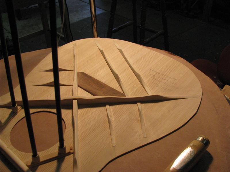

Post by Bob Connor » Mon Apr 01, 2013 10:33 pm
Lovely Gibsonesque burst on that Phil.
I reckon your braces look a bit hefty. I'd be carving everything south of the soundhole into a triangular shape which should open up the bottom end.
Here's what I've done before (which is fairly typical of how Martin braced their pre-war scalloped dreadnoughts.
