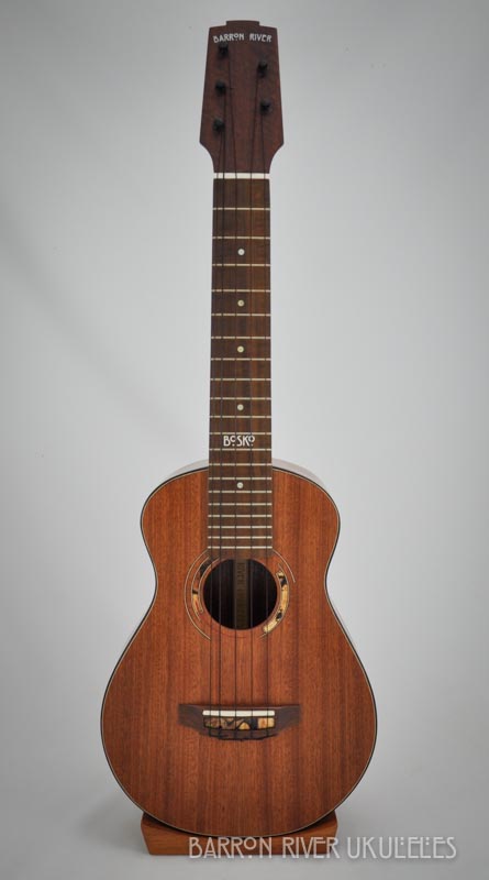

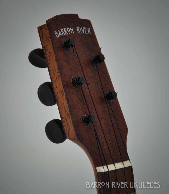

This one is a special order by my mate Bosko. He wanted a 5 string instrument with the 4th and 5th strings to be an octave pair. Not only that but he wanted to be able to play them in unison, but also able to mute one and still pick out the other. Some careful calculations and a bit of guess work and quite a few CAD drawings got to me where I felt confident in putting blade to wood.
As he's also the most particular muso I know, I had him down for a fitting on the neck, then again once it was strung up we went over the string spacing and redid the nut to better accommodate the spacing on those 4th and 5th strings.

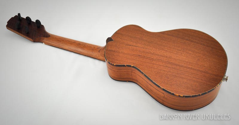

Body - Sapele
Neck - Spanish Cedar with CF truss rod

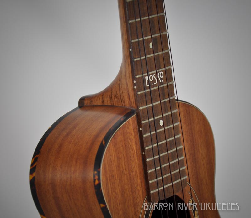

Bindings - Tortise Shell with maple backing so that the light parts flash bright
Rosette - Spalted Mango
Fret Board - Gidgee with 12" radius
Bridge - Gidgee with Spalted Mango inlay
Head plate - Jarrah
Tuners - Peghed 4:1
Finish - Satin Mirotone over epoxy pore fill
Strings - Wuth Browns
Pickup - K&K twin spot
Body - Sapele
Head plate - Jarrah
Tuners - Peghed 4:1

I'm tempted to say "great wood selection for the binding material"...

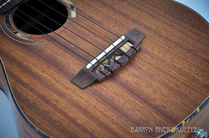

I also love to see how you are "playing" with the bridge shape, how you converted it into a tie-block bridge.

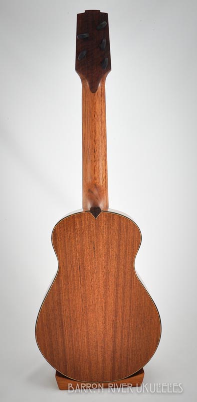

There were quite a few things that challenged me on this instrument. First up was how to shape the head stock so that the string path would work out on those 4th and 5th strings, and still hold onto the look I'm striving for my instruments.
Then the bridge was a real head scratcher. I couldn't go with a pinned bridge as I prefer, as the 4th and 5th are just too close together to work out on the spacing. So then I was left with either a string through bridge, or a tie bridge. Since Bosko is a working muso, I didn't think he'd want to be fiddling about trying to replace a string through when one broke in mid act, and a classical style just didn't suit the look I was after.
I had planned on using a pinless design like a steel string might use, but the bridge on a uke is just too thin for that style to work out. I should know, I make 4 bridges trying to get it to work before giving up and going with this version.
I got to sit with Bosko last Sunday while we went over the set up on it, and he played it hard for about an hour or so. As the spacing at the nut for the octave course was a best guess, we decided that they were a bit far apart with the nut I had made, so a new one was in order. That's been done and Bosko will pick the new uke up this coming Saturday.
I will be onto him for a sound sample of this one for sure.

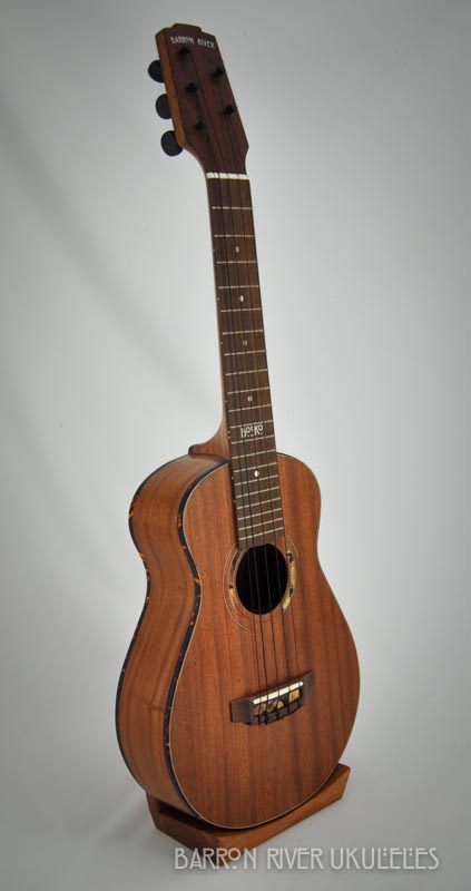

Wow. The careful choice of woods really transforms this sapele. Excellent work

Looking forward to hearing this one - and love the way the bridge turned out.

Re: 5 String Concert Ukulele
I get quite a few requests about building another instrument just like this one, as the idea really appeals to people, but the reality is that this set up is only for a real player. Being able to simultaneously fret the double course and pick out the note (string) that you want, but also fretting both cleanly, or muting one as they spread out up the fret board takes a considerable amount of skill.
So while making a new nut to adjust string spacing at the headstock end is easy (and we had to do as the first spacing was too wide) the spacing at the saddle would require a new bridge, or some really clever engineering to have it adjustable. Make sure that your client is aware of this should they decide for the wider spacing in order to pick out the separate strings.
That said, Bosko absolutely loves this instrument. Is incredibly proficient on it. But does practice hours and hours every day. Everyone else has a good long think about their playing skill and so far they all have decided it might not be up to the task.
The spacing at the nut is 3.5mm and at the saddle it's 6.5mm on the octave pair. The rest of the spacing is a personal thing for what the player is use to on their other instruments. My typical uke nut width is 36mm so adding the 3.5mm to it was close enough to 40mm that it's what we went with. The saddle end string spacing on my ukes is normally 42mm but adding the 6.5mm brought it up to 48.5mm.
Your fret board width at the 12th is always the width of the strings at the saddle.
If you opt for the narrow spacing where the strings are played in unison then it's typical to only add 2 mm or even none at all to the string spacing overall to each end. And split the difference between the others.
