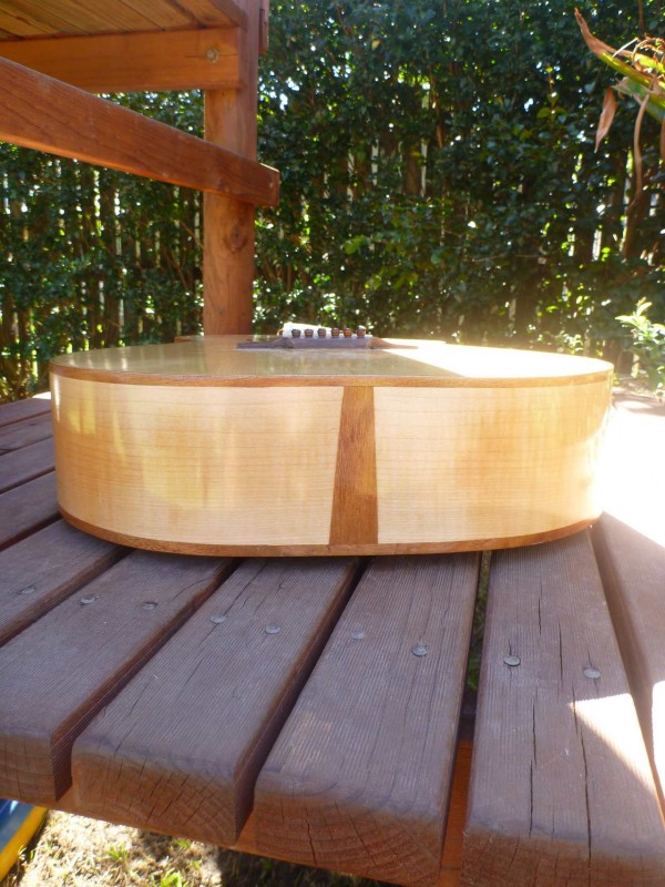

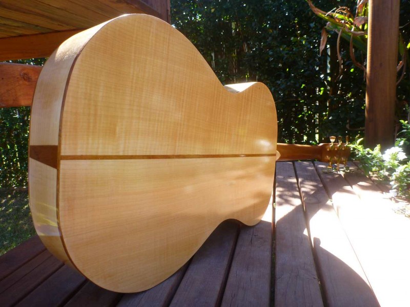

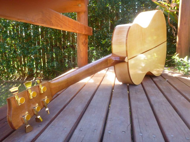

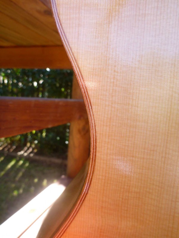

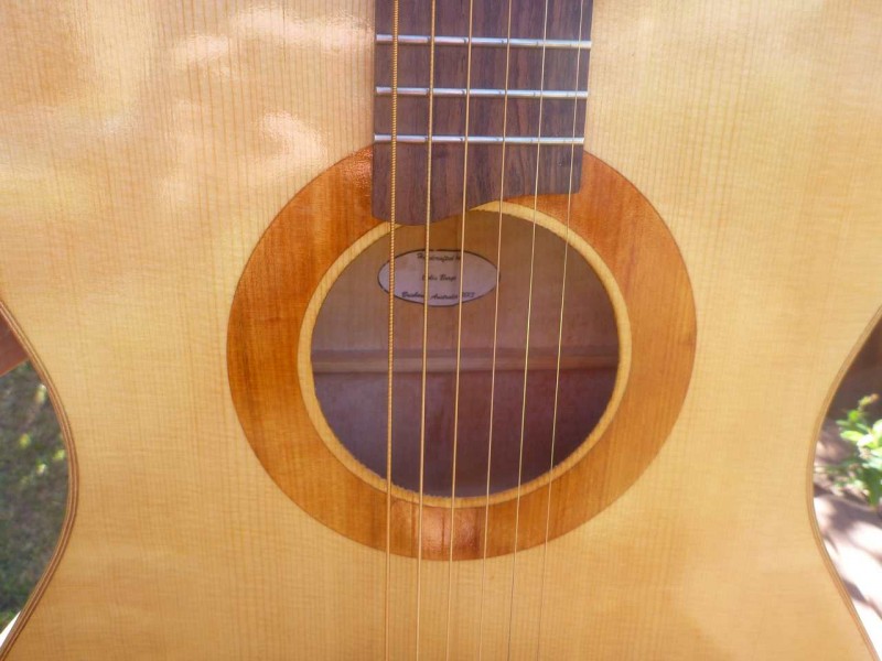

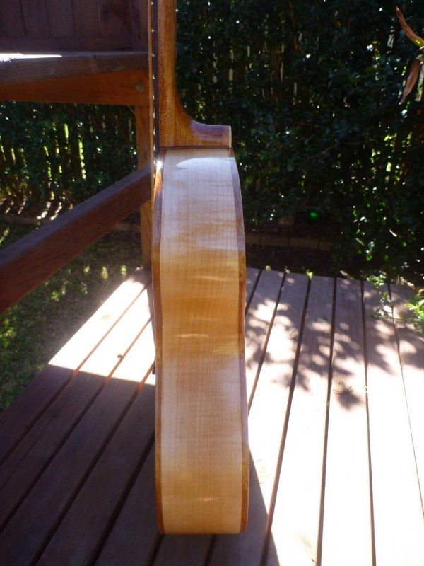

Finally completed my first build apart from a couple of minor things. It has taken a while because because I think I made a mistake on every single part of the build and had to redo things twice (or more). Here is the list of mistakes -
1. I made the top too thin at 80 thou. I ordered a new top from Tim to replace it, but I ended up just going with the original to see how it went. It is way thinner than 80 thou now due to sanding.
2. When I joined the top and back I used Titebond 3 and didn't get it perfect, so it left a horrible grey line in the top and back. I covered the back with a back strip, I should have re-joined the top but didn't, because I thought it would sand out for some reason.
3. I was too scared to use my big Triton router to cut the rosette channel so I used a paddle pop stick,xacto blade and blunt chisel instead - shouldn't have 'cause it looked rubbish. I ended up getting the router out to fix it and made the channel too wide as I measured wrong, and didn't account for the diameter of the cutter. (should have made a test cut). I then threw the top across the backyard like a frisbie. I retrieved it the next day and made a new rosette, waaaaaaay bigger than I wanted.
4. I then glued the back on crooked.
5. I took too much meat off the neck trying to get the angle right and ended up gluing more wood back on so it would meet the body at the 14th fret, it still isn't perfect, but I had enough.
6. I made a jig for my router to cut the binding channels, I shouldn't have as I f**cked up the channels too, making them really deep. I though I would be able to cut some thick bindings to cover it, but I couldn't bend them and they kept breaking. I ended up making bindings from the maple scraps from the back and gluing them in (they would bend). I then bought the proper bearings and cutter and re routed the channels over the top. I used thin binding strips this time but needed to make purfling strips as well to cover the first stuff up. Pain in the arse making them.
7. I sanded through the binding in one spot...argg. I just left it.
8. I tried using a homemade version of tru-oil as a finish. Looked like poo, so had to sand it off. Went with a can of spray varnish instead, still looks like poo.
9. Didn't get the tuners in the right spot and the strings foul slightly on the adjacent tuner.
10. I cant remember the other mistakes, but there were more.
11. I Just remembered - after I closed the box 5 cracks appeared across the top! I don't have a humidity controlled environment and was trying to get the whole thing together on the 1 day the humidity was around 50%, it obviously didn't work. I manage to glue up all but one properly, as you can see in the pics. Time will tell how long it holds together!!!

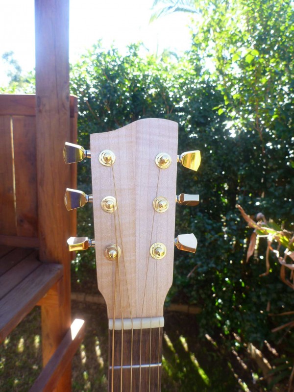

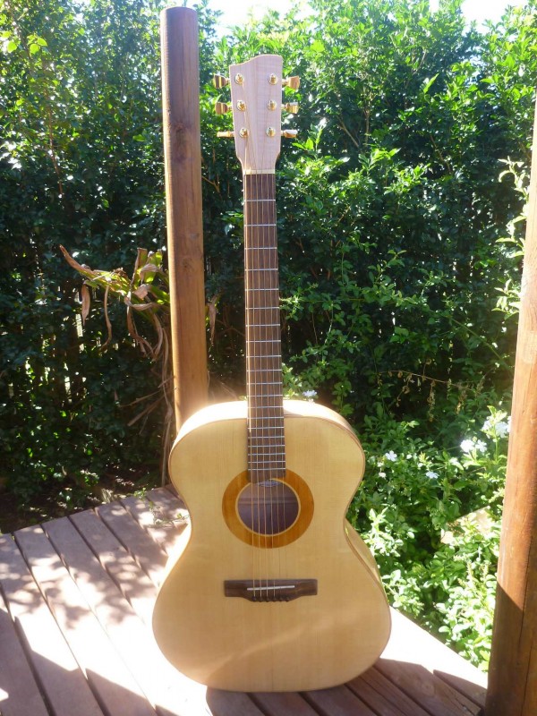

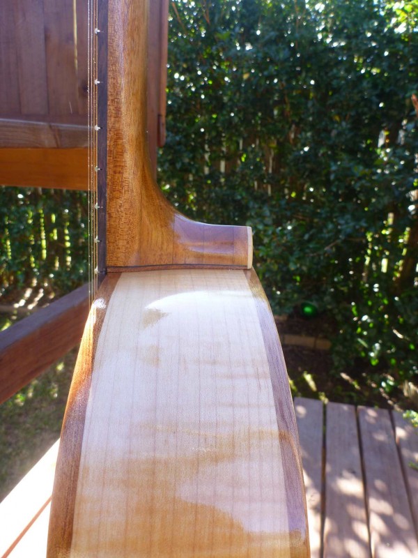

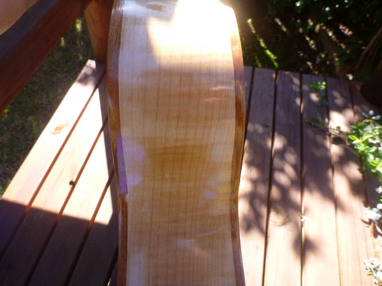

Anyway here are some pics, it is average at best, but it looks like a guitar at least. I will make a better effort on the next one hopefully.

It's alright Col, nothing wrong with a cock up or two, or three, or four, or......
It's all a good learning experience and from what I can see in the photo's you've coped with most of the problems pretty well.
Learn from No. 1, move onto No. 2 and keep having fun .

Dont be to hard on yourself great first build looks good from here .
We all make lots of mistakes fixing them is the hard part.
Yours sure looks a lot better than my first.
