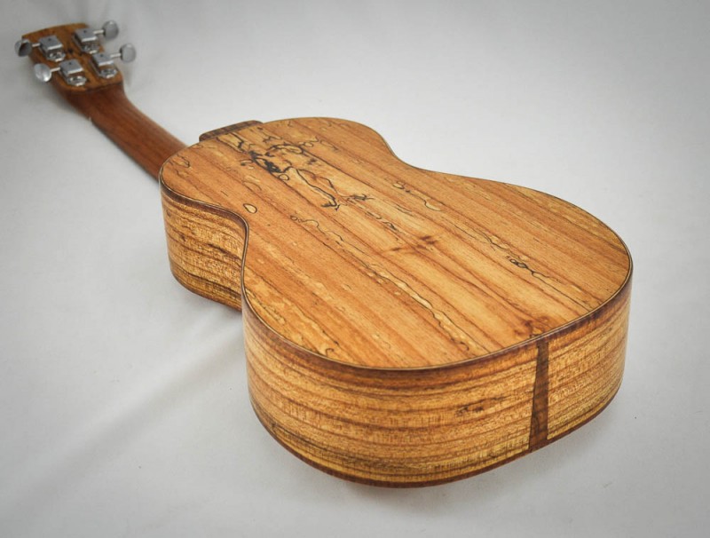

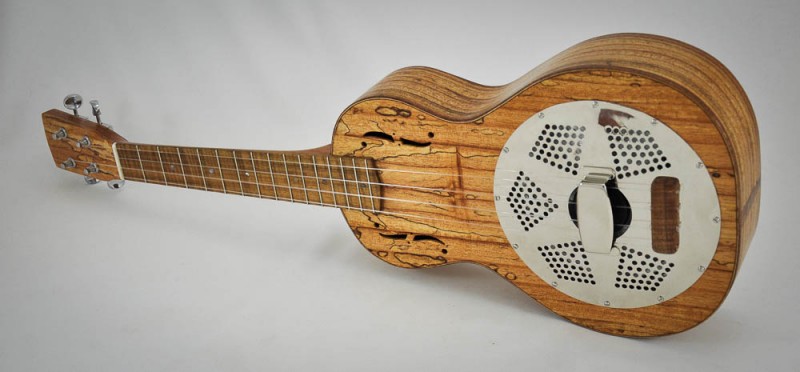

I've been very busy lately building a website and learning photo editing but have somehow found time to complete another resonator uke.
This is a tenor scale resonator uke featuring:
Cone: National
Body woods: Spalted white cedar
Neck: Spanish Cedar
Fretboard: Curly Aust. blackwood
Bindings: Curly Aust. Blackwood
Strings: D'Addario J71s
Finish: Satin lacquer

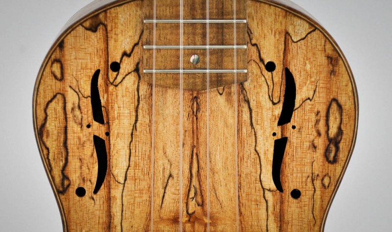

Wow, that's a very lovely uke. The ff soundholes in the middle of the spalting figure are a ripper.

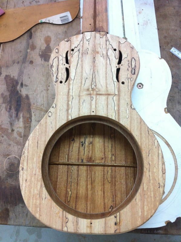

The only build pic I could find Miguel

Very nice build Liam, I like the spalted look and the 'stripey' sides. The bindings are very complimentary too, contrasting bindings without being too contrasting :cl :cl

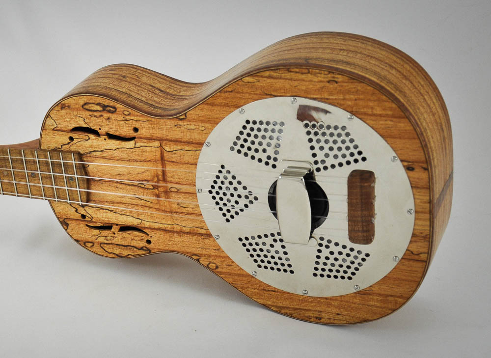

The cone is a single Tricone? and where did you get a cover that's small enough or do National make these for this sort of purpose? I have a cone purpose made for a cigarbox guitar size but have never found a cover for it, they 'usually' use an exposed cone in those little suckers but I'd like to put a cover over it.

A single tricone, is that the oxymoron for the day? :D
The cone and biscuit are a national resophonic ukulele cone/biscuit from elderly. The coverplate is from republic guitars, although national sell these too. I added a custom tailpiece/string anchor as I was unhappy with the way the republic ones work.
The cones are pie tin thin. There's no way I'd leave one without a cover.

Sexy...! Tailpiece looks suspicious though. How does it work?

Suspicious? Like it stole something? :D
There's three holes per string. It works the same as an 18 hole classical guitar bridge.

Man that hole looks big ! Did the soundboard have a flaw that made it unusable as a "normal" uke or did you have to carve out a huge hole in a perfectly good soundboard?
Brilliant result either way but I'd have sleepless nights doing the latter.

Miguel, there's no way I'd use that timber for the top on a regular uke. It has none of the qualities you want from a soundboard, that being light, stiff and even in consistency all the way across. It is light but it hasn't got the other two.
