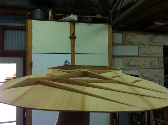

With the soundboard bracing I made the bass side carry less mass then the treble,
So the treble side carries a scolloped X and the bass tapers off pretty hard,
Same as tone bars, Heavy/Taller treble side then I taper them off reduce mass bass side,
My theory was/is -- More mass = more treble
Less Mass = More Bass
Instead of trying to just improve 1 or the other with symmetrical bracing why not try increase treble and bass with non-symmetrical bracing .

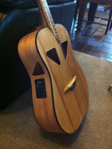

just copped a french polish, 8-10 sessions , then a polish with Maguires car polish and some carnauba wax ,
sound port and Fishman Blend pickup preamp

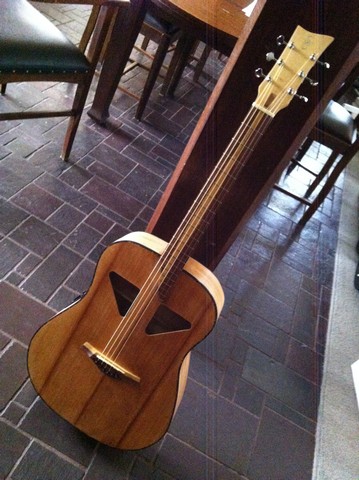

first string up no polish

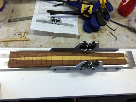

2 piece mulga
my experimental X and tone bar bracing

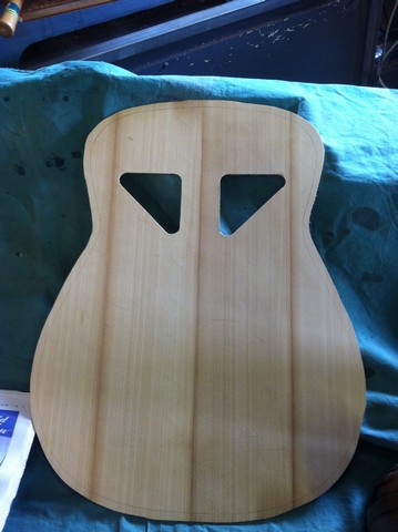

4 piece hoop pine top

Just a little constructive criticism if I may? If you get the chance, investigate the three modes of vibration a soundboard undertakes (monopole, cross di-pole, and Long di-pole), a soundboard doesn't seperate out bass sides/frequencies and treble sides/frequencies, it vibrates as a whole. Keep an eye on the "bass" side of your top for bellying as that leg of the X brace just looks a little light to me (as compared to it's "treble" cousin) for structural purposes.

Nick wrote:Just a little constructive criticism if I may? If you get the chance, investigate the three modes of vibration a soundboard undertakes (monopole, cross di-pole, and Long di-pole), a soundboard doesn't seperate out bass sides/frequencies and treble sides/frequencies, it vibrates as a whole.
(Greg)I will indeed look into that, criticism is good, water me , watch me grow,
Nick wrote: Keep an eye on the "bass" side of your top for bellying as that leg of the X brace just looks a little light to me (as compared to it's "treble" cousin) for structural purposes.
Did you notice the little brace across the back of the bridge plate, ? I thought that might be a bit of added structural-ness .
Upon playing this I do feel I have taken a bit much out of the bass side X, but , now I know,
Bellying, the top on this thing is so sensitive to humidity , its like a wave at bondi, up and down - up and down-
Cheers for your thoughts,
Greg
Re: Build No.3
Post by Nick » Thu May 16, 2013 6:39 am
greg c wrote:Did you notice the little brace across the back of the bridge plate, ? I thought that might be a bit of added structural-ness .

I fully support people branching out with their own experiments! Regarding talk about the braces, reminds me a bit of Santa Cruz's straight tapered bracing, only you've started the taper quite a bit closer to the X. I think you can still taper 'em out like that and have a structurally sound instrument, just maybe not so slim and start a bit farther down the brace, like these here:
