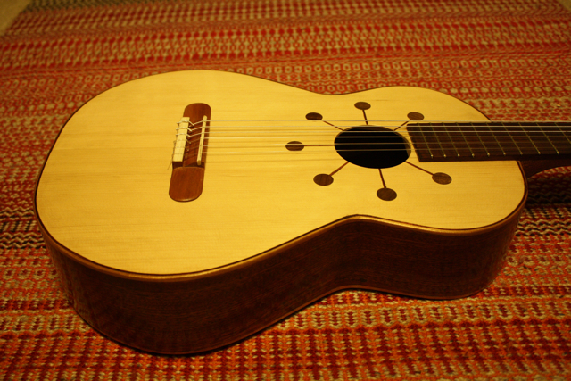

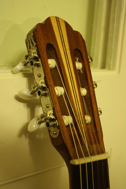

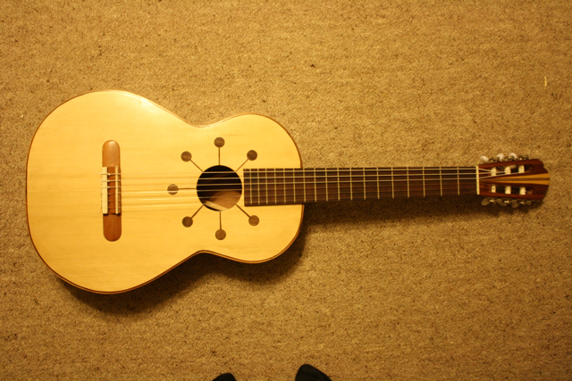

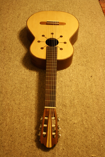

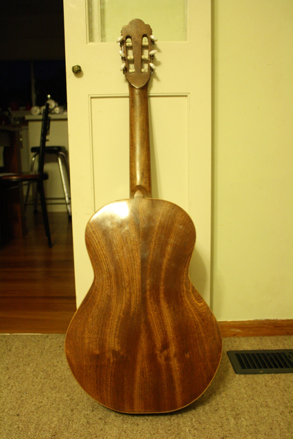

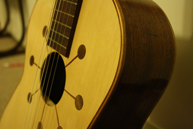

Not the old-time guitar brand, but a guitar I made for my daughter Stella! The rosette is based on 'starburst' clocks from the mid-century modern era. The top is kahikatea, sides and neck are recycled mahogany bedheads, bridge is totara, binding is kauri and the headstock veneer is Australian lancewood with the sapwood forming the cream coloured area. Oh and the fretboard is gidgee. It is based on the Jose Ramirez 613mm scale plan but I tried to stiffen up the back and experimented with grading the top quite a lot. It doesn't have a lot of immediate responsiveness but it does have good headroom for the size, with good clarity in the trebles.
