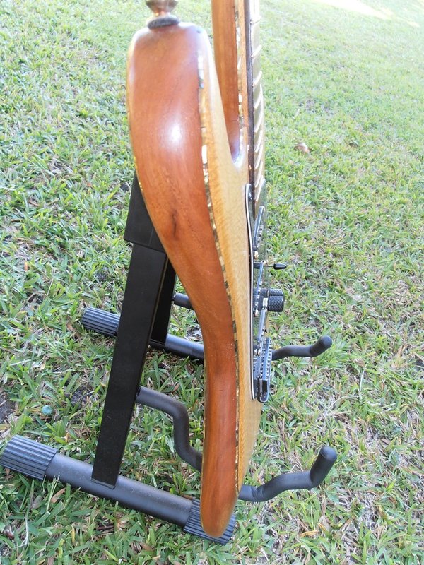

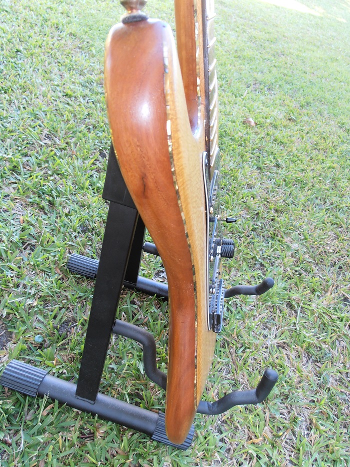

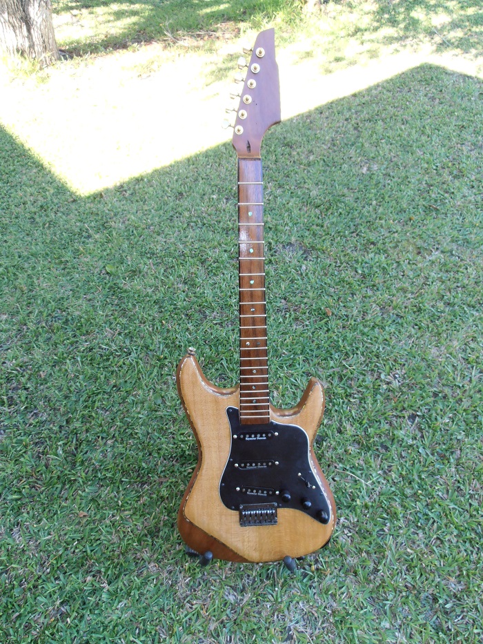

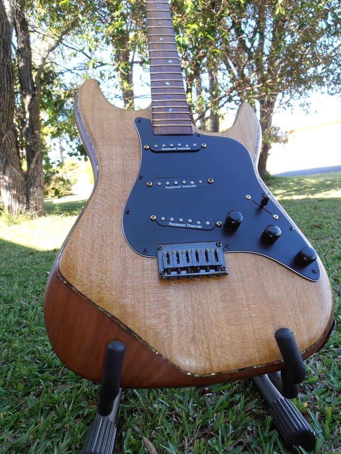

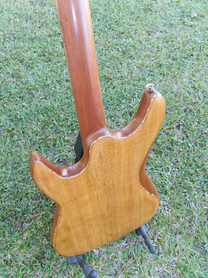

Apart from another acoustic guitar build, this has been keeping me busy.
I had a Strat style guitar that I carved out of one block of Australian red Mahogany Turned out to be a great guitar but HEAVY way to heavy to play all night with out doing in the back :(
So I went crazy with the router and chambered it, then capped top and back with some nice silky oak, a little more adornment, and now a lot lighter and I think better looking Guitar.
