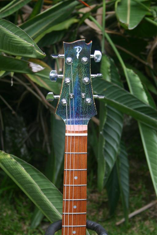

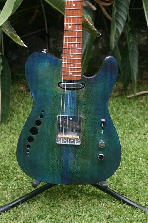

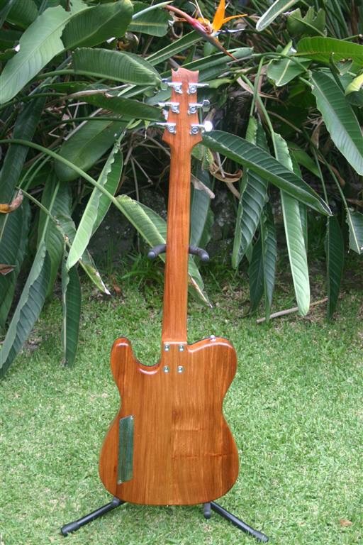

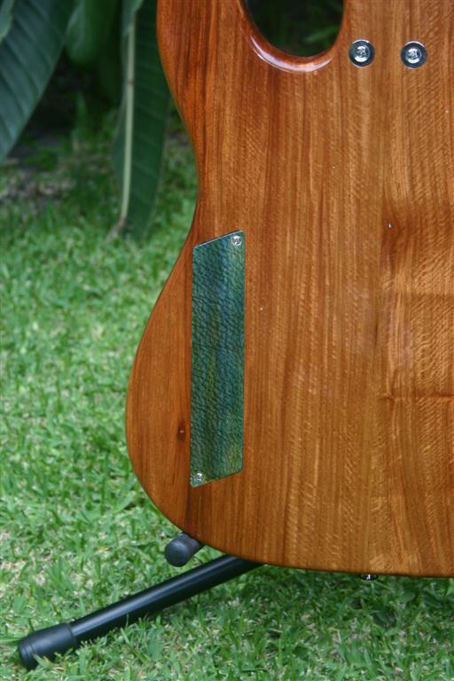

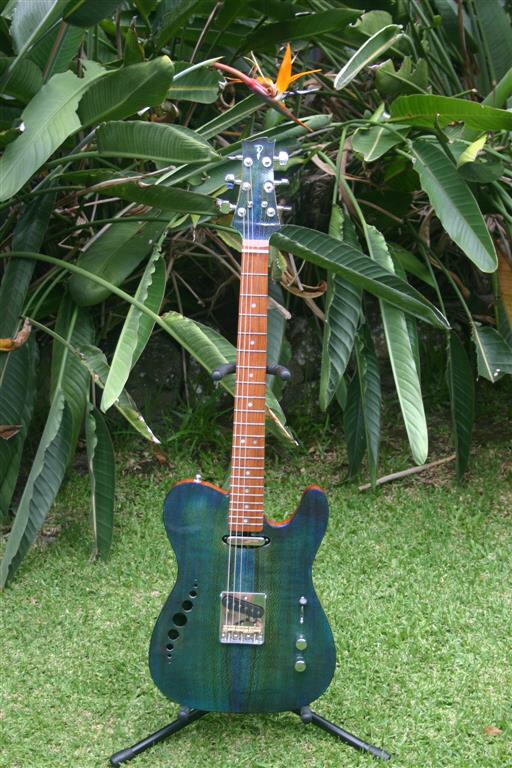

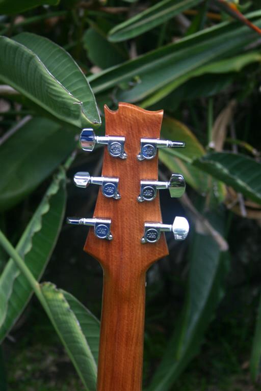

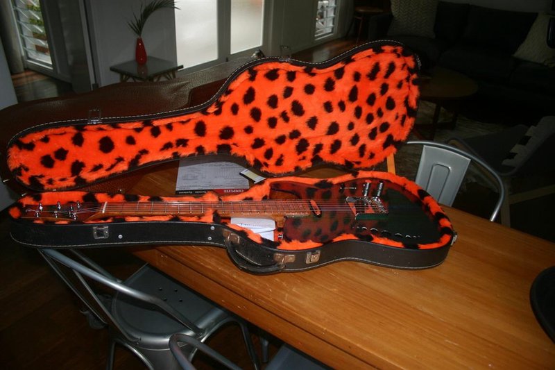

As my Tele is my favourite electric, I thought it might be fun to build one. I changed the headstock, and experimented with a couple things I had in mind. Celluloid binding, and aniline dyes, specifically, and here's the result:
Body and neck: New Guinea Rosewood leftover from a project in the house.
Cap and head plate: Silky Oak.
Binding: Blue Celluloid.
Hardware: Mostly Wilkinson.
Pick ups: ToneRider Hot Classics.
Finish: Mirotone 3220
Case: Leftover project from an old white strat I used to have.
Still going to drill and install the body thru ferrules, but I wanted to make sure nothing needs moving around first...
This is my first electric, and so far, i'm pretty happy with it. Needed to re-do the 4-way switch, but that's all...

Looks good. The die seems to have worked - any complaints?
How is the body "chambered" - did you route out sections or is it more open inside?

Duuuuuude, that case's lining is hurting my eyes!
Nice job with the Tele, I like the washed out denim look of the stain job. What do you think of the toneriders? I got some a while ago, didn't think they were too bad for budget pickups.

Nick: The case was meant for a white strat I had, and matches the strap I used on it. The lining was cactus, so i picked Fred Flintstone's suit....I do like the way the silky took up the dye in different ways depending on the grain....The Toneriders are pretty good. As good as any of the Fenders I've heard, and this set is wound a bit hotter than standard, so a bit more ooomph...9.3 on the bridge, I think....Worth $85, at least...

Thanks Steve, Greg, sorry I missed your questions. The dye takes getting used to. I watched NZ Nick's tutorial on his tobacco burst, but failed miserably at doing something like that, so I just wiped it on and rubbed in circles till I got something I liked. The dyes I got are really powerful and only need a little bit for a whole guitar. The body was routed out about 50% x 3/4 the depth, if that makes sense. Really, just to get the thinline effect......cheers.

Nice guitar and it is a well executed burst Nick- Looks very organic! Were they powdered dyes?

Hi Stu. Thanks, and yeah, the dyes were powdered, and from Guitar Australia, IIRC. Comes in 5 colours, red, black, blue, yellow, mahogany, I think. Some dissolves well in water, and some better in solvent but I only used water......Still plenty of colour....I reckon these jars will last as long as I am still making guitars...
