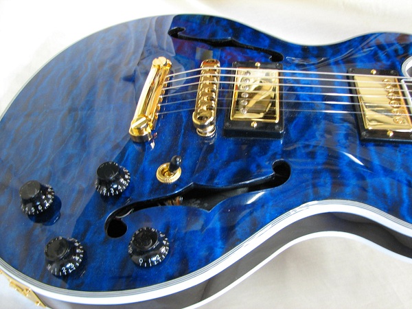

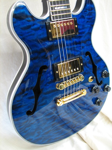

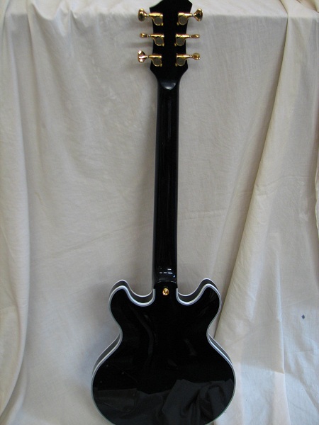

Well I started this commission ages ago but other events slowed progress and fortunately the customer didn't need it until this month as it's for his son's 21st. It was ordered after the customer saw the other CS356 I was making and fell in love with the shape and quilted top (viewtopic.php?f=5&t=5392, yes I know, I haven't posted pics of that one as I said I would. Mainly because I've been a slack bastard and haven't finished it yet! But I hope to in the next few months).
The customer liked the tobacco burst but when he surreptitiously asked his son what he liked, it turned out he prefered a transparent blue so I've basically followed the same colour scheme as a standard trans blue Gibson. He's also a big fan of the band Tool so I've tried to copy Adam Jones's pickup selection.
A few specs:
Body is Sapele with a quilted western Maple cap bound with B/W/B/W/B/W plastic bindings,
Neck is a two piece laminated Sapele construction with Ebony board and Evo gold fret wire, the Gibson MOP block inlays,
Pickups are Seymour Duncans, an SH1 ('59 Model) in the neck posn and a SH4 (JB Model) in the bridge, also with coil cuts via push/pull pots on both just for a little sonic variance.
Bridge and stop tailpiece are Gotoh items as are the 510 tuners,
Finished with Mirotone 3220 clear over blue colortone stain.

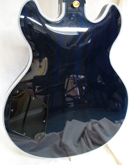

The next picture came out a little 'brighter' than the top really is
Quite pleased with the shine, great stuff that Mirotone, I've used and tried many different types of finish but throughly recommend the Mirotone. The back & sides look almost black in low light but really come up a beautiful blue in sunlight.
