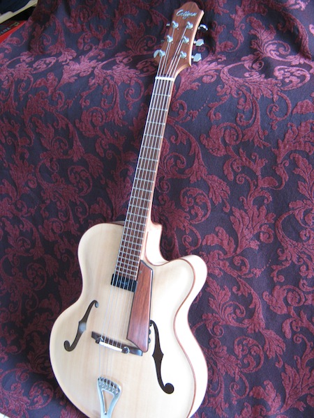

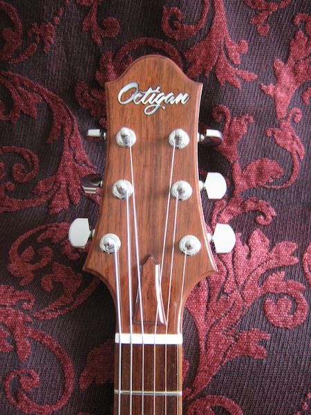

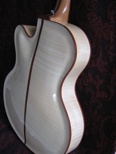

Well i don't know but i might take the record for the slowest build of an instrument, started this one about 13 months ago, needless to say the customer is very patient.
Anyways The 17" arch top has figured maple B+S, Sitka spruce belly, Qld Maple neck, IRW fingerboard, Jarrah binding and headplates, Seymour Duncan pickup, Schatten vol and tone controls, Schaller tuners, finished in Mirotone nitro.

Post by Allen » Sat Feb 22, 2014 5:57 pm
Damn. That's well.......damn!
That recurve shaping is about the nicest I've seen Rod. I'm in awe.

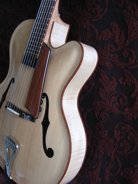

For my own interest, did you bind the F holes ? It's not obvious from the images - just looks like a super clean line.

Thanks Kev,l normally do bind the F holes to match the body but the client didn't want out done so i painted the cut edge black.

Ah, that's what it is. The F holes looked unbound from the top, but I could have sworn it was a black inner edge from the close ups.

rocket wrote:l normally do bind the F holes to match the body but the client didn't want out done so i painted the cut edge black.
May I ask Rod, what kind of paint did you use, and how did you prepare the edge that the paint would no bleed into the grain?

Markus, i sealed the edge and around the F holes withe a couple of good coats hard shellac and then i used some black tinted shellac to colour the edge.
