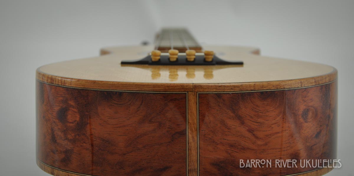

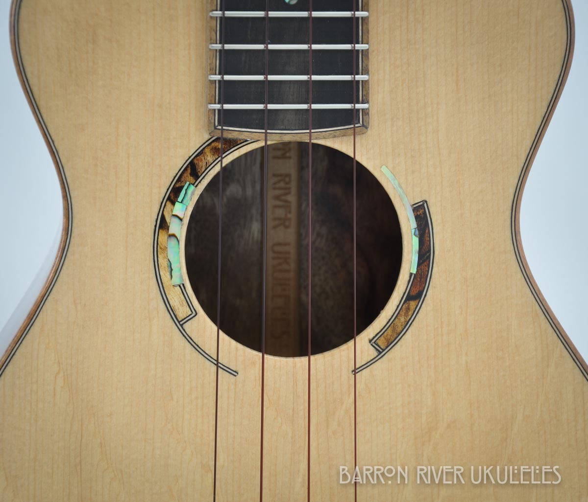

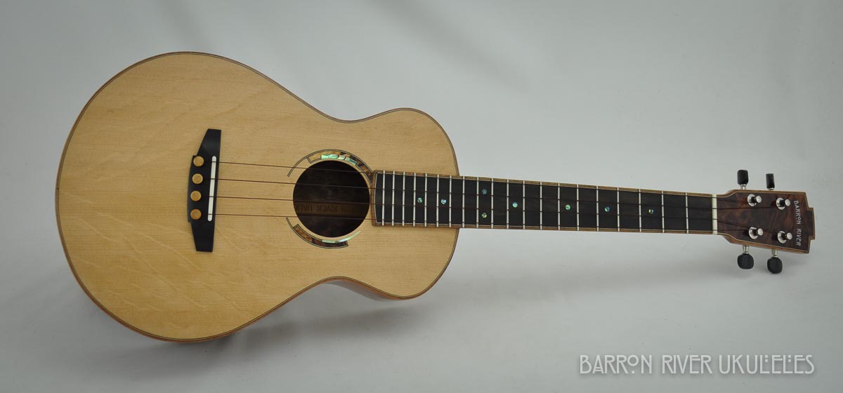

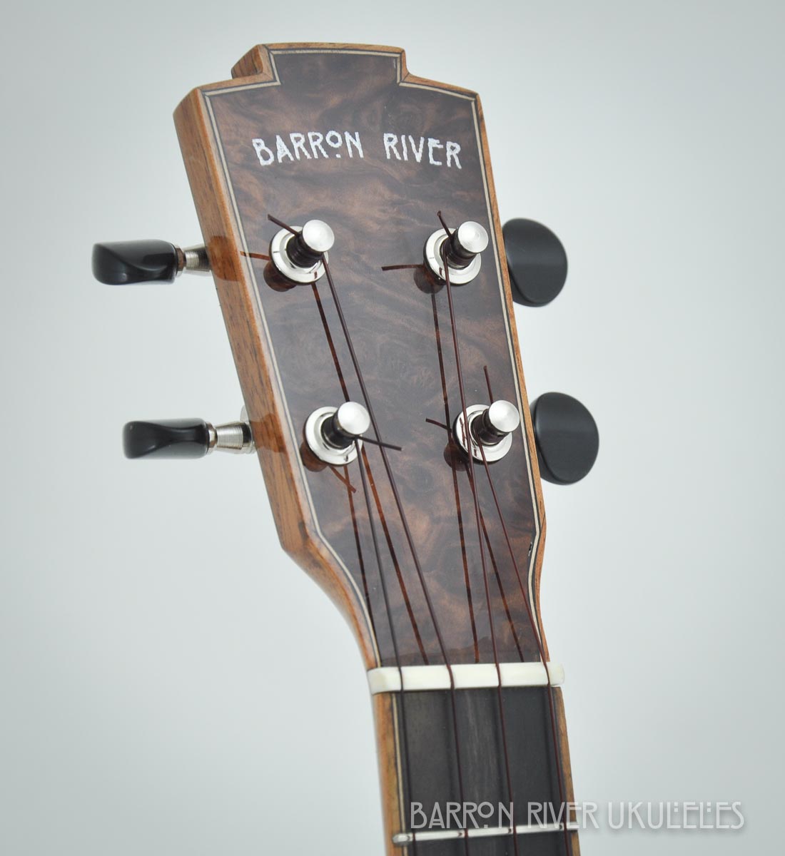

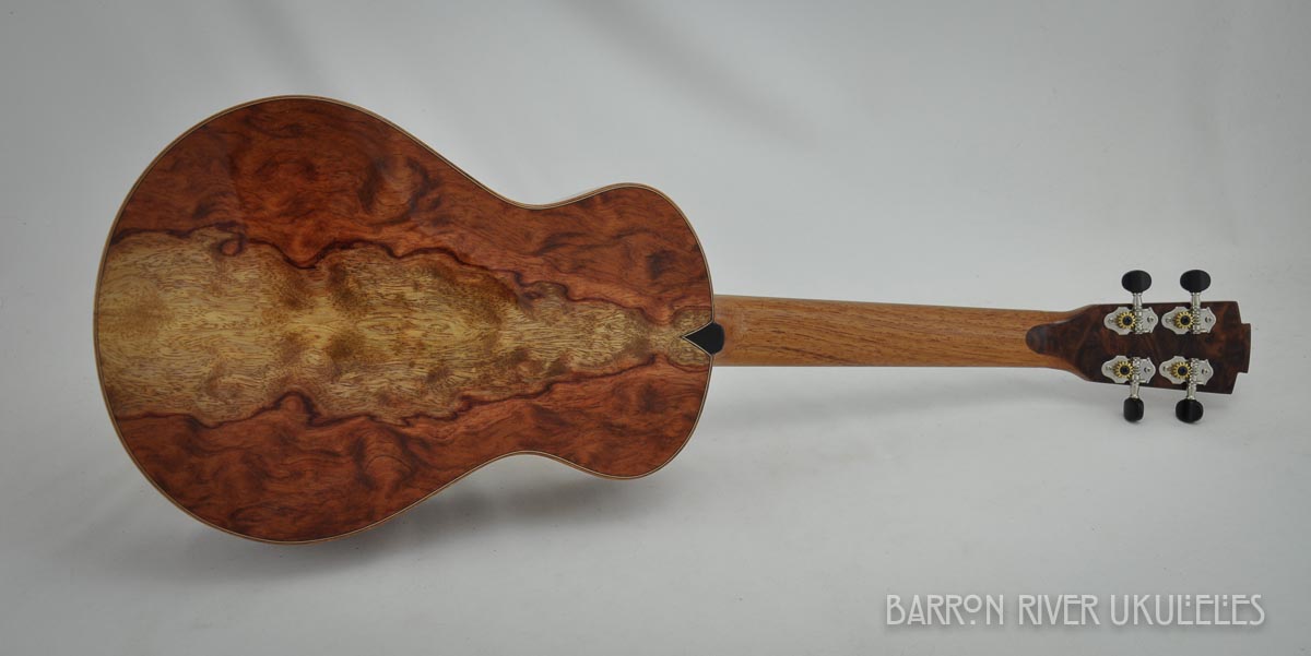

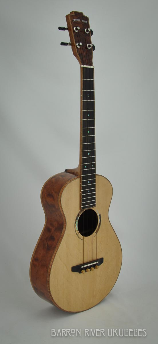

Post by Allen » Wed Mar 12, 2014 7:35 pm
I've used Babinga a few times and while it's beautiful to look at, it has to be one of the most difficult and hard woods to work that I've ever come across. And the pores are just gigantic, so it takes a lot to fill them.
Client is really fond of figured and pretty wood, so after quite a lot of photos of various sets I had available, he settled on this combo, with me to choose the trim as best I saw fit.
Top - Bear Claw Sitka
Back and Sides - Babinga
Neck - Spanish Cedar
Head Plates - Red Gum Burl
Rosette - Spalted Mango and Paua
Bindings - Australian Blackwood
Fret Board and Bridge - Ebony
Tuners - Grover
Strings - Worth
