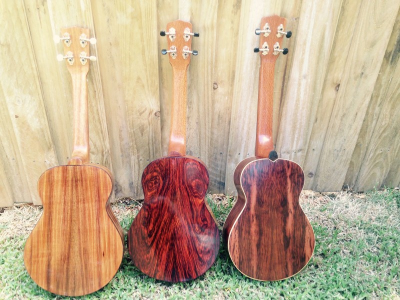

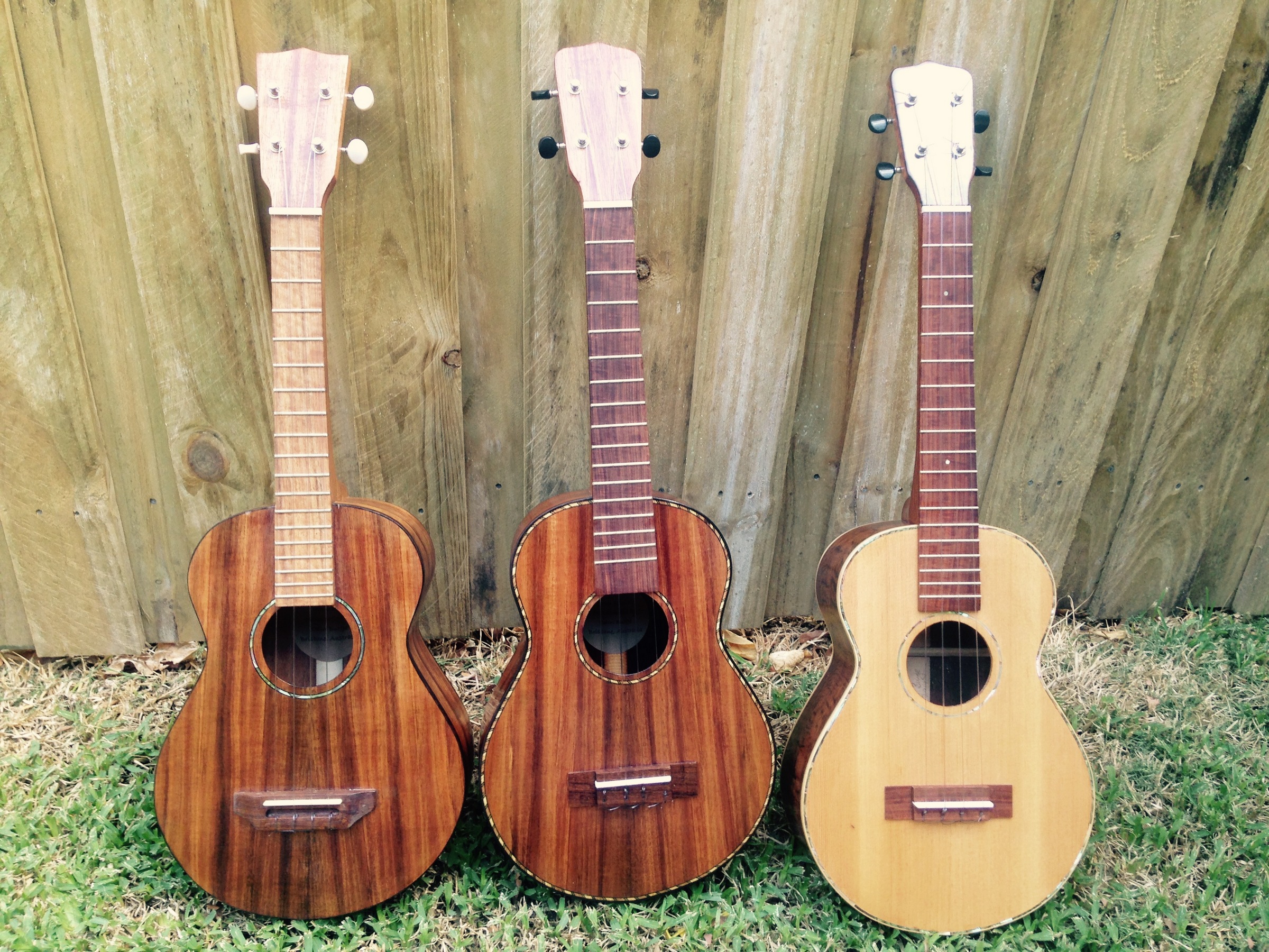

It has been a while between drinks, in fact over a year since I posted my first build. I managed to get into the shed and build these 3, one after the other. I made so many mistakes on each of them, I wouldn't be able to list them all, but came up with fixes. The mistakes will be obvious to you guys, but I don't care as I am still learning. They are all braced differently or are different in some way, but they all sound pretty much the same, which surprised me a bit. My first build made from native olive and spruce is the only one that sounds appreciably better, due to the spruce I think.
Number one is an all Blackwood with ebonised Silkyoak bindings, Qld maple neck and abalone rosette.
Number two is a Tiger Myrtle with Douglas Fir soundboard (I think), maple bindings, abalone purfling and Silkyoak neck.
Number three is Cocobolo with a blackwood soundboard, unknown bindings and rope purfling, Silkyoak neck.
All finished in tru-oil, all Tenors.

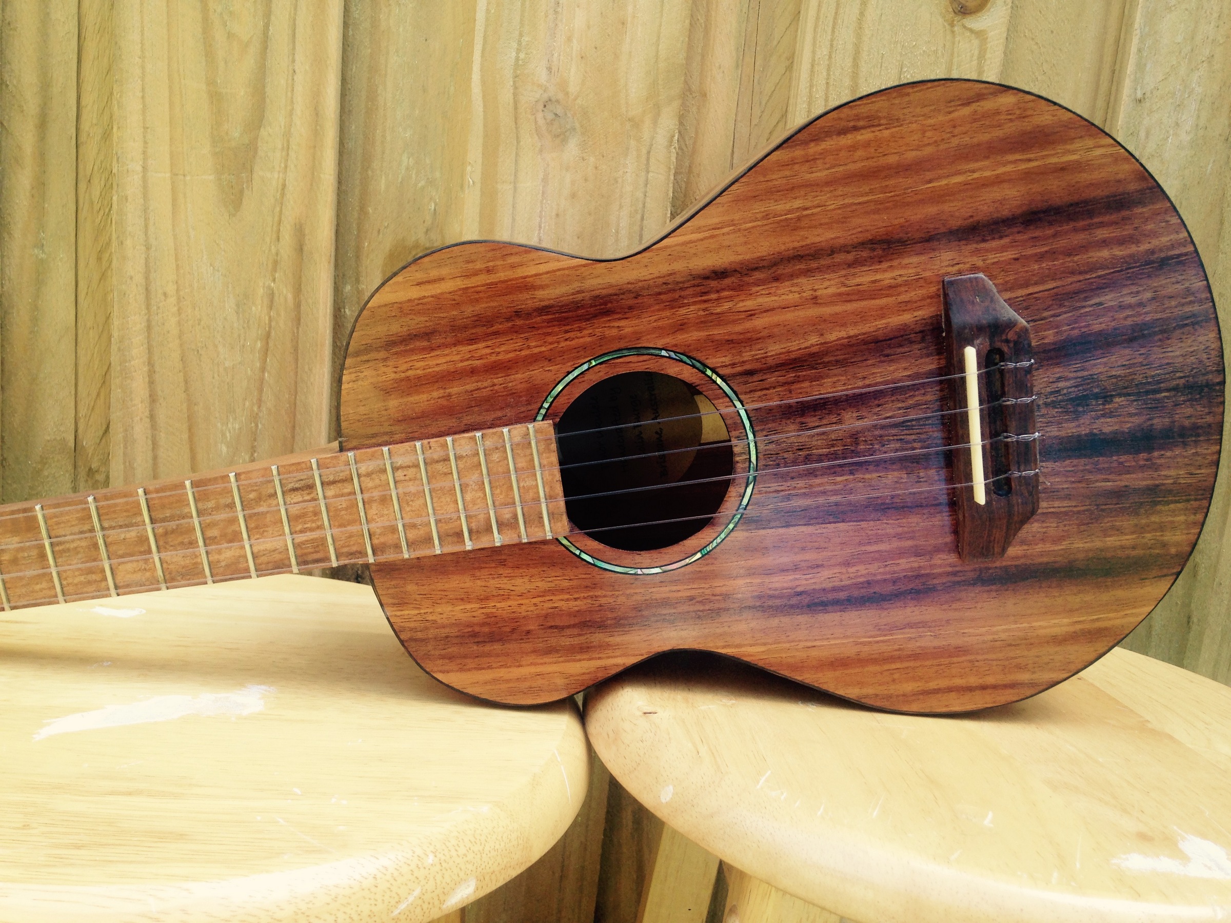

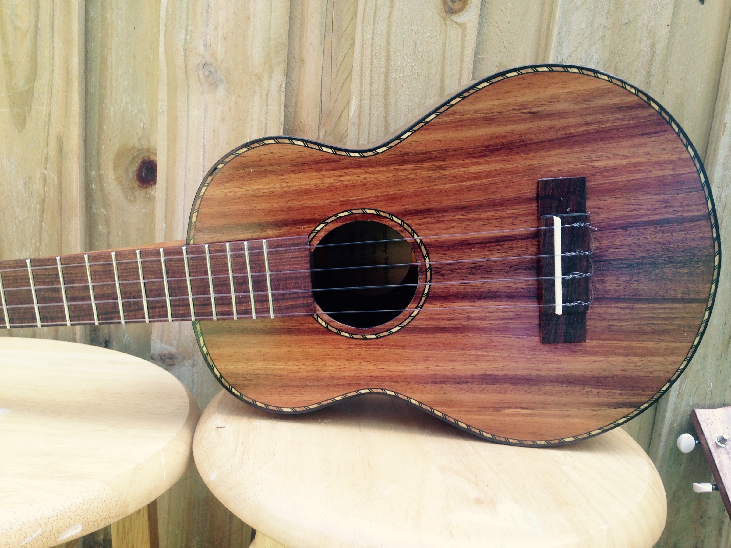

That tru oil finish is magnificent (pic 2 and 3) You must know something I don't in relation to the application of it.
Cheers Maurice

I put on lots of coats and rubbed it back in between with a scotchbrite, like other finishes. The last 2 coats were put on very thin, I just put a few drops on the surface and used a brush dipped in a little turps to spread it, didn't seem to leave brush marks.maurie wrote:Nice looking little ukes Col,
Cheers Maurice
Cheers Col

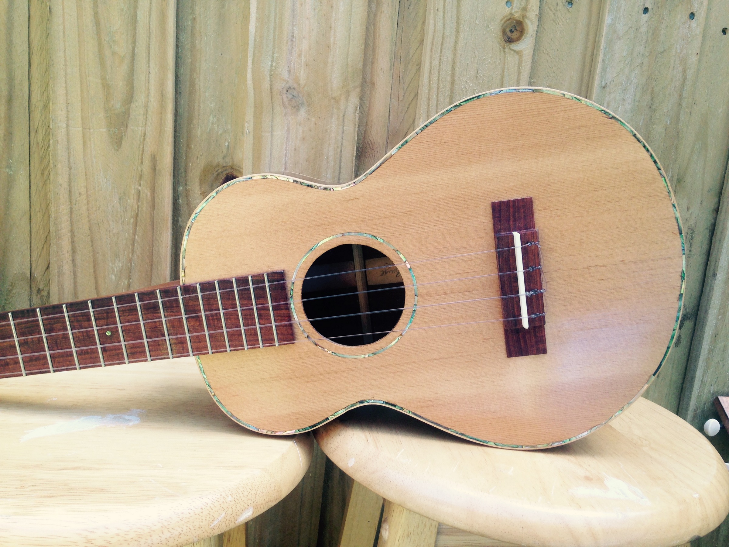

Great looking set of ukuleles. How does the fir top sound compare to the blackwood?
Re: uke builds two, three and four
Thanks - I was just playing them this morning and the fir definitely sounds better than the blackwood, it is louder and has more sustain.johnparchem wrote:Great looking set of ukuleles. How does the fir top sound compare to the blackwood?
