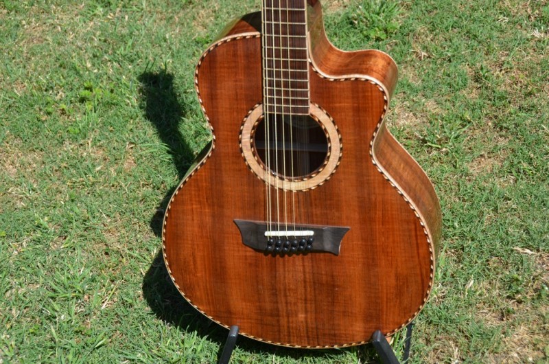

Post by Bob Connor » Sun Nov 30, 2014 2:44 pm
Just finished this and am putting it the mail tomorrow for Greg Luker.
It's all Blackwood with a Mulga fingerboard and Gotoh 510 tuners plus a K&K 12 string pure pickup. That's a Cedar Creek custom case made for this instrument which is a new version of our barge-arse (small jumbo) series.
Never done a Blackwood topped 12 string before. It's quite bright, thus the ebony bridge to try and tame the top end a little, and very loud. It should settle down being a very nice sounding instrument with a little playing.
A couple of very good players here in Geelong have taken it for a test run and they loved it.
Thanks for looking.

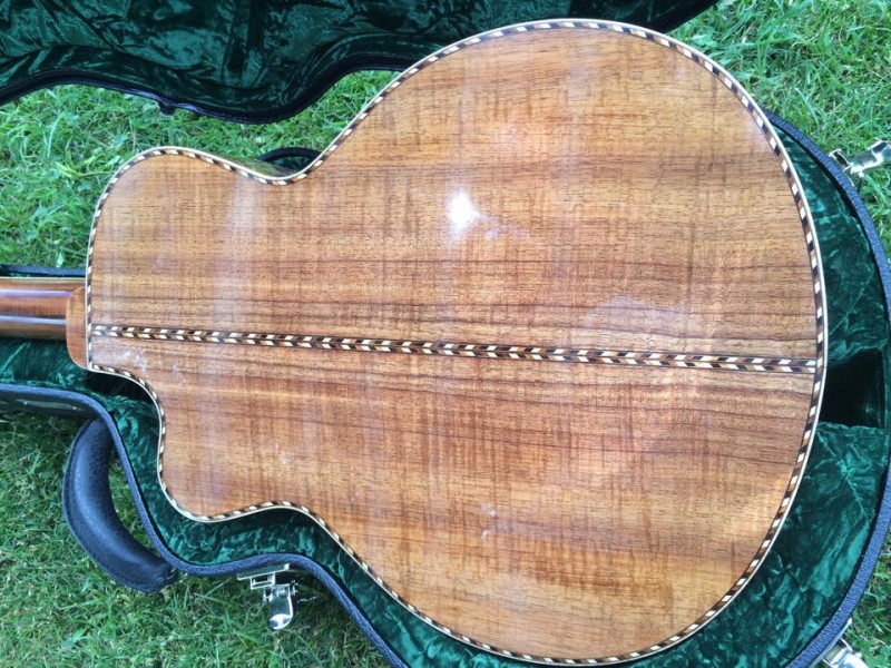

Love the shape and the back strip looks cool too.

Nothing like a well built 12 banger....this baby looks very elegant.
How did you go sorting out compensation?
Re: Blackwood 12 String
Post by Bob Connor » Sun Nov 30, 2014 8:06 pm
Each string is individually compensated Martin.
Which makes it a bugger of a bridge saddle to get a nice finish on. :D

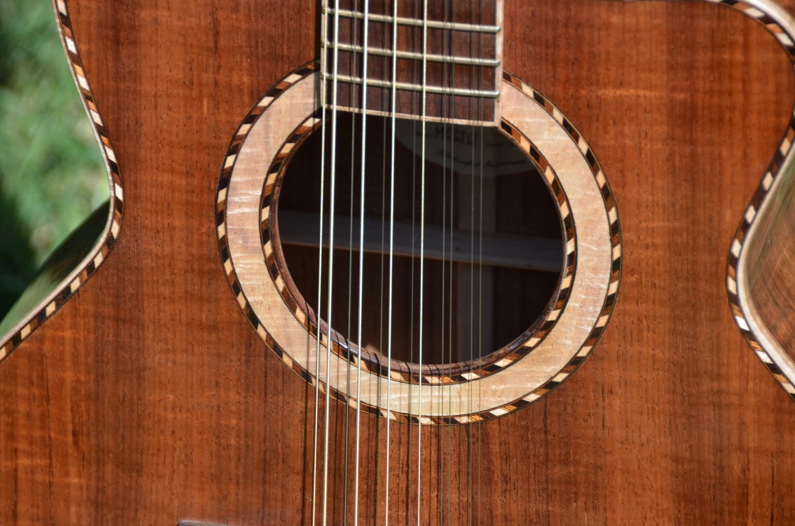

Interesting with the hardwood sound board and the rope perflings look a treat.

Very nice Bob :cl :cl :cl :cl :cl :cl :cl look great,
how thick did you go with the top out of curiosity ?
cheers,
Post by Bob Connor » Tue Dec 02, 2014 7:18 am
2.8mm Paul.
I also increased the size of the lattice bracing in the lower bout to 6mm x 4mm (usually 5x3)
