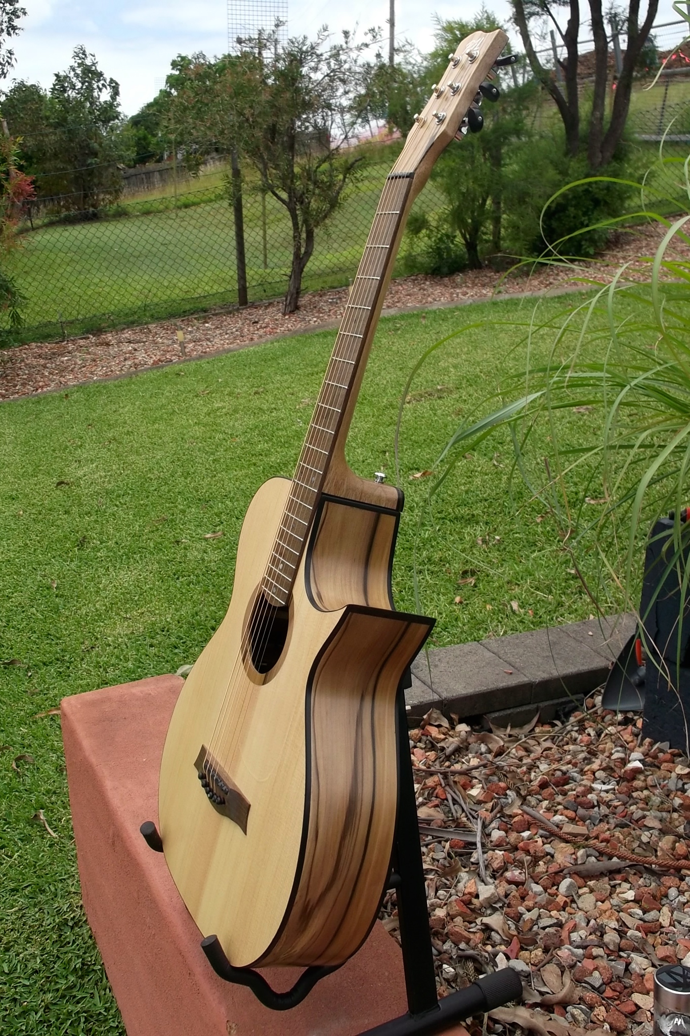

Hi all,
OM Cutaway.

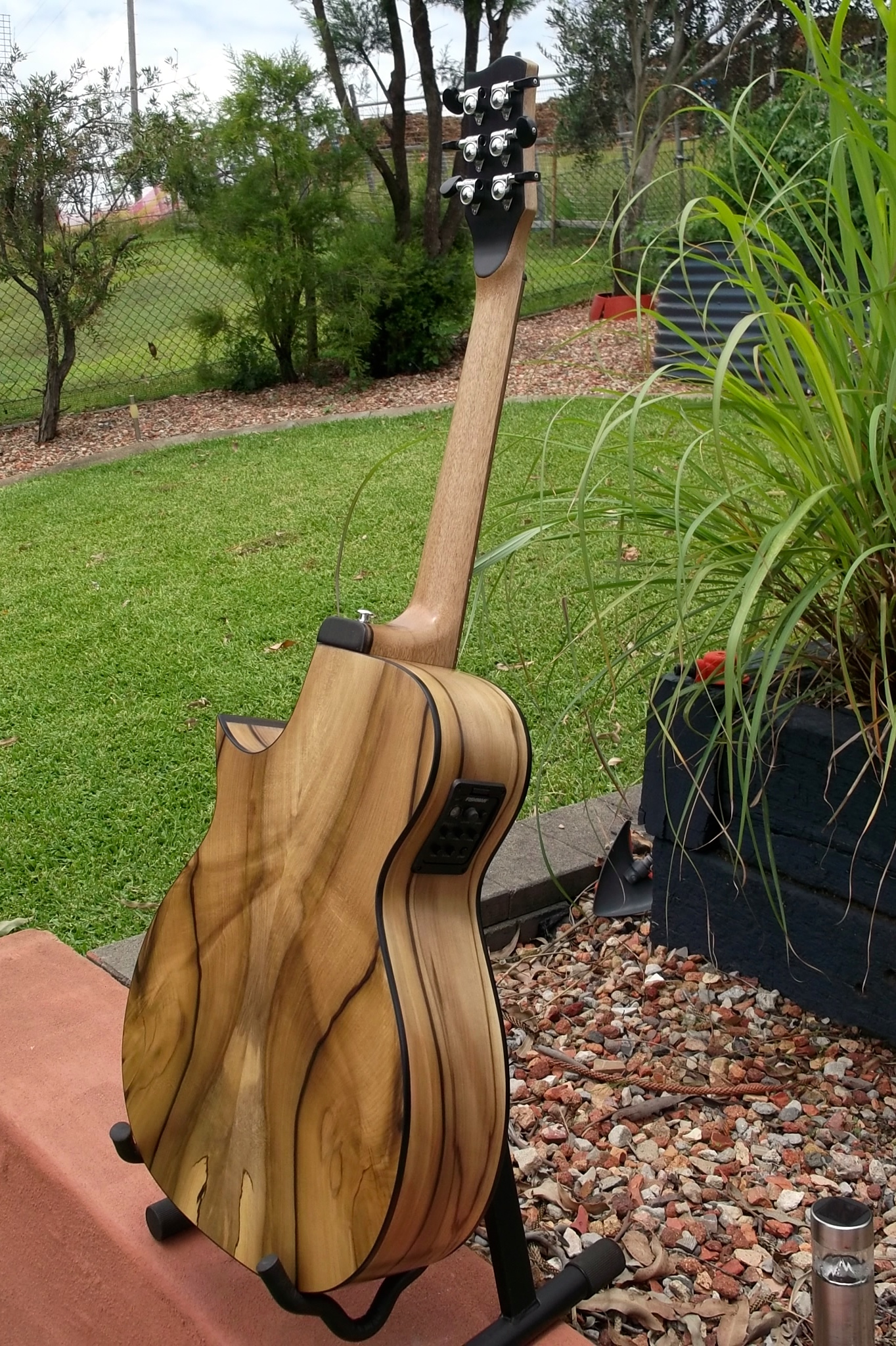

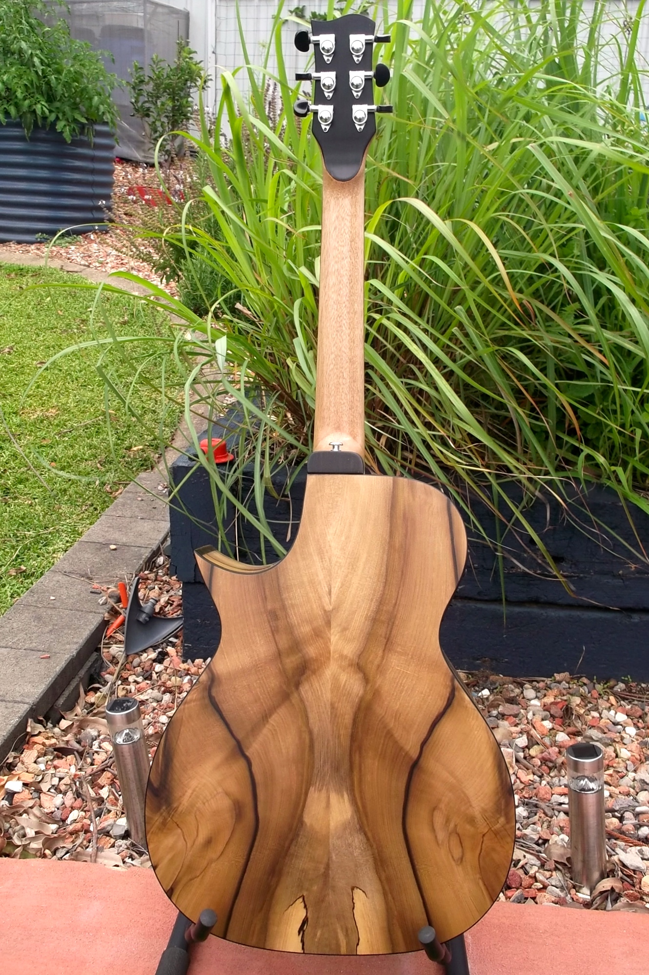

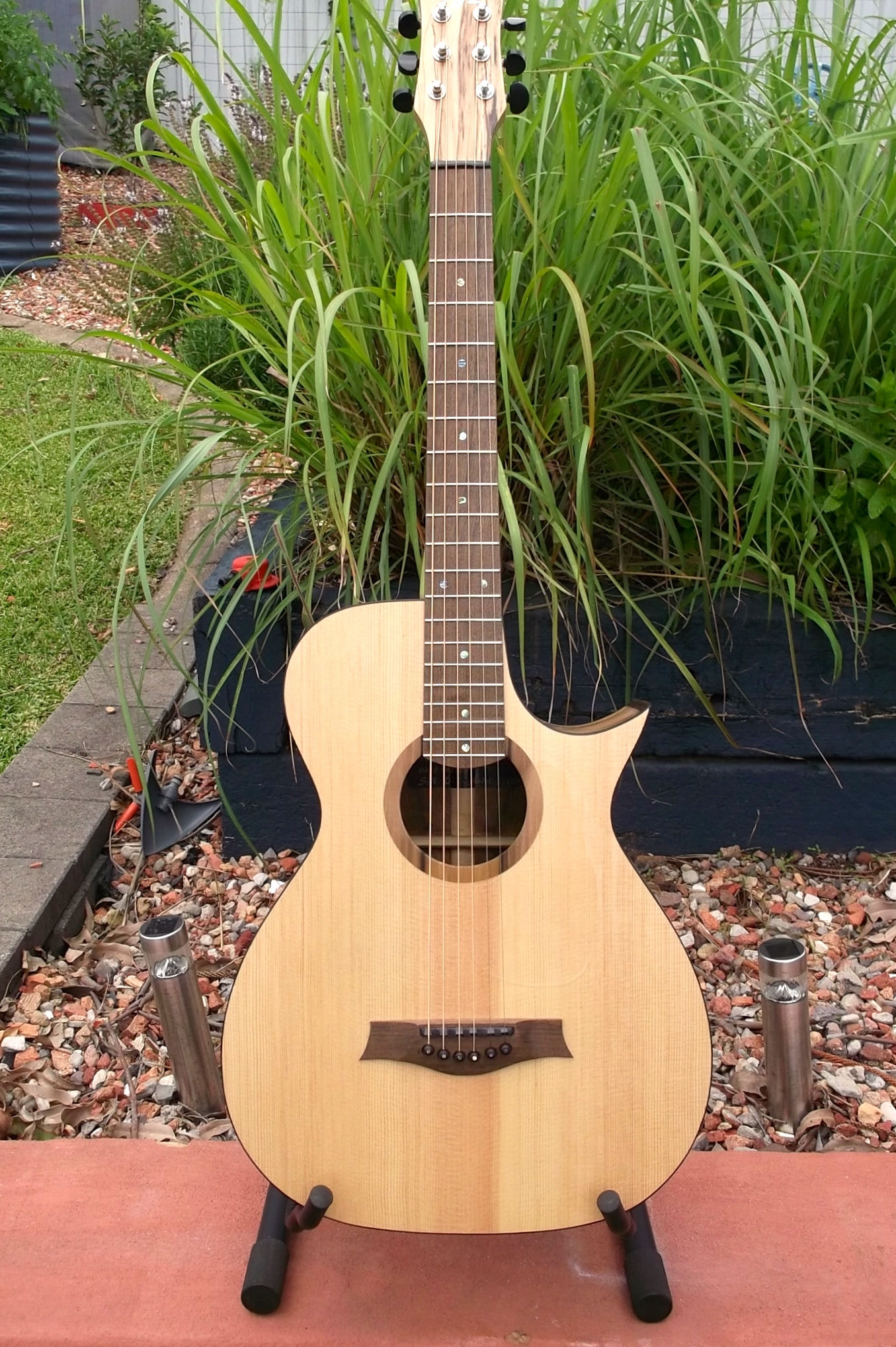

Back & Sides Black Hearted Sassafras
Top Is Lutz
Neck is Tim's Pepper wood or brown Beech

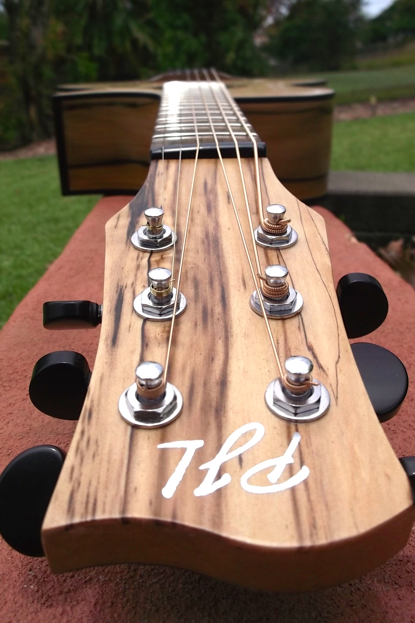

Head plate is spalted Sassafras
Fretboard and Bridge are Puriri .

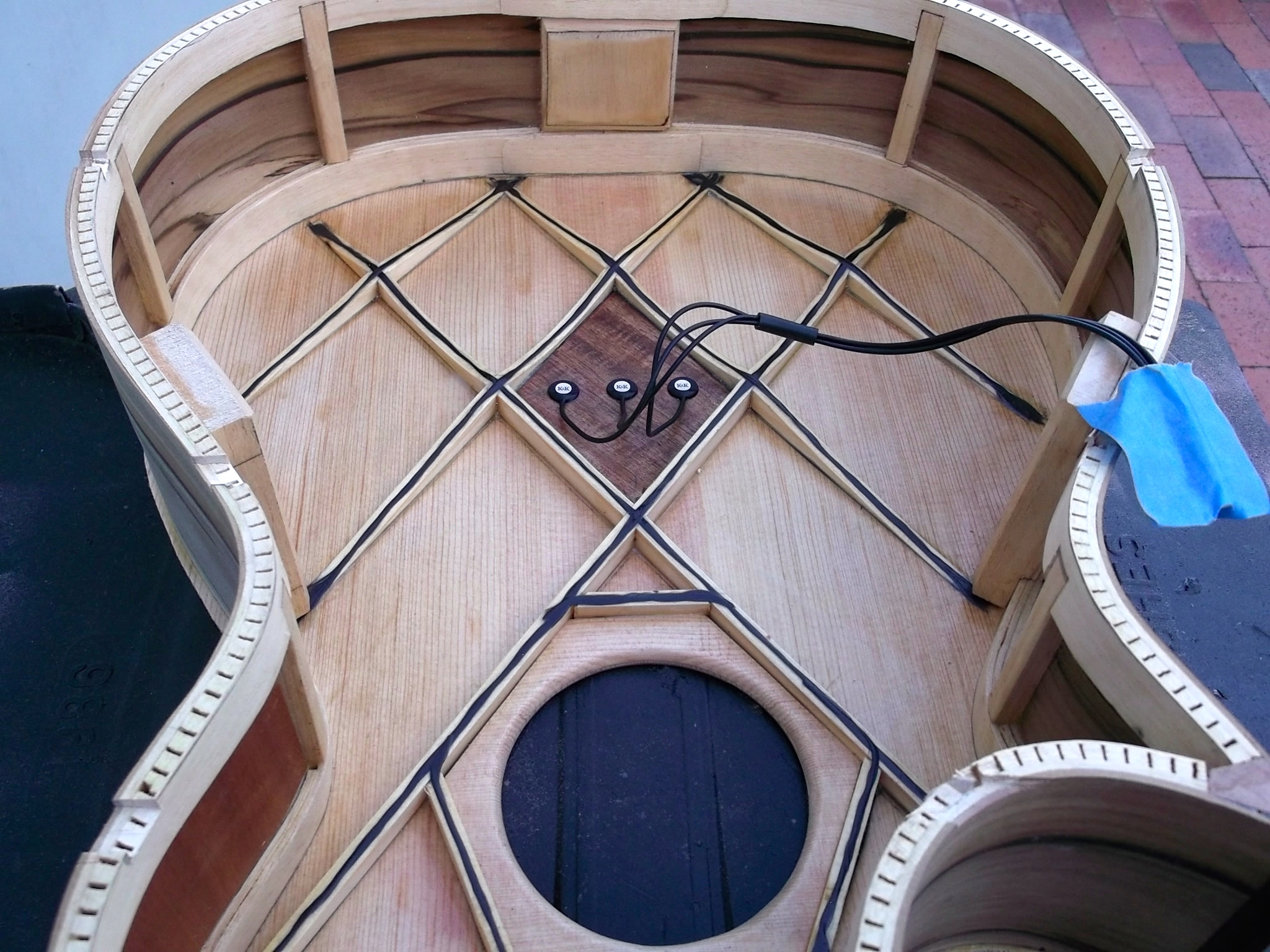

Bracing is Sparse Lattice.
Sounds pretty sweet.

wow, that is a stunner! love the contours of the bridge.

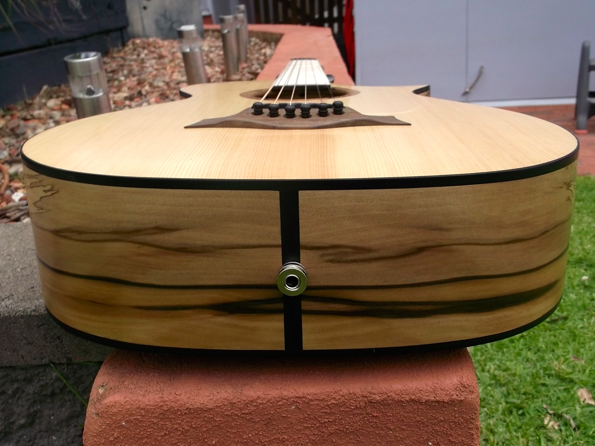

Post by GregL » Sat Dec 13, 2014 7:52 pm
Hi Paul,
That looks great! Is that ebony binding?

Hi Greg,
Thanks, No it's ABS I hate ebony as a Binding, it's hard to bend, get in the top wood when you sand and is just generally unpleasant to use, so ABS gives the same look , but without the headaches.

Post by GregL » Sat Dec 13, 2014 8:57 pm
Hi Paul,
Well, the ABS looks great! So is the veneer on the back of the headplate ABS too? It looks good whatever it is!

Post by ozwood » Sat Dec 13, 2014 9:01 pm
Hi Greg,
No that's the real thing!.
I just have an aversion to Ebony binding., Otherwise I always use timber.

Post by Nick » Mon Dec 15, 2014 6:07 am
Beeee yooou tea full. Nice job Paul and that Sass is stunning :cl :cl :cl :cl :cl
Is that the Tusq material you've used for your saddle?

Very elegant and I love the way the sassafras and puriri work so well together

Yes Nick that's Tusq or In the black color it's called Graphtec.
Miguel, I also love the way puriri complements BHS , it's a bloody nice timber all round.

What a great looking guitar - I am a great fan of florentine cutaways.

There's a lot to like about this one Paul, very clean and tidy on the inside as well.

Hi Paul.....A lovely Sassy guitar! Nice work on the lattice there too....:)

Thanks John ,
That top is WRC (Wood Rat Cast Off) the last of all the WRC's.

Very nice! That Sass really stands out. Very classy build.
