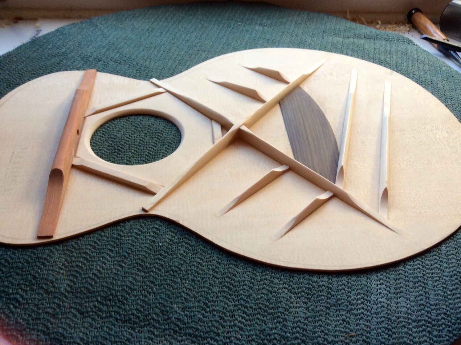

Sitka spruce x braced top

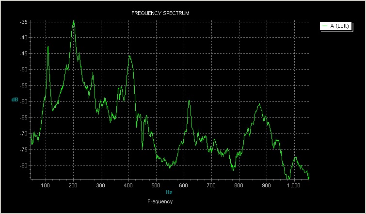

The frequencies are higher than I wanted but it sounds good and is well balanced. After it was complete I didn't take any spectrographic data for 2 weeks to see if I could hear any problems while playing. I could not find any weak notes. After analysing the data T1 and T2 are well positioned although a little high. In the step is to increase the scallop in the back lower brace.
Top bracing

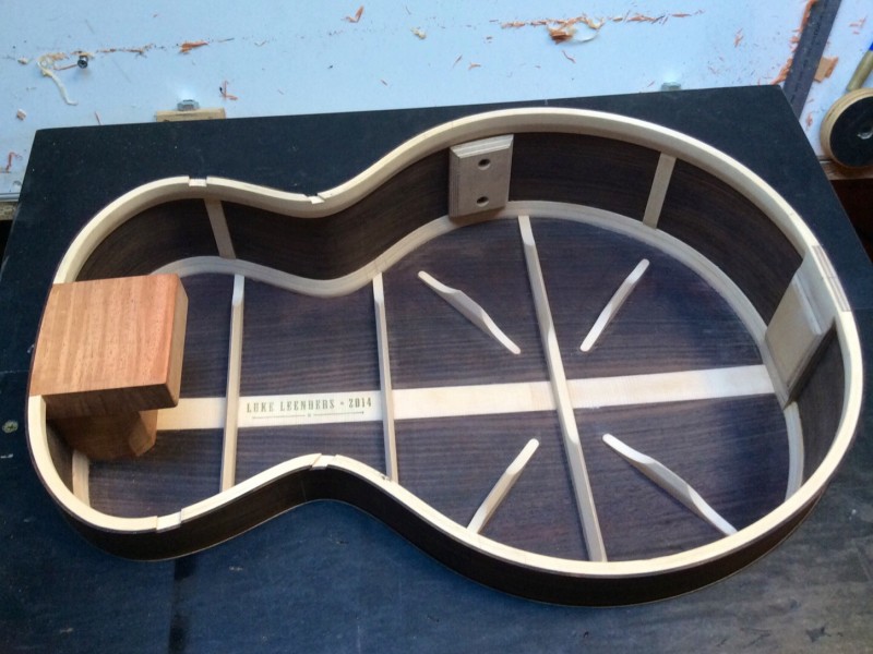

Back
I have not adjusted anything.
T1-107
T2-201.9
B1-268
Others 364 373 402 618 872

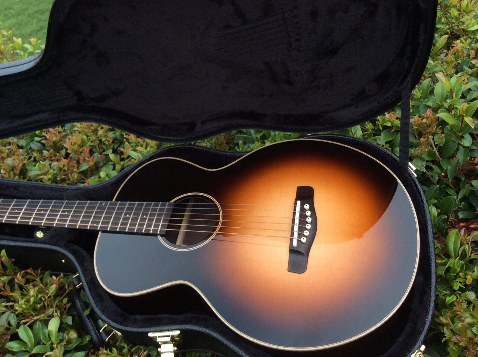

Oh, another "sunset"! :D

That is a really nice job Luke. I have always liked the old-timey look of the the L1 design, and the way it is all curves and no straight lines. I also like how your more modern bridge shape sits with the overall aesthetic. The rest of the features are really understated, which is just right. Did you work off a plan? Where did you get it?

IT looks killer, awesome job.

Great stuff there Luke. Fantastic attention to details, like finish etc and inside the box. And ya gotta love those solid linings. :cl :cl :cl :cl

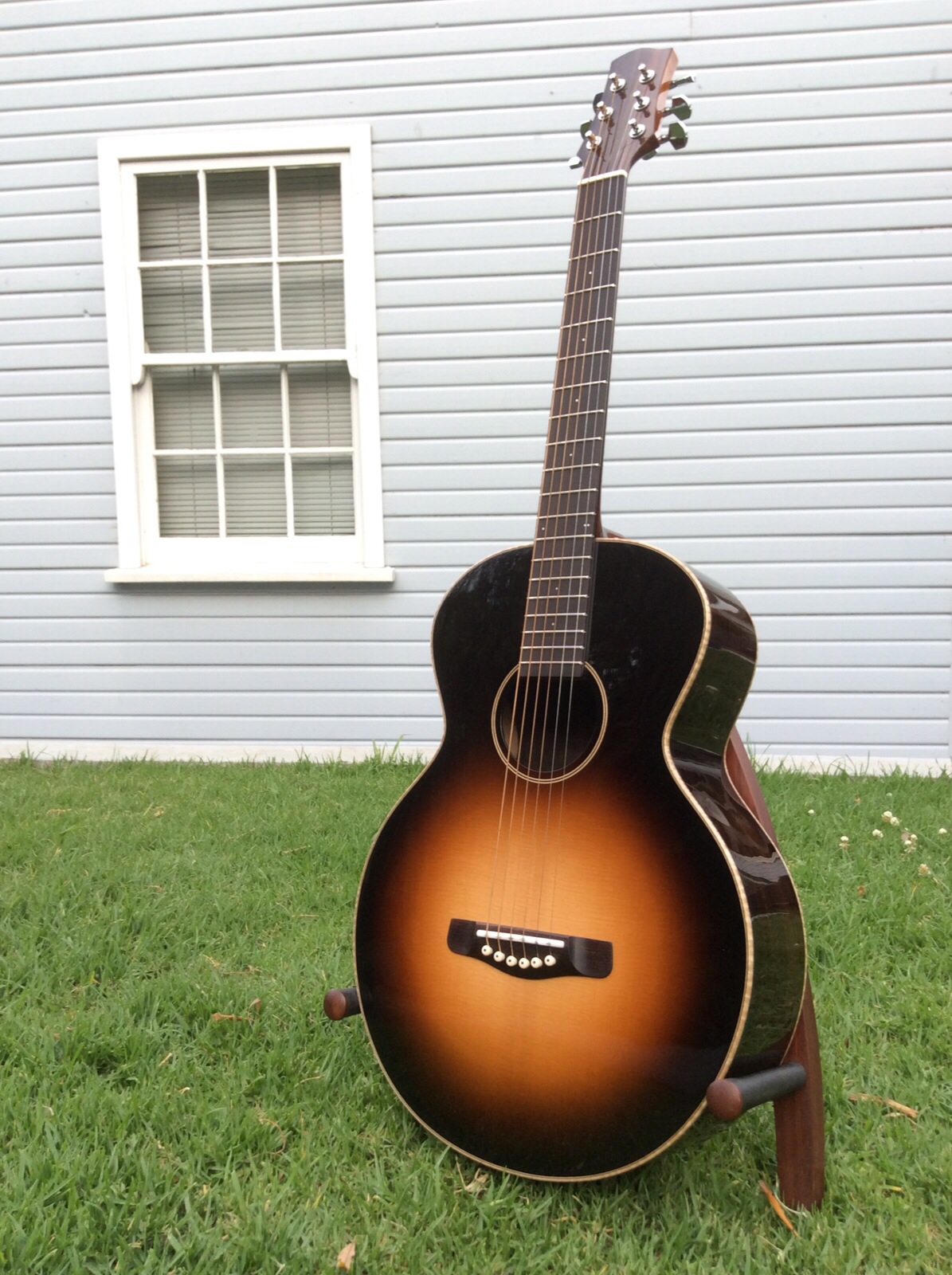

What a great looking guitar!

Nice job. great looking guitar.

Really nice burst Luke. Very elegant and classy looking guitar.

Hi Luke....that is a beautiful guitar!.....the tobacco burst is very nice and I like how the upper bout is all black and the burst is only in the lower bout....lovely interior too....WELL DONE!!!

Nice neat work inside that guitar.....nice work on the finish too.
