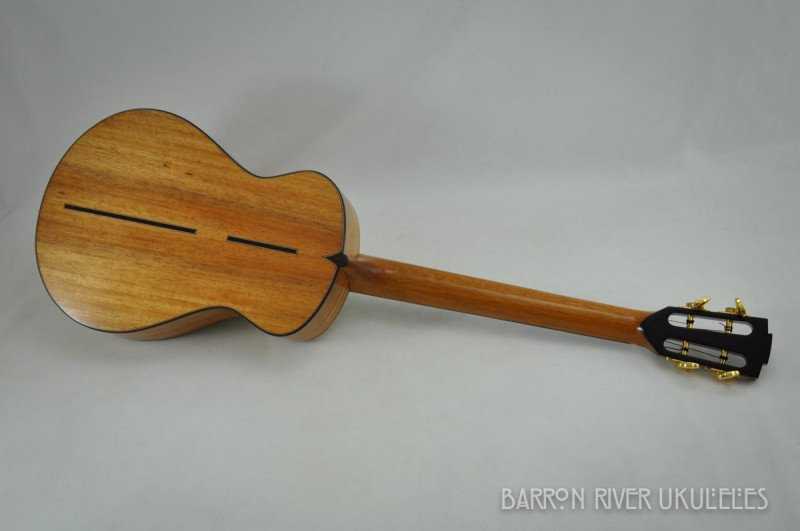

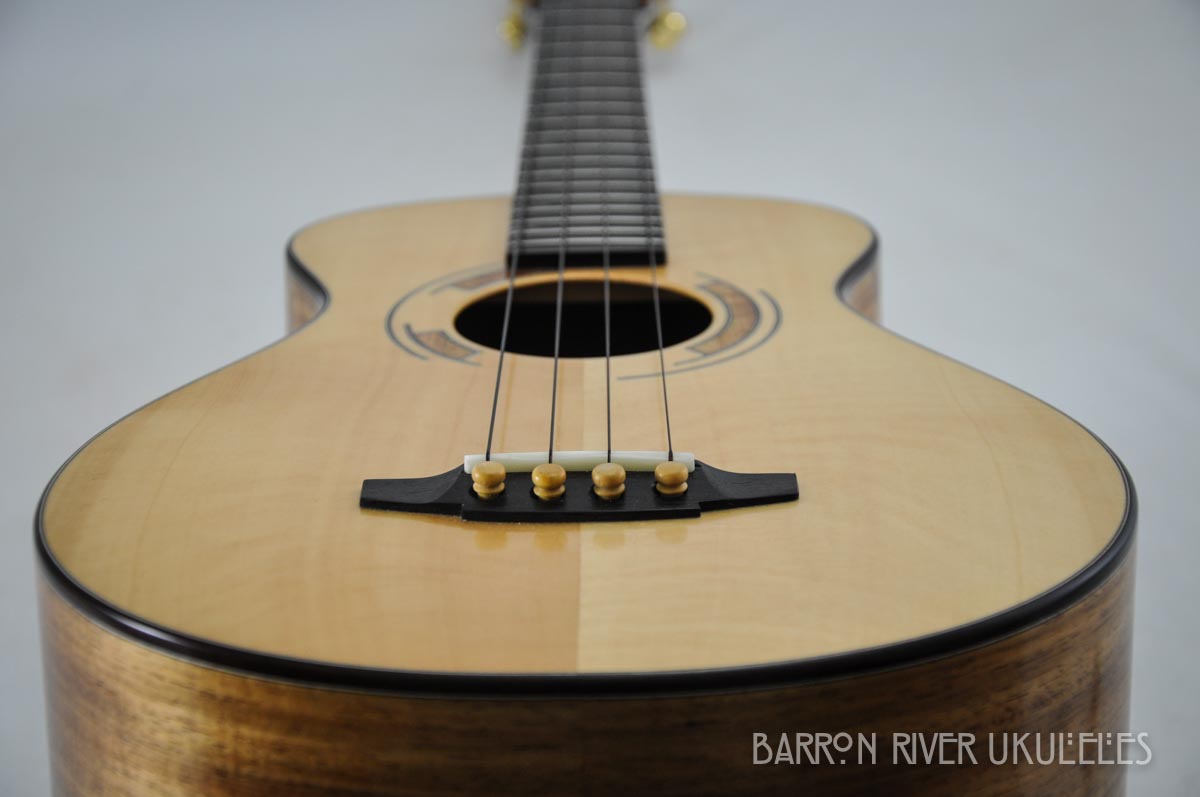

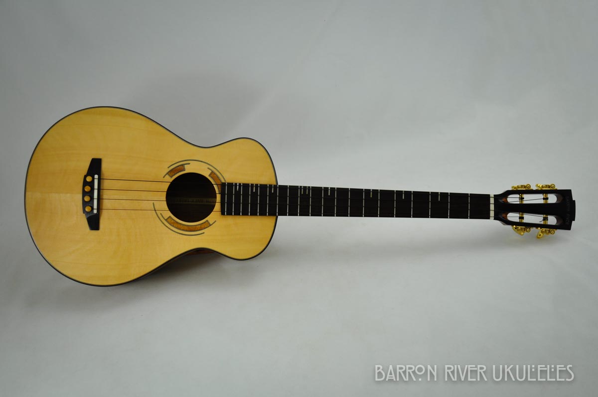

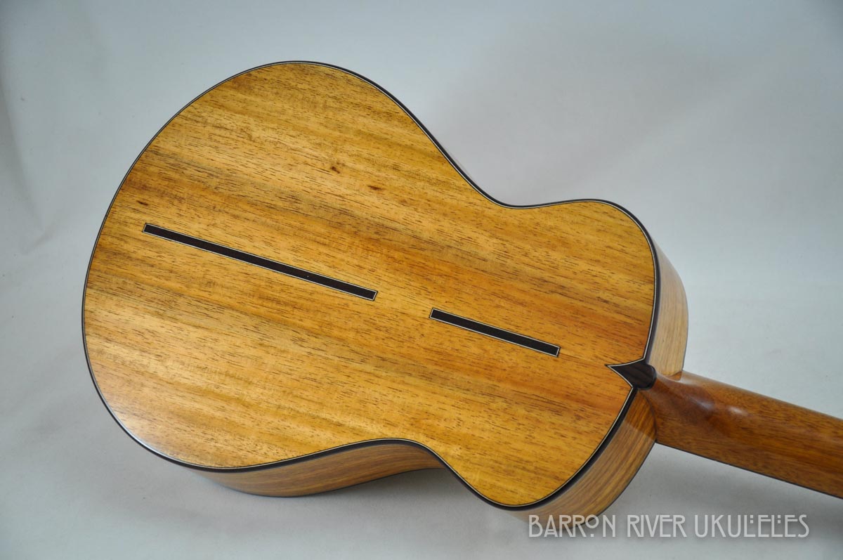

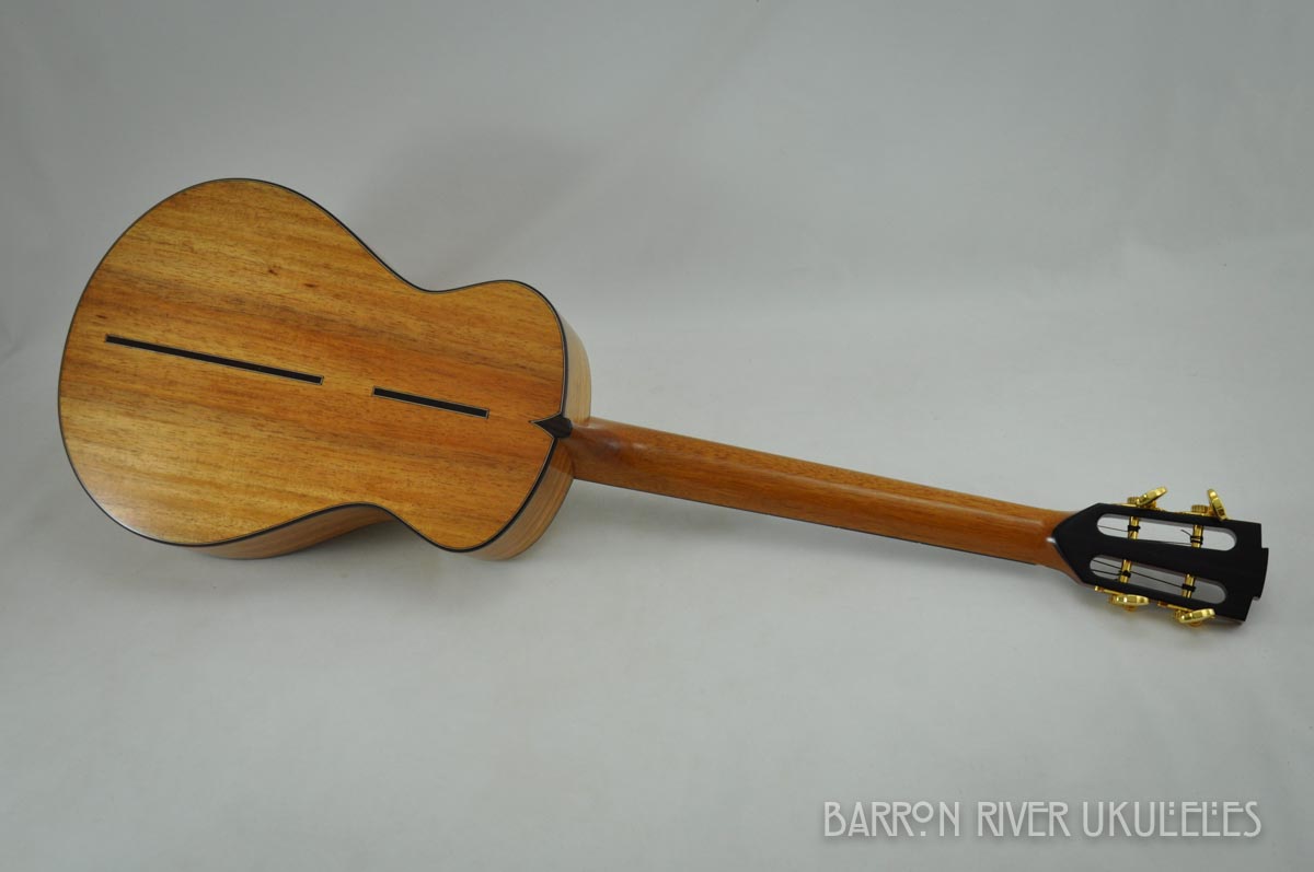

Here's something a little different for me. I've had this Huon Pine on the shelf since 2007 and finally got around to using it. What a fantastic smell it has, and that buttery color....I just love it.
Scale length at 22" to get some more tension on the strings for the deeper tuning on this instrument.
Body - Australian Blackwood
Soundboard - Huon Pine
Neck - Brazilian Mahogany
Rosette - Blackwood
All other trim - Indian Rosewood
Tuners - Grover
Finish - Semi Gloss Lacquer
Strings - Worth Brown Baritone DGbe
Rosette - Blackwood
Tuners - Grover

Stunning
Great to see what can be done with standard grade sets, who needs fiddleback with fine details like yours!
Did you add a truss rod/reinforcement of some kind with the longer neck?
Something to aspire too!
Steve.
Steve.
Re: Blackwood and Huon Pine Baritone
Thanks Steve.
There is some fine fiddleback in these sets, but you really do need to roll it around in the light to see it. But it was chosen because of the color that I thought would compliment that buttery Huon Pine soundboard.
No truss rod.
No truss rod.

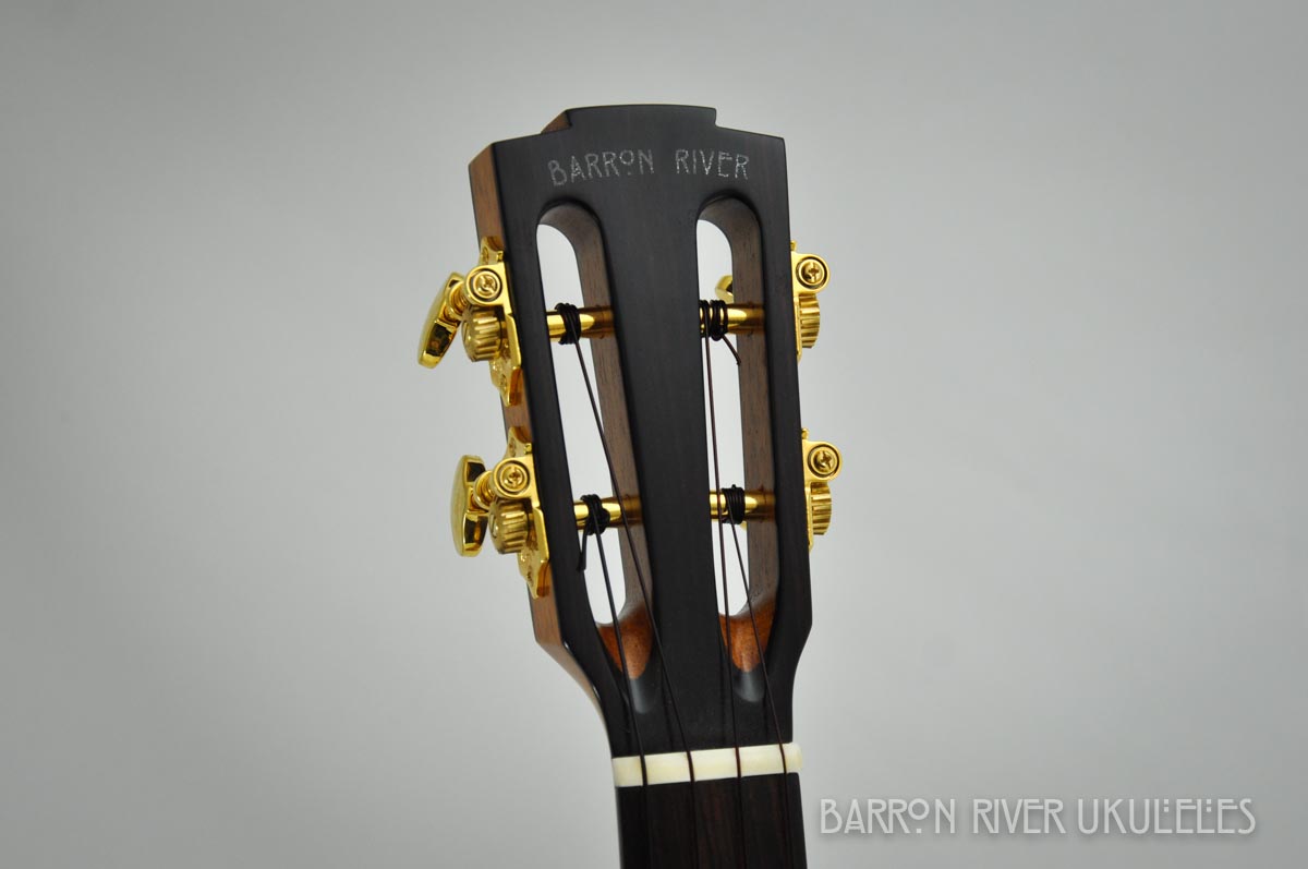

Really liking the headstock inlay Allen! It looks like you've sat there with a pin and hand engraved it, then filled that with pearl. Real neat.
Stu
Stu

This is a lovely looking Baritone. The Huon looks great - buttery as you describe it. I love Huon as a timber but have wondered how it sounds. I have never played an instrument with a Huon soundboard but have thought its "oily-ness" might dampen the soundboard acoustically. Obviously not as I don't think you would use it if that was the case.
I would love to take a flying visit to Cairns (if for no other reason than to escape Canberra - it's freezing here at the moment) to try this Baritone as I would love to actually hear how the low D sounds with the extra scale length. As we have discussed before, I am looking for a fuller low D in a Baritone. Since our last communication I have replaced my el-cheapo Tanglewood with a solid spruce top Cordoda Baritone which is better in the higher registers but still has a dull D. I am thinking I will put a re-entrant D on the Cordoba and learn to enjoy a more Uke sound while I plod away at making a Baritone myself which may or may not happen before I fall off the perch like the Monty Python parrot.
Looks great as always!

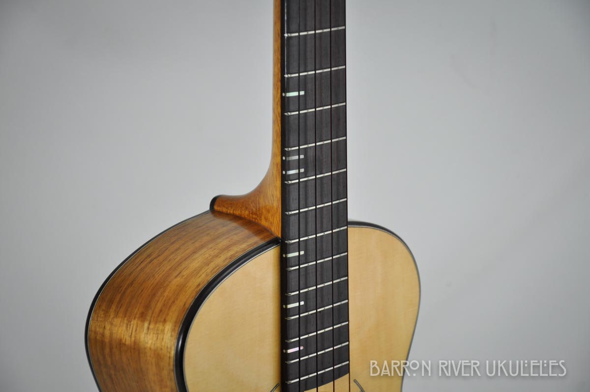

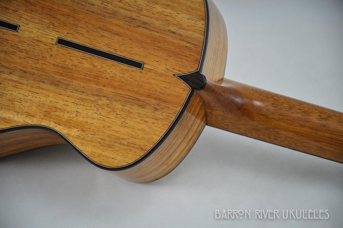

I showed a friend of mine the other day how you blend the heel cap into the body, he agreed it's a great look.

Ran out of superlatives to say about your Ukes Allen, so I'll just say I LOVE your slotted headstocks, just give the Uke that extra touch of class.
. Just don't inform the tax department.
Pssst, I'll let you in on a little secret Stu, Allen has a hareem of exotic nimble fingered Phillipino girls who live in a shed at the end of his garden that do this work for himneedsmorecowbell wrote: Really liking the headstock inlay Allen! It looks like you've sat there with a pin and hand engraved it, then filled that with pearl. Real neat.

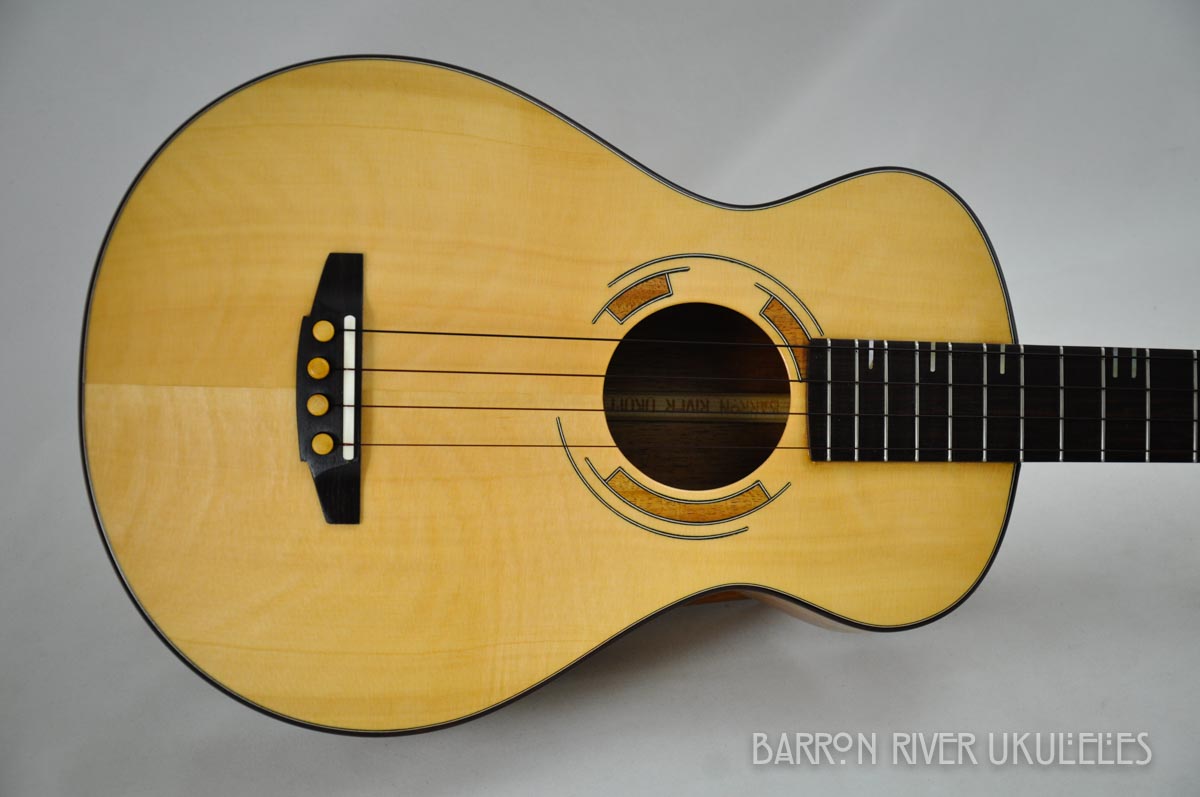

Another classy instrument. Another lucky owner. I like the way the broken line in the back mirrors the idea of the broken lines in the rosette.
Miguel
Miguel

If it's not a huge ask would it be possible to see a brief tutorial on how you do your partial rosettes. You obviously use a manual cutter (Michael OConnors tool?).
